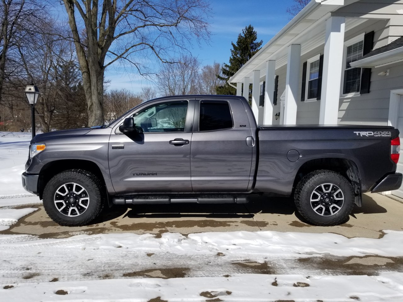

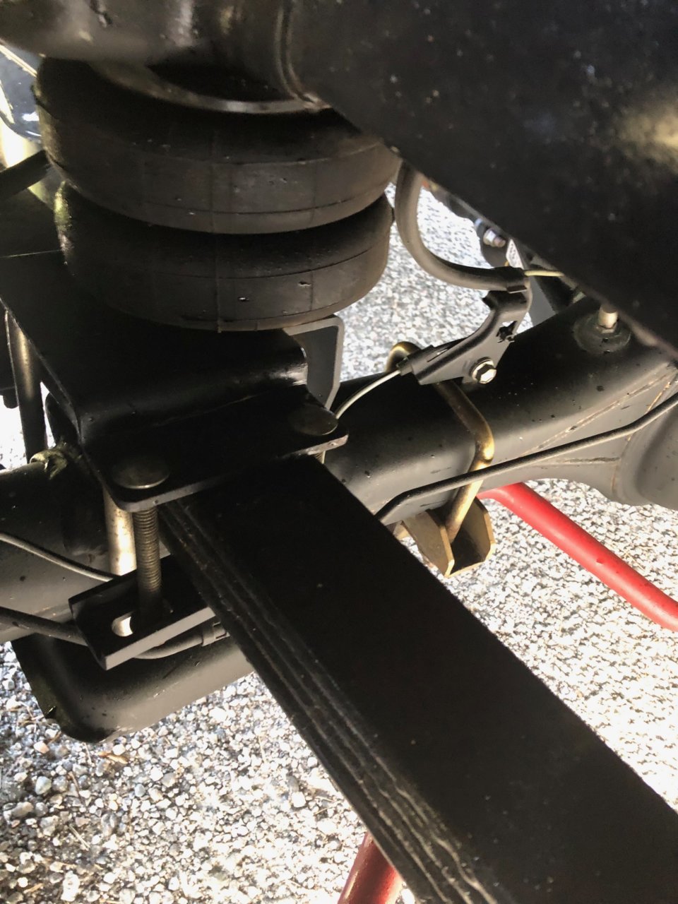

    I tow a 10,000 pound camper all over the place in the summer with my tundra. It has a 2" level in the front and load lifter 5000s airbags in the rear. I chose load lifter 5000 because of the internal jounce bumpers just in case the bags failed. Set up works great for me towing or not 20190308_132742.jpg

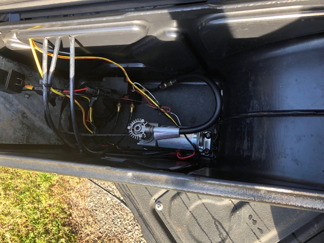

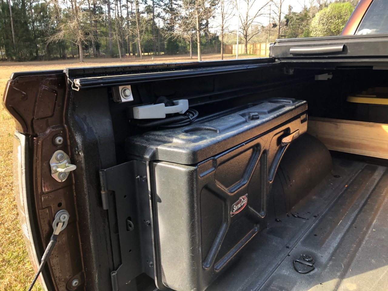

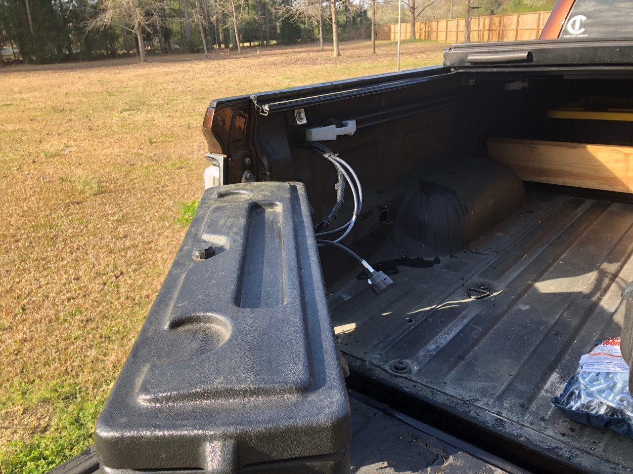

    I did the Firestone bags but wanted to monitor pressure to made sure I wasn't running flat. Added the Airlift wireless DUAL pump, thought long on placement. Decided on one of my swing cases, protected from the weather and easily removed if needed. I have a 31ft triple slide.

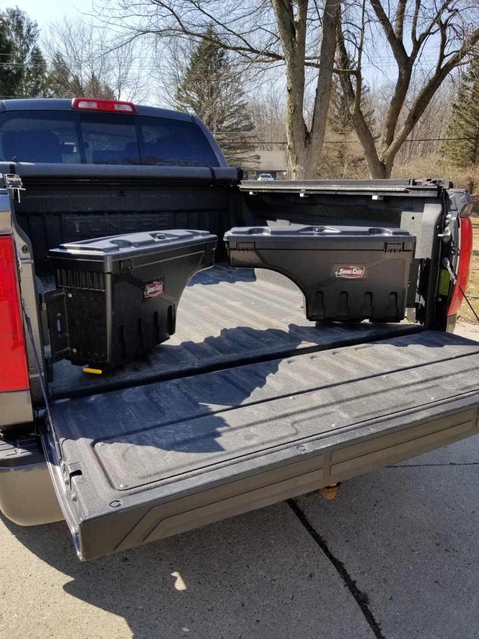

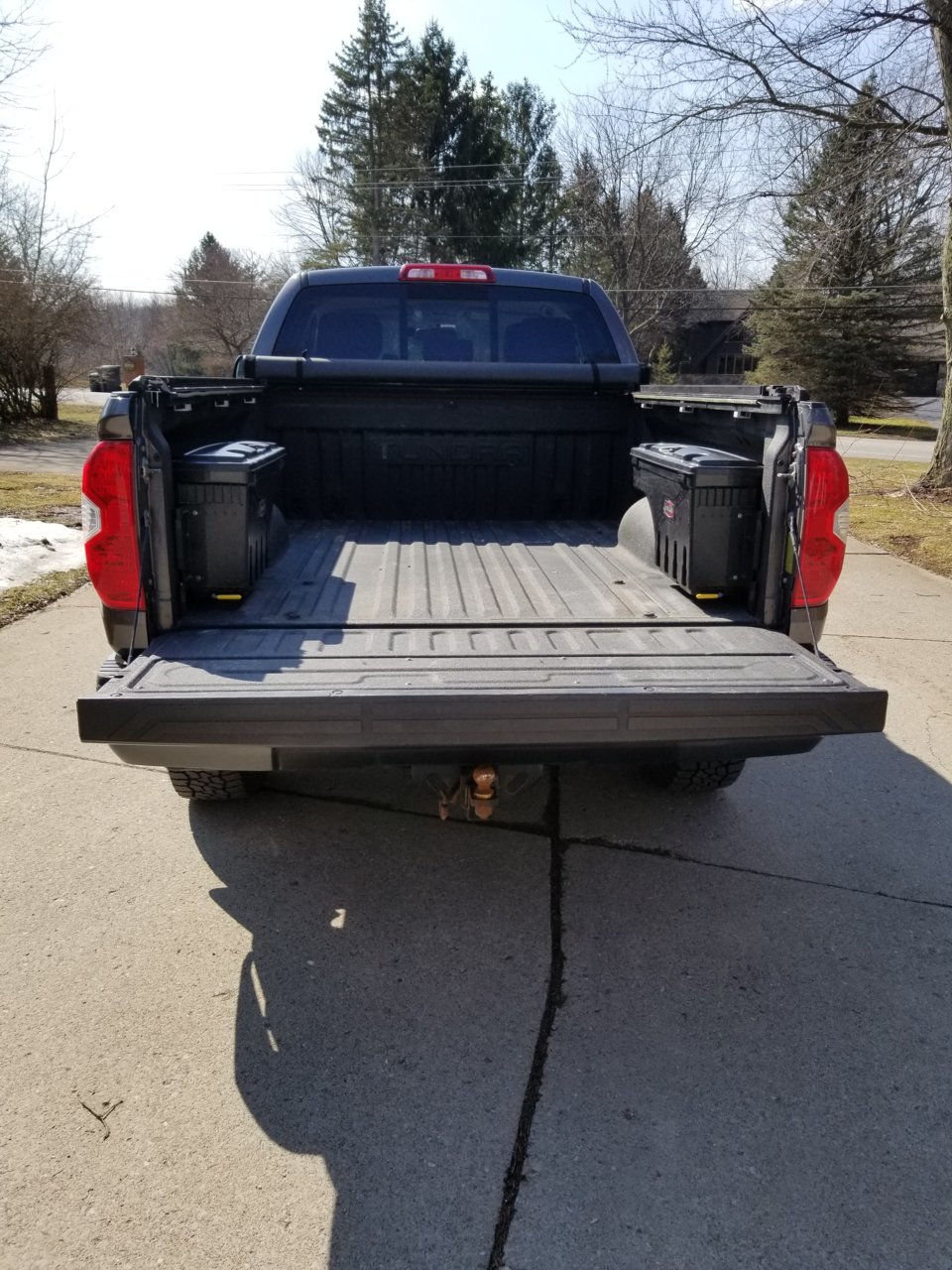

    Love the swing cases, wanted storage without a giant tool box hanging over the sides so I installed two swing cases 20190320_145008.jpg 20190320_144937.jpg
