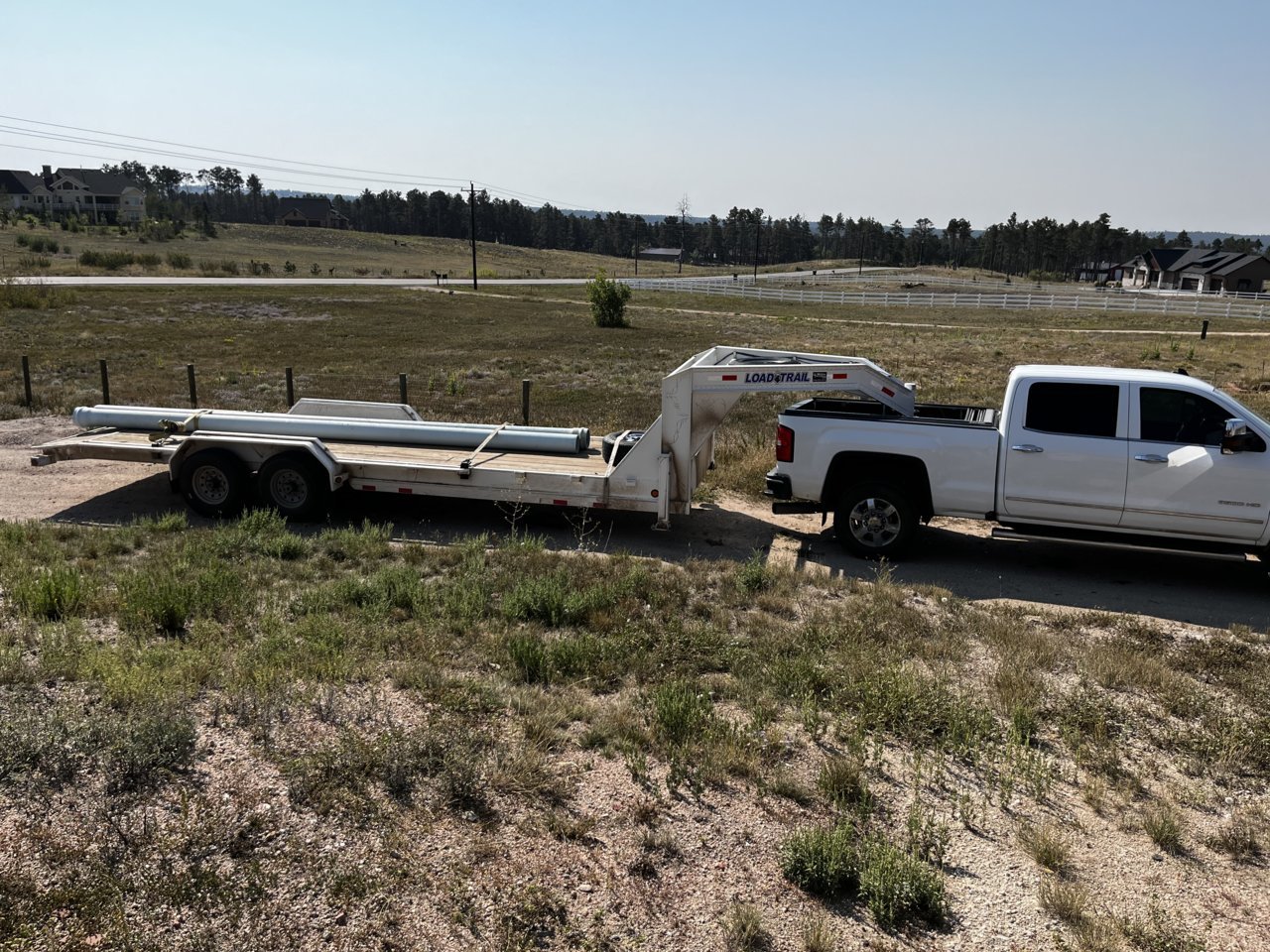

    Is there 5th wheel hitches out for the Tundra with the composite bed?
    This is empty and it moves my truck around a bit. Can't say I would want a lighter truck pulling this around. 4722AE01-7ECC-4E3E-BEE2-49212564AE45.jpg
