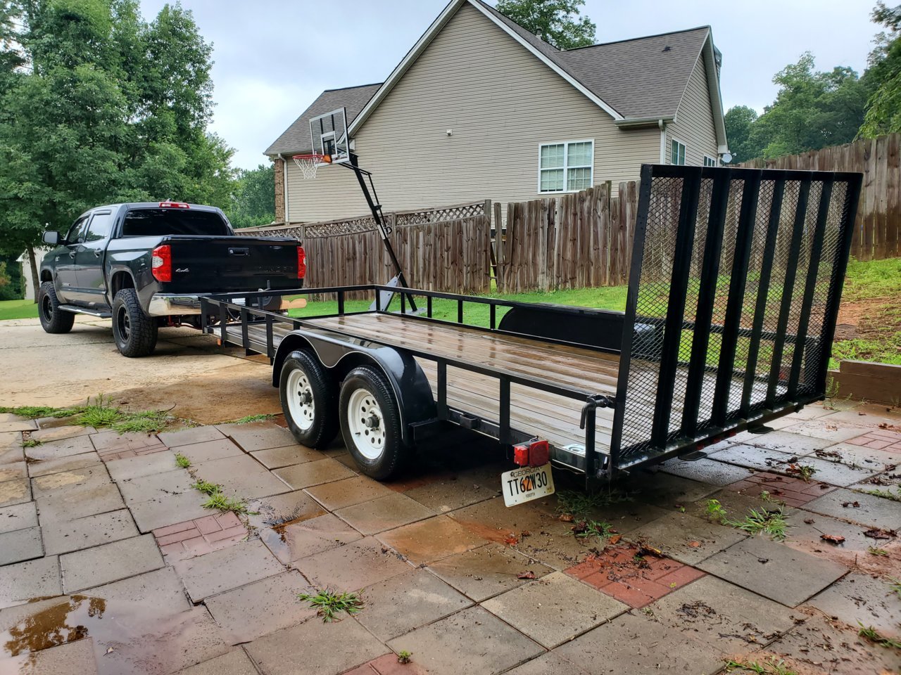

    I was dragging my 16ft landscape trailer around yesterday (1500lbs empty) and tried tow/haul out of curiosity.
    I think its way too froggy with tow/haul on.
    Honestly... you can barely tell the trailer is behind you without T/H anyway... and im even on 35" tires.
    I imagine its more usefull with trailers 4000lbs and up.
