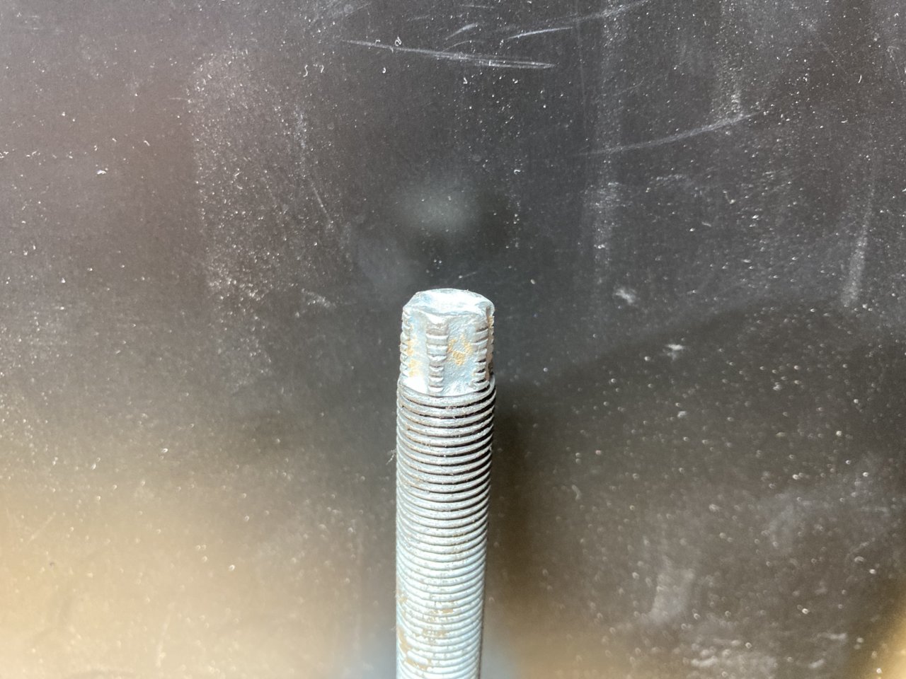

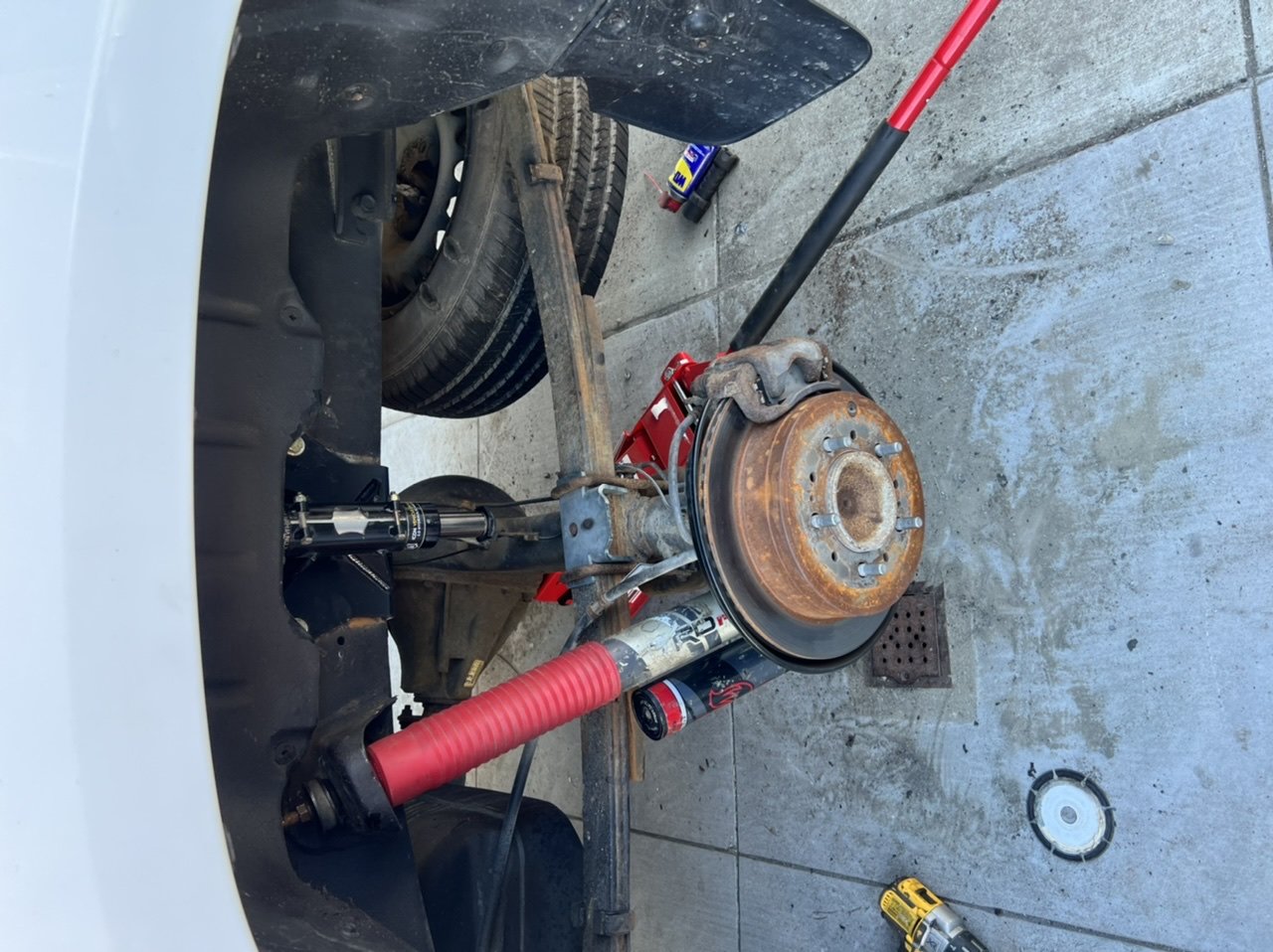

    So today, I was trying to install the trd pro rear sway bars. I tried to loosen the tow hitch bolt. They were seized and I was using my high impact torque wrench. After it finally loosened up abit, it snapped on me. There is like ½ of the bolt still inside the thread.
    how would I go about this. Which screw extractor do you recommend for that bolt size? It’s the 19mm bolt.
    I’ve never used screw extractor much, but assuming once I tap in the thread , would it have enough power to loosen it? My impact gun was struggling and it has 1100ft lb of bolt loosening.
    any suggestions would greatly help. Thanks

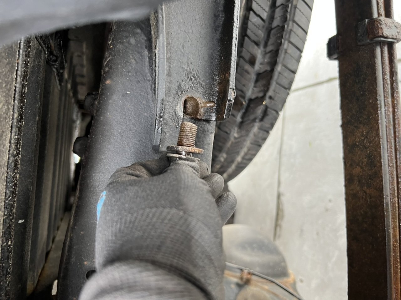

    I like this stuff:
    If I’m not mistaken, the end of the the bolt on the other side of the frame rail will look like this:
    If so, you have a better chance of getting locking pliers on it.

    Yeah the back side looks like that. I remove my passenger side fine , but the driver side was the one that broke off.
