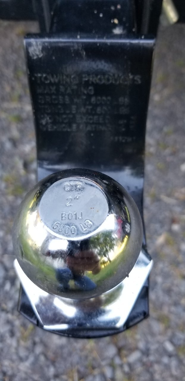

    I will be towing a Nissan xterra with a uhaul auto carrier. No wheels on the ground.
    They say I need a tow capacity of min 7000 pounds but I have to have a 2" ball.
    The ball is only rated at 6000 pounds and the hitch is only 6000 pounds as well.
    If I go up in size of the ball then the trailer wont fit.
    The truck weighs 4400 pounds and the trailer weighs at least a ton I would assume.
    How do they use a 2" ball with the weight?

    Get one with a bigger base that you bolt to the hitch with. That’s what I’m thinking? Don’t know what you are going to do about the hitch especially on a brand new vehicle?

    I see they sell 2 inch balls with different ratings. I guess I have to buy a new one.

    You'll just need a different ball mount and ball. There are 7500lb rated mounts and balls out there.
    https://www.etrailer.com/Hitch-Ball/Tow-Ready/63845.html
    https://www.etrailer.com/Ball-Mounts/Draw-Tite/2923.html

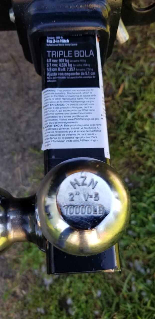

    Just got one that's rated at 10,000 pounds
