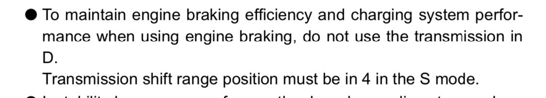

    The owners manual states you should put the transmission in S4... below is from my 2019 OM under the “Trailer Towing Tips” section:

    This is for downhill grades and to keep the battery charged.
