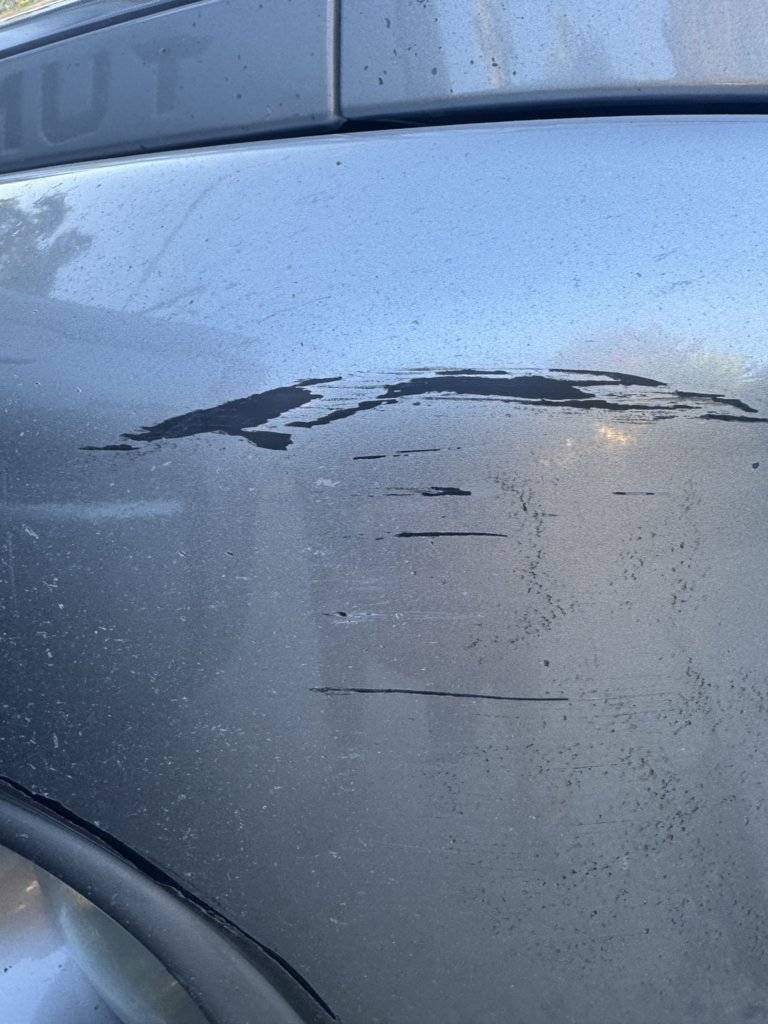

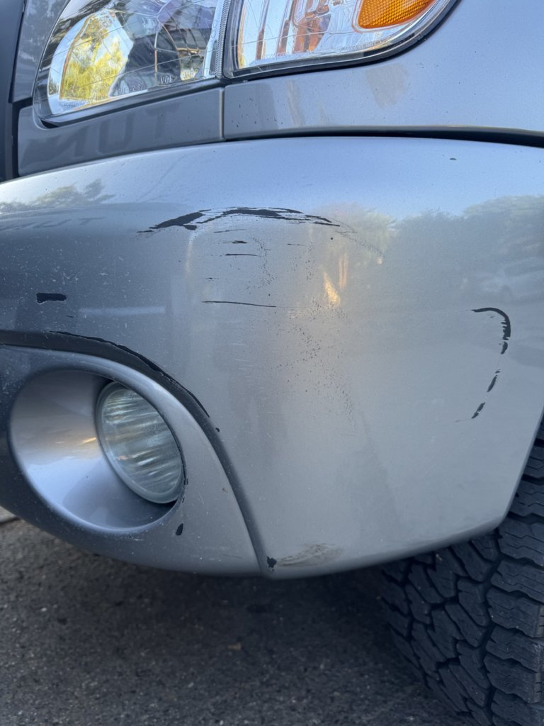

    Someone dinged the DS corner of my front bumper in a parking lot today. He found me and pointed out what he did. It's scratches, no dent of any kind.
    Has anyone done any touch-up work on their front bumper and have advice on best practices? I don't feel like taking this to a body shop. Would a good detail shop be able to clean up these scratches?

    As a former (Detailer), yes a good detail shop could get rid of the scratches, or blend them depending on if they are deep.
    You can tell dragging your nail slowly across the scratches, if it catches your nail then it's a deep scratch and will probably require a bit of wet sanding to blend it, if it doesn't then it'll buff out easy.
    You could also use some Goof Off from home depot to clean the paint from the other guy's bumper off yours then get a touch up paint pen from toyota. Their paint pen isn't perfect but it's decent for diy and only costs about $20.

    Sounds like they were nice enough to offer to compensate you for the damage?
    If that's the black paint transfer from the other vehicle it might just be removed and a good wet sand and polish might clean it up.
    But if yhat's the black plastic showing through it will likely best be solved with sanding, primer, wet sanding and paint. Can maybe fade it or just paint the whole bumper pretty easily.
    Could likely paint for $50-$100 in supplies including paint, reducer, etc. Some body shops can likely fix for under a deductible but spose others might quote over 1000 or double.

    They took it down to bare plastic. The bumper skin will need to be repainted...

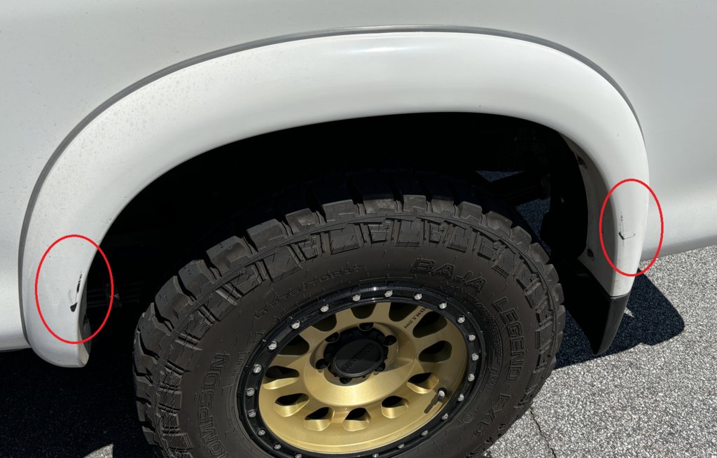

    Someone did this shit to me in a Trader Joes parking lot recently, an asshole in a black Dodge Caliber, and it scuffed my fender flare. Of course they took the fuck off without saying shit, and the two parking lot monitors standing 8 cars away "didn't see anything, and the camera isn't working", I'm still fucking pissed about it. Totally bullshit. I can't find the post I made about it, but this is the scrape damage - I can only hope it REALLY fucked their piece of shit Dodge up, and I hope the edge of my bumper grabbed and ripped shit off their vehicle:

    In my case, that is indeed the black bumper skin. The door trim from his Lexus sedan is what did the scraping work.

    Yeah, you can see the paint crumpled up at the left edge of a couple of the scrapes.
    Really, replacing or repainting the skin is your basic option. But I'd tag @Dakillacore who deals with this on a daily basis to give his 2¢.

    That is definitely down to the plastic and will need repainting. Detail shops don't paint bumpers and this won't buff out, as there is nothing to buff with the paint missing.
    Option 1: Buy a touch up paint pen from the Toyota parts department and color up. It won't look the best, and you'll still notice it but not as much as the black plastic underneath. This is the cheapest option.
    Option 2: Take the bumper off and have a shop sand down that area and repaint the entire panel. It's cheaper if you do the disassembly of the parts yourself. (NOT MAACO). You can't just paint this edge and make it look good. You'll have a noticeable paint line.
    Something like this would cost you around $800-1,000 in GA. CA has MUCH higher labor rates so maybe $1500.00.
