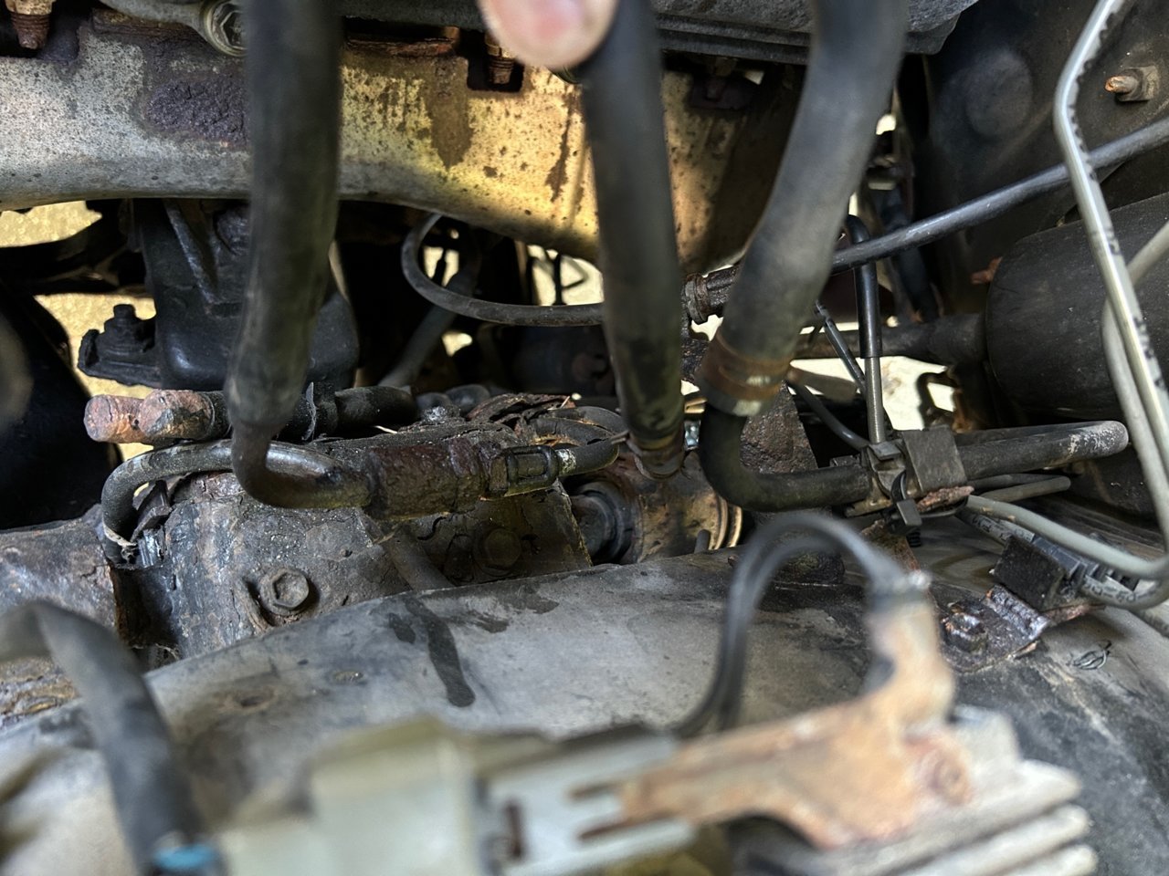

    OK, this is the line that failed (although the other line was not far behind). It runs from the ABS pump to the 90 degree connector.
    I think my summer project will be to inspect every inch of brake line, and replace anything that's even remotely sketchy!

    If that one let go, the ones for the back lines need to be checked very closely. They usually go first or are right behind that one

    Well, there’s your problem. The lines aren’t completely coated in vinyl exposing them to corrosion. Strange that mine are yet I don’t have ABS.

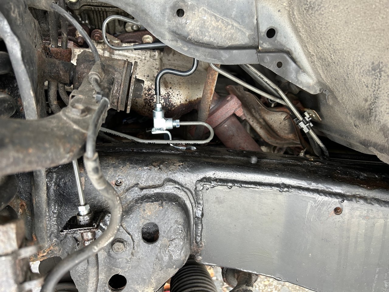

    Yay! I have lots of shiny new brake parts now. The problem should be solved (for now), at least for this corner. Hopefully I can check/replace the other corners at a more leisurely pace...

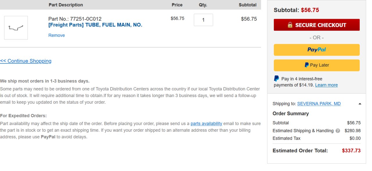

    McGeorge claims to be able to furnish both, but they won't ship the 77251-0C012 because it is too long...local pickup only. I'm checking with my local dealers now.
    I spent $100 on brake lines for the assurance that I'll be able stop any time I want...I'll gladly spend ~ $200 so that I don't burst into flames!

    @Jack McCarthy FYI I sourced the 77251-0C012 at my local dealer. $79.33 MSRP, but no shipping. The 23801-0F010 is on the way from McGeorge.

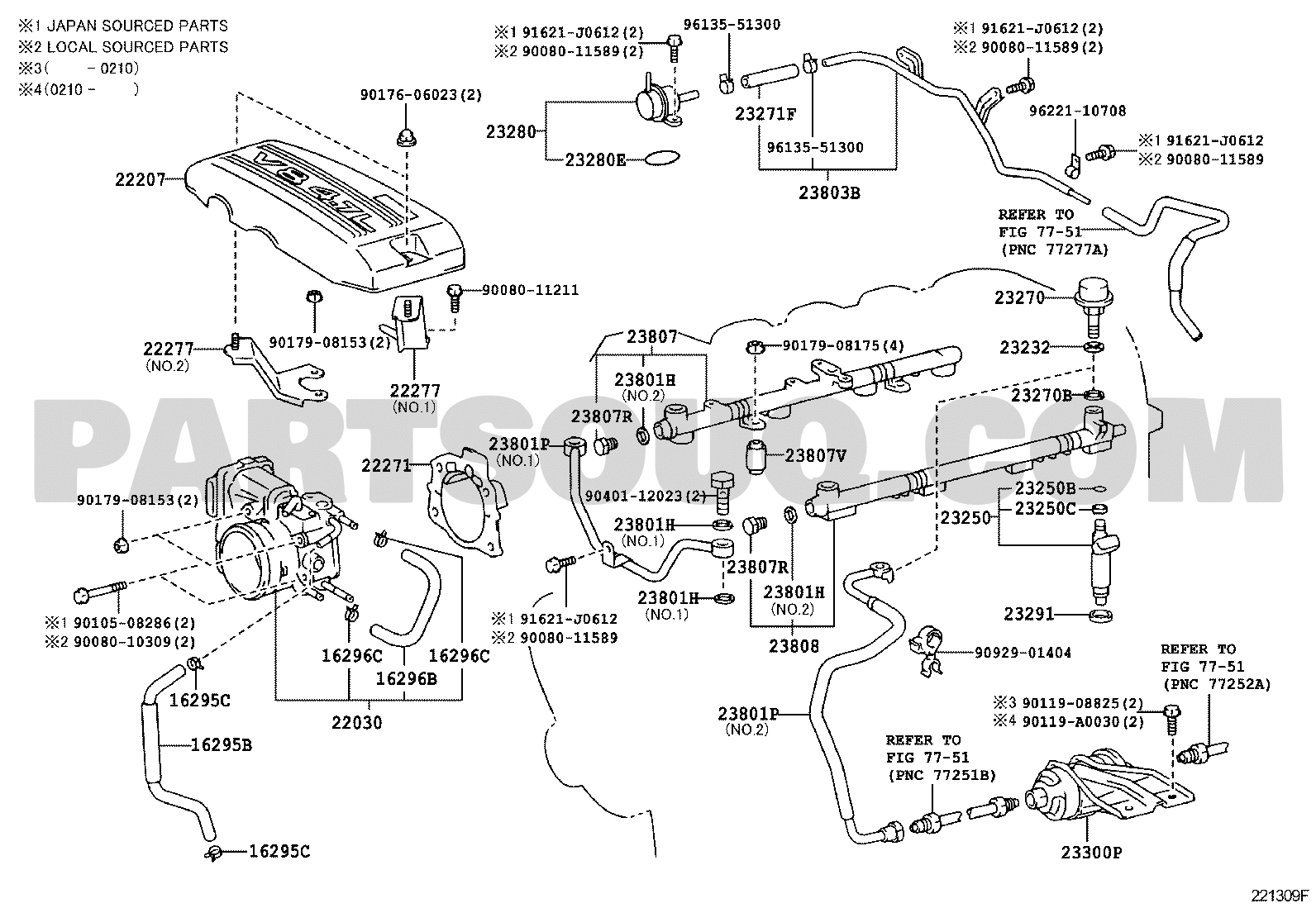

    Yeah, I see the 23801-0F010 listed at my local dealer. I thought I had a different part number originally though that showed discontinued. I show the following in the parts diagram referencing item 23801P which are:
    1. 23801-0F010
    2. 23801-50020
    3. 23801-50021
    All 3 state “pipe-sub assembly fuel, no. 1” for a description. I’m confused.

    Okay, I referenced the thread “under hood fuel leak” I originally commented within about the fuel hose and dealer told me part # 23801-50050 is all they have listed.

    @Jack McCarthy It may be different for 2002, but I don't know why it should be. The part that you had fabricated inelegantly is 77251-0C012 (Tube, Fuel Main), which fits Production Date: 08/2002-08/2004, Fitting Vehicle Options: UCK3#, 4#.
    The part you need (which runs front the fuel rail to the rusty connection by the frame) is 23801-0F010 (should fit your 2002 as well). ~ $50 + S&H @ McGeorge Toyota. (There are probably some washers for the banjo connection to the fuel rail, but I may have some laying around.) I have a new OEM fuel filter which I've never installed because @Shifty told me I didn't need to .~ (.~ is the "snark mark"). When I get around to opening the fuel line (hopefully before it opens itself!) I'll install it as well.
