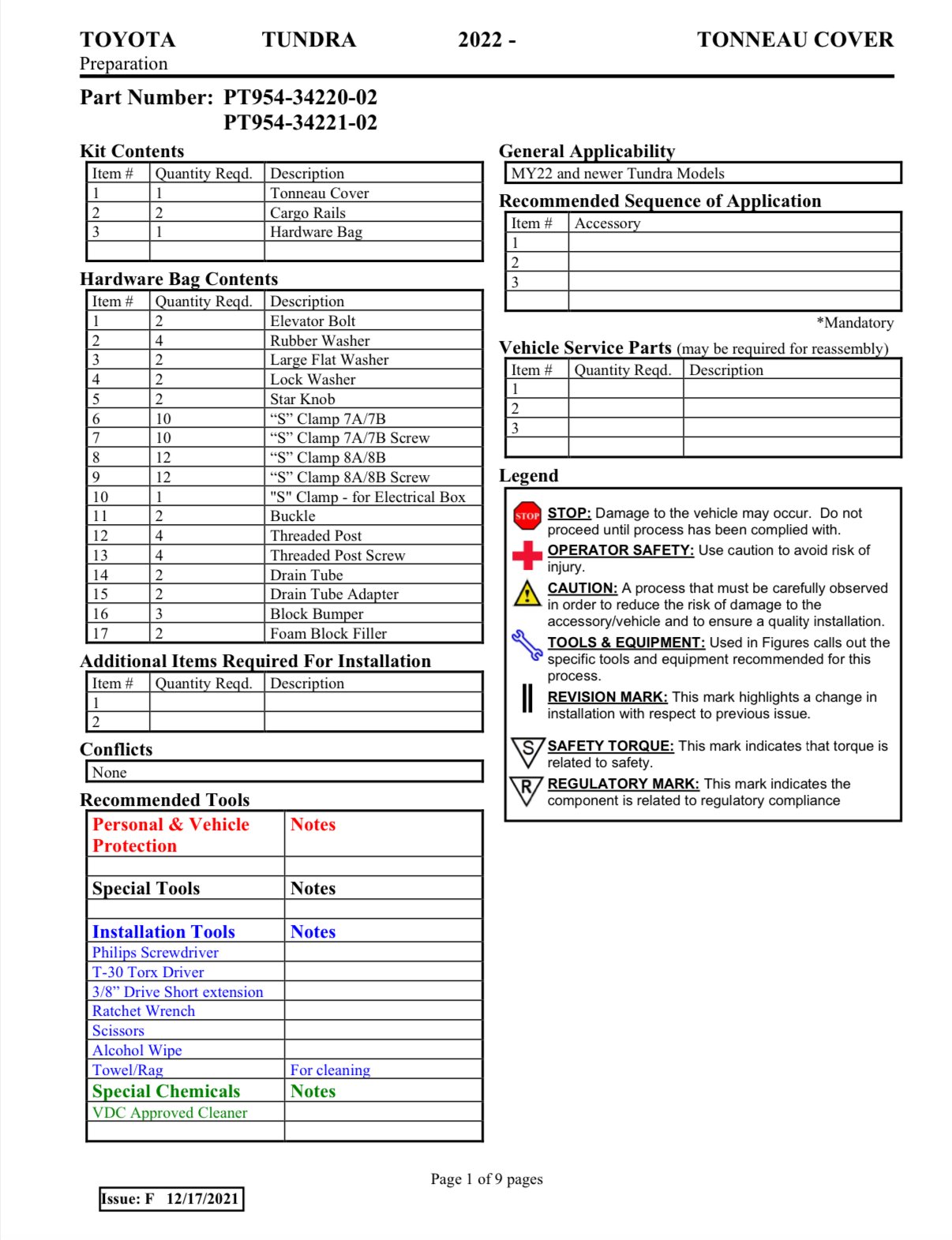

    T25 is way too small, and that's the biggest torx bit I have. The question I'm asking is not about the tie downs, but the rail that runs along the top of the bed. Is it a T30?

    Did mine awhile ago. Believe it’s T30. It shows T30 torx driver needed tool in OEM Tonneau cover install instruction. I snapped my Snap on torx bit from using Milwaukee impact driver with 4.0A battery. :rofl:

    I just checked mine. It's a T30. Note that I have a Bakflip MX4, IDK if that makes a difference.

    Recently installed a bed cover. I used a T30 to remove & reposition the bed rails during installation.

    My Tacoma is T30, pretty sure Tundra is the same hardware.

    100% a T30. I've taken my rails on/off several times at this point.
