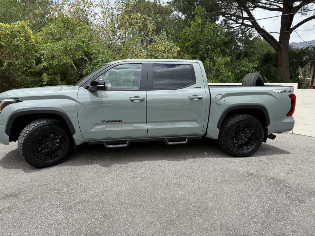

    2025 Limited Crew Max 4x4

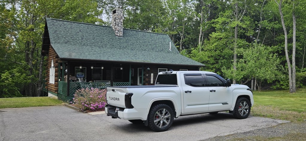

    I ran Toyo Open Country AT3s on my 2014 Sequoia and they were fantastic in the rain and snow. Solid choice.
    On my 2025 Tundra I’m running BFG KO3 in 285/60r20 and the size looks perfect IMHO.

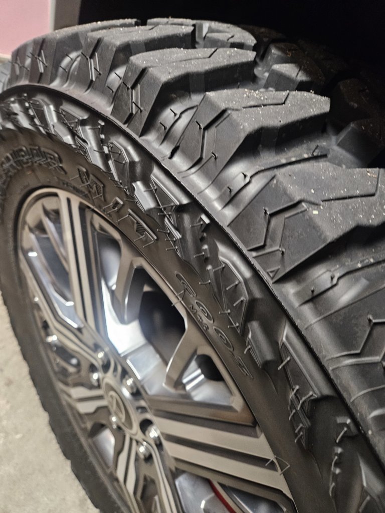

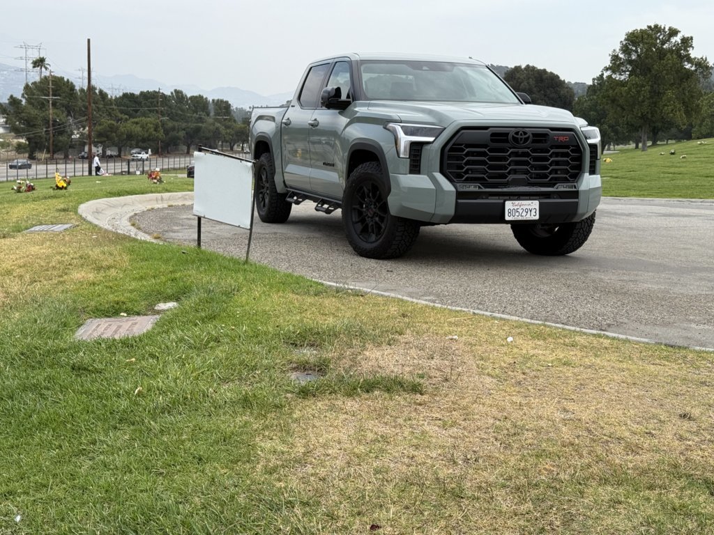

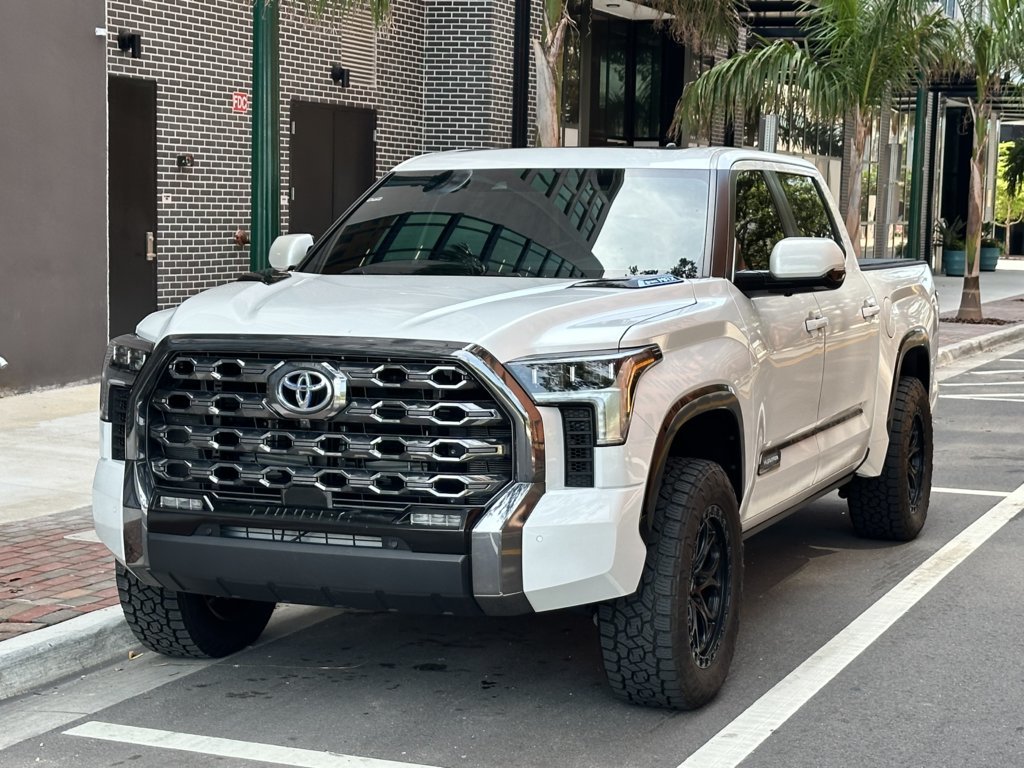

    Here is mine I just posted actually. 285/65/20. Wildpeak at4w. They’re actually run bigger than 35/11.5 on the Toyo or k03. Bone stock, so I’m sure you’ll be fine.

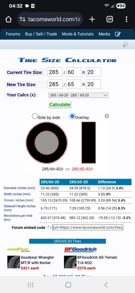

    285-60 has an over all diameter of 33.46 inches, weight 55ish pounds
    285-65 overall diameter is 34.59, 65ish pounds
    You'll lose speed, fuel economy, and increase brake wear, and put more load on the suspension. Things will wear out faster with the bigger tires.

    If you want to size up tires use a calculator tacomaworld has one,it'll show you with an overlay to visualize "old ~ new".
    BF Goodrich runs a little smaller than most MFG'S but is a great tire,I'm not sure what your running now for stock but here are the two you are considering, and either way I don't think you'll have any rubbing.
    I too live in New England I swapped out my stock rubber bands for more side wall and wanted to fill the wheel well gap with something more suitable for our weather,I went with Geolanders M/T G003 @ 285/55R22 (34.34"X11.5") they have been great for the past 2 winters and are exceptionally great in snow and really shine in the sand when hitting the National Sea shore 4x4 beaches.

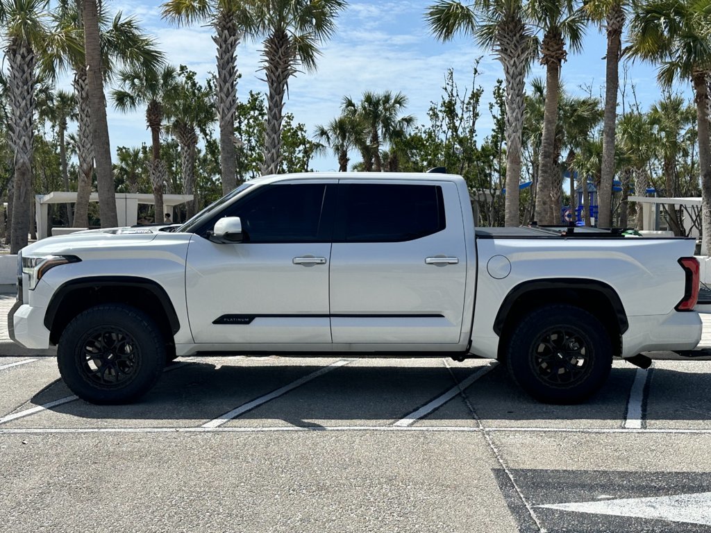

    Weld 20x9, Toyo 285/60, RC N3 level, ceramic tint

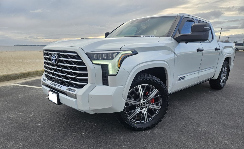

    285/60R20 Toyo OC AT3 in SL here... each tire weighs 48lbs. This is one of the biggest tire sizes you can get in SL to keep the weight down.
    Also have Weld 20x9 +20 wheels for a little poke and 2" leveling struts. I think the look is perfect and the ride is still smooth as stock.

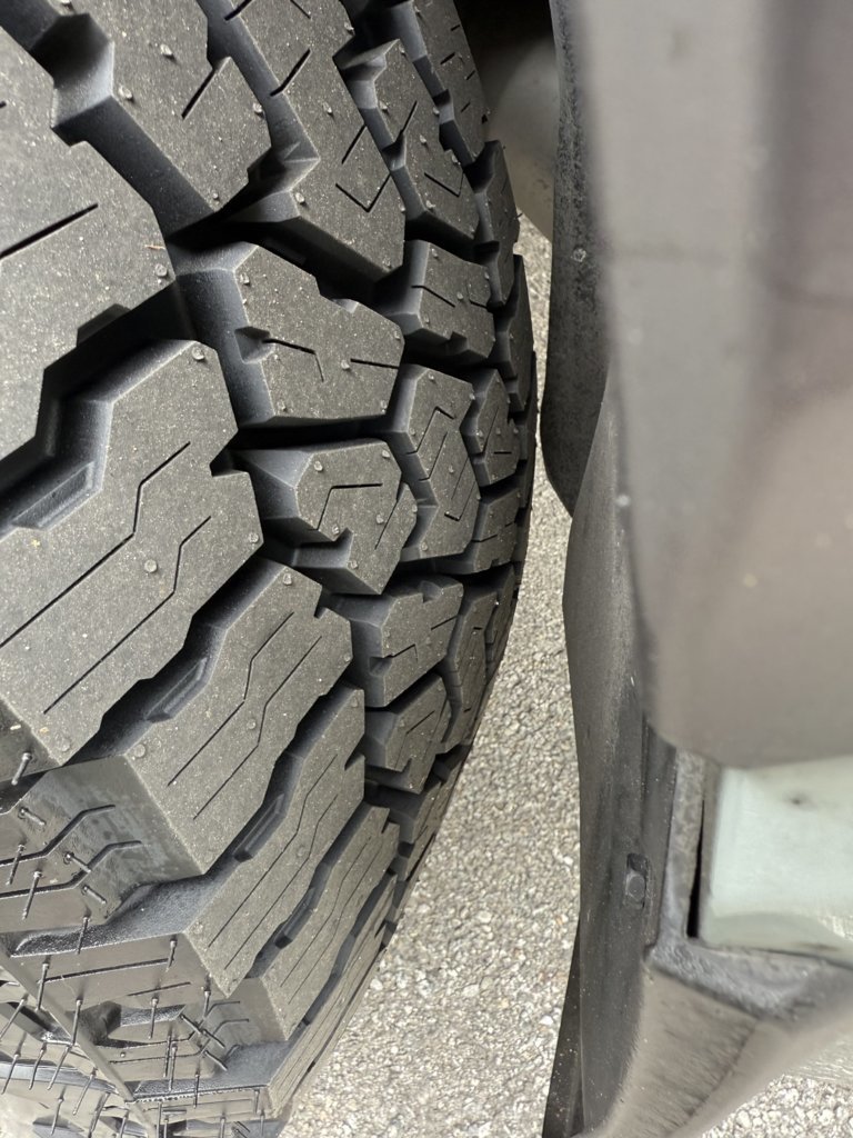

    I do not it’s close but no rub. Fills it out nicely. Yes, they are heavy tires but let’s not act like the stock tires were appropriate for this truck.
    Mine were significantly worn down after 11k miles, I probably would’ve got 20k out of them but I hate driving on worn out tires.
    You will loose mpg of course with bigger tires but it’s a truck so. As far as power goes, truck has plenty of power I don’t feel much difference.

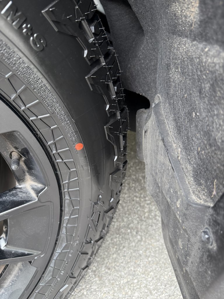

    Totally stock suspension for the time being. Fit is tight but zero rubbing anywhere including the mud flaps.

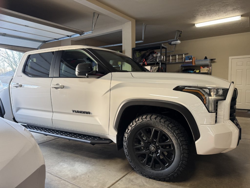

    Maybe so and it's the dealer salesman who told you this,he could be conservative and didn't want to put his ass on line if he's not accurate.
    I know that there are some here who have put 35's on and no issues.
    My truck is 100% stock suspension and rims and I have zero rubbing at full lock either direction and with aftermarket mud flappers.
