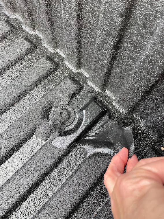

    First time poster and owner of a 22 Tundra <24 hours.
    I picked up 3 2x4's from Lowes last night. Thought I was being very careful. Even wrapped the boards in a towel where they rested on the tailgate. New truck babying. Looked in my bed though this morning and a quarter size piece of the factory bed liner was torn off. (See photo) I tugged on it some and frankly to me there are adhesion issues between the spray liner and the bed.
    Any advice or experiences on this before I go back to the dealer?

    Sorry this happened. I'd take it to the dealer and ask them to fix it. My 2010 CM had Line-X that was 99% perfect at 9 years and 190k

    My only advice is, take it back right away while the liner still looks clean and new, so it’s clearly a poor installation, not abuse by you.

    As already said, take it back. If one spot came off then I would worry about the rest of the liner being a problem as well.

    Yup take it back at one point they were having adhesion issues and were not going to put bedliners in. There are a couple posts about it somewhere in here??

    As everyone else has said, take it back. I've had 3 Line-X installs in the past, and then the current factory spray-in bedliner on my '20 Tundra...and all were and are flawless, and that's abusing the @$%@ out of them. Obviously manufacturer/installer defect.

    As others have said that is definitely an adhesion issue. You should be able to slide a 2x4 on the liner and have a nicely sanded end on your 2x4 not a screwed up truck.
    Also, That looks thin AF, you deserve a 2nd coat

    There was a time during production where they halted bed lining because they were having adhering problems. Dealer should do something.

    The spray-in liner is fully warrantied. I've already beaten mine up with 5 full bed loads of various garbage to the dump. No issues with my liner.
    You shouldn't have to baby it. I don't. If it tears...take it to the dealer for a repair. It's an easy fix. They'll scrap it back to remove any loose liner, apply adhesion promoter, and apply a spot patch. It's pretty much the same procedure for small repairs at any Rhino or LineX shop.

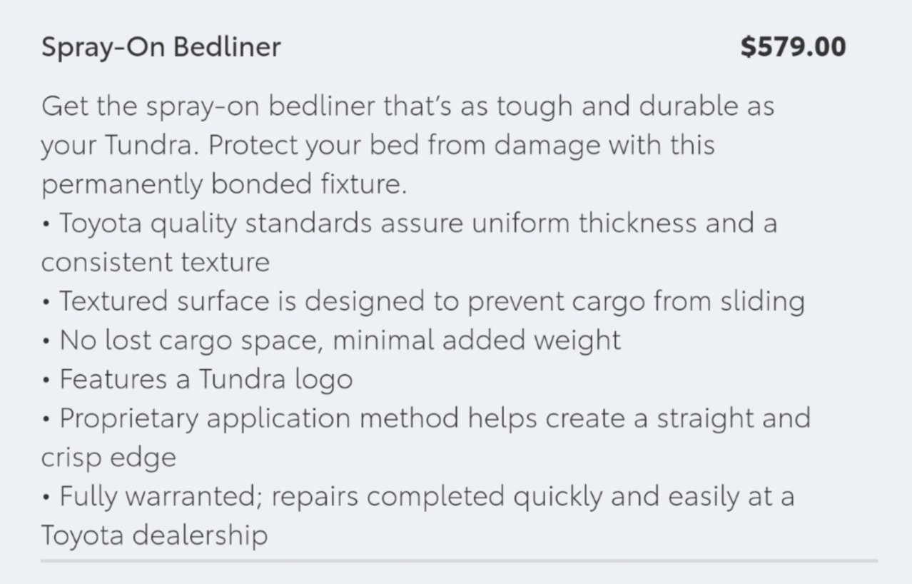

    Sorry to see this. Recommend you remind them of the Toyota advertisement showing them dumping stuff from a Front end loader into the bed showing everyone how tough it is. It's a huge PIA but am sure they will fix it

    I seem to remember a line item maybe on the factory MSRP sheet about the warranty on the bed liner, seemed like it stated backed by Toyota and the dealer. I'm sure they will stand behind it and repair.

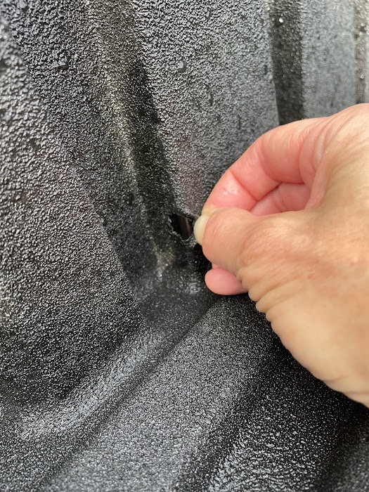

    I have a 1 week old tundra with the same thing! I’ve had a stroller in the bed and I think a cooler once. Super cautious!
    it’s quarter sized, but looks like it could easily peel to can sized.
    I just found it, going to call the dealer on Monday.
