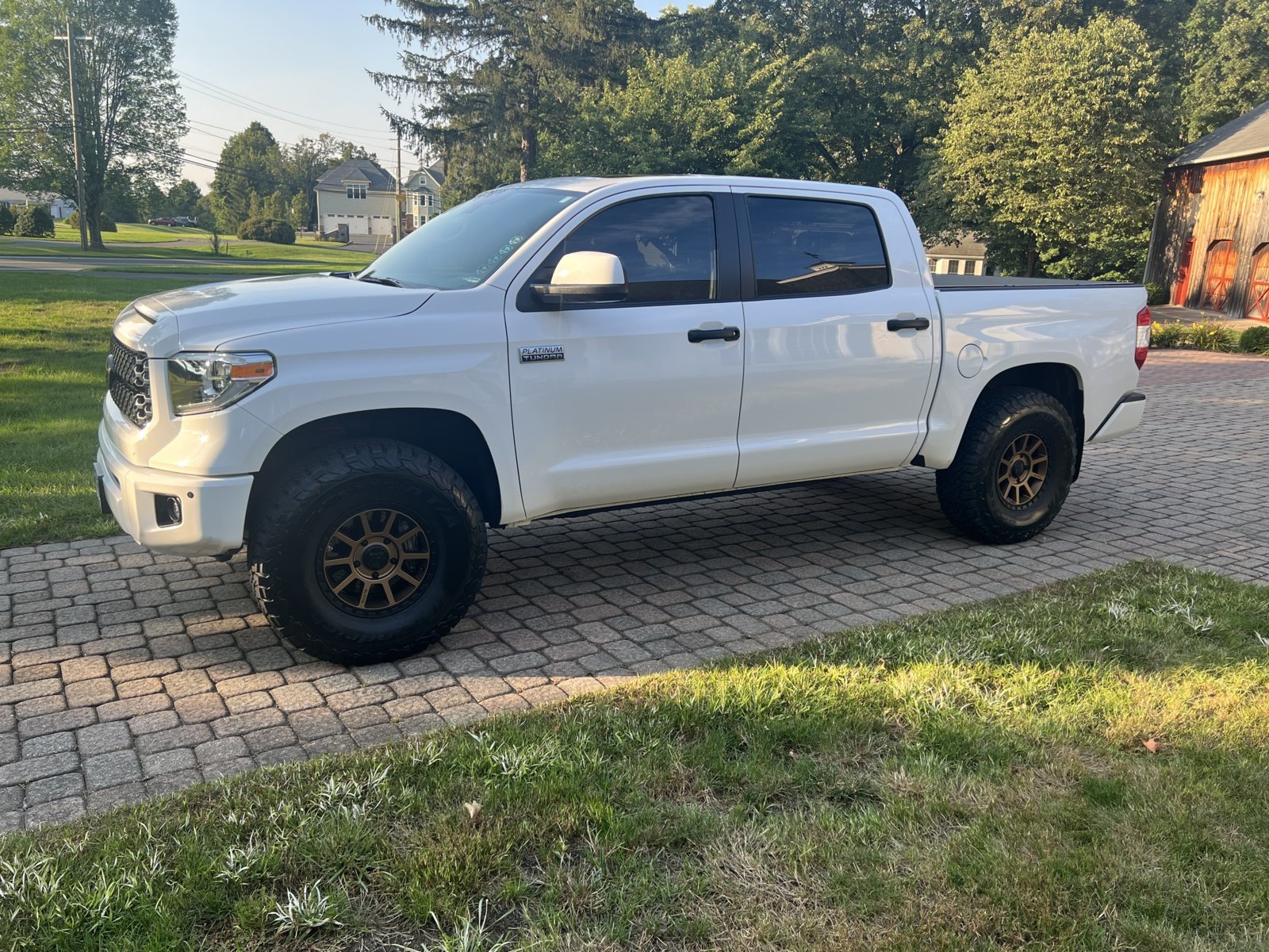

    I hit some small whoops once in a while and it rode great. Here's a pic for stance. On 37's.

    Now it worked. Good looking truck
