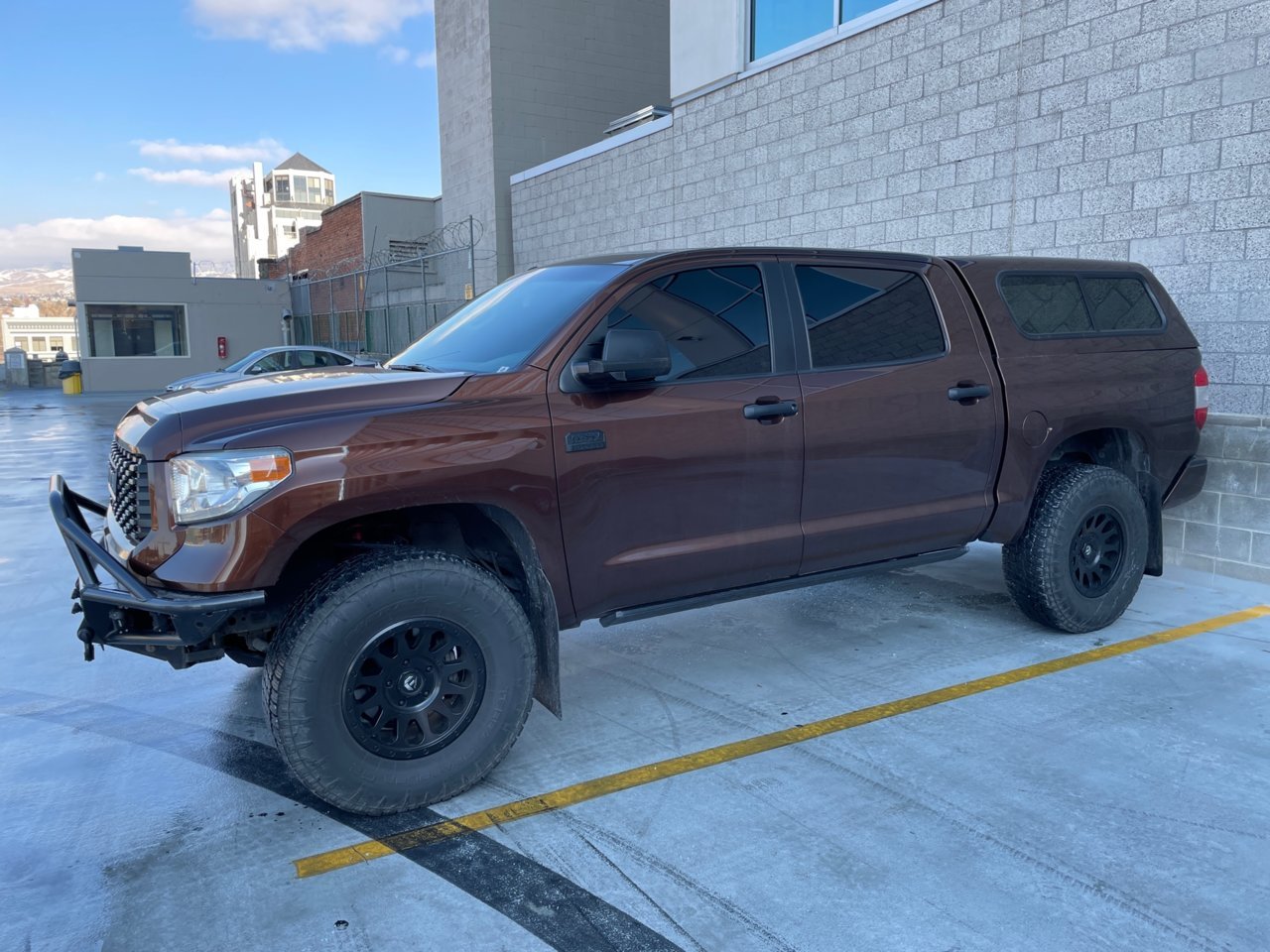

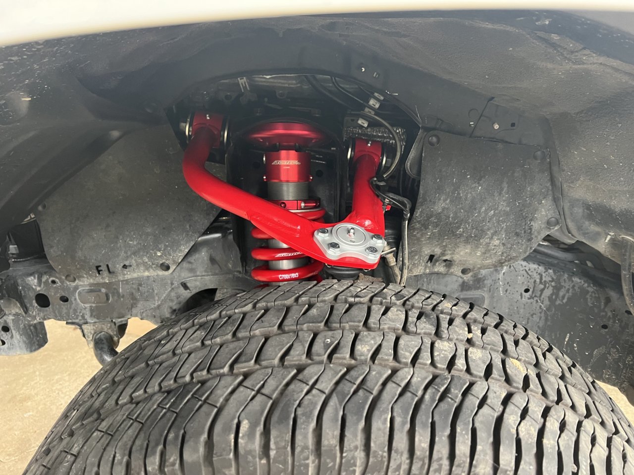

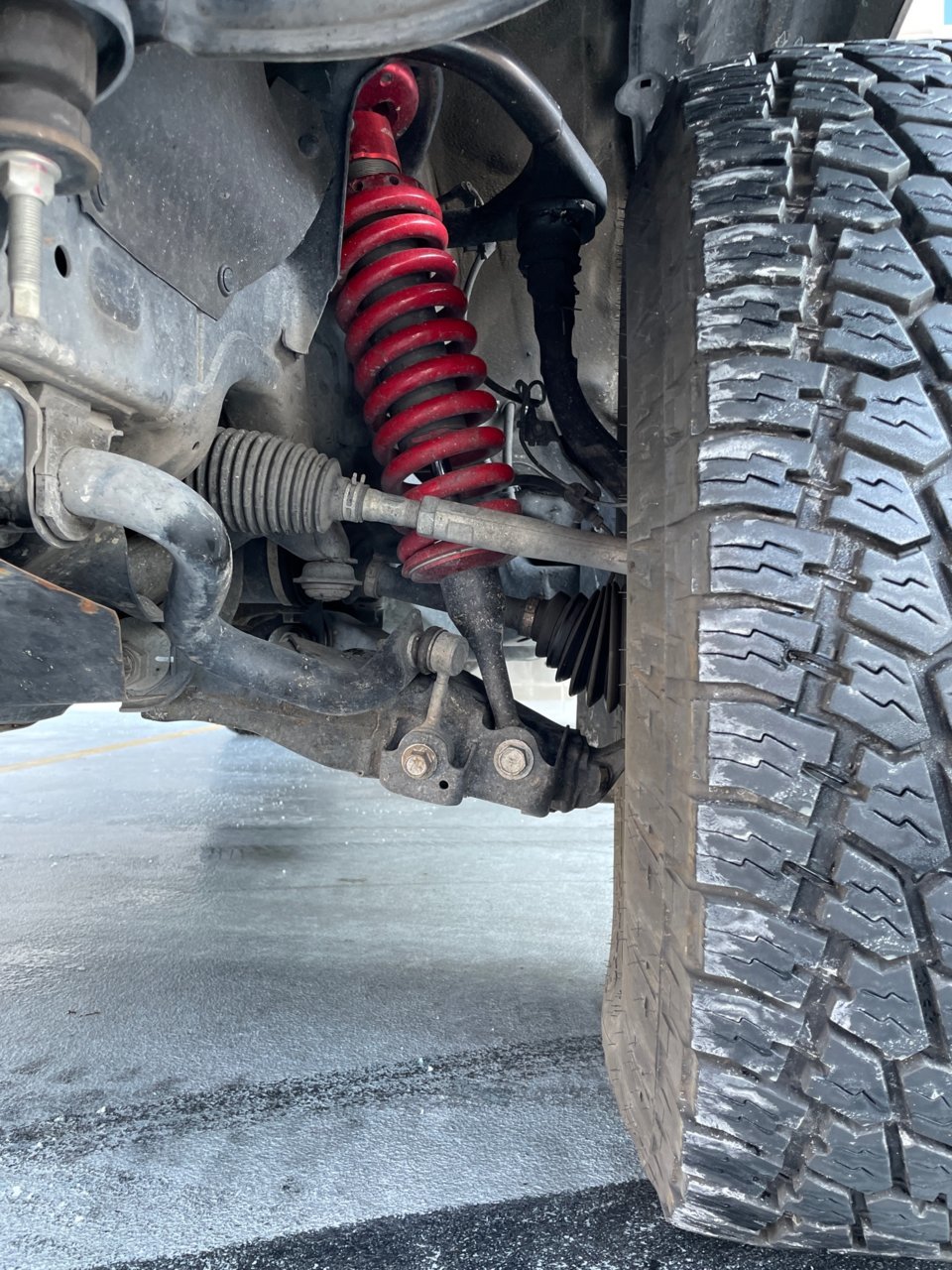

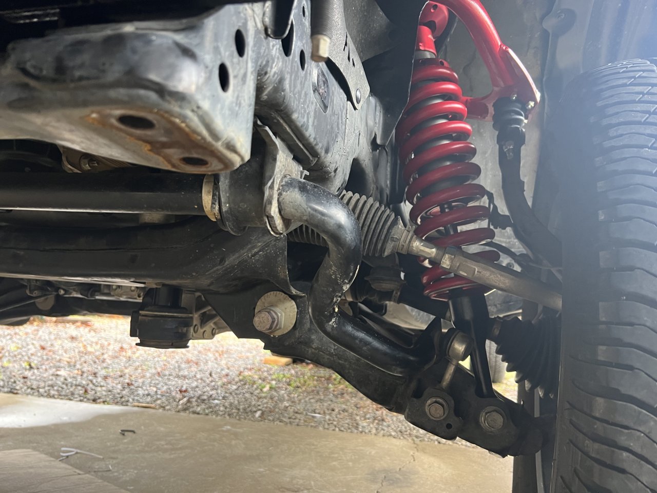

    I just got around to starting a laundry list of upgrades to my truck and I neglected to take pre measurements. After installing the front suspension(coil overs ucas .25 shim for lean diff drop) and a steel bumper with a warne 12k winch I’m setting at 26.5in on each side. The angles seem too drastic for what should be a 3.5in lift at max. I haven’t adjusted coil overs yet as I’m waiting to do rear. In hindsight i torqued cam bolts back from loosening them without it on the ground. Would that be my issue possibly? 18AF122D-0D07-412A-9922-DA126E1E0C64.jpg AEAC3191-F33E-42B9-9DBA-DBF67EC4A225.jpg

    Your issue should be resolved once you adjust those coil overs. Lots of room left to go lower(at least an inch it looks like).

    for reference I did an exactly 2 inch lift in the front with eibach coilovers and my cv angles look totally fine, I measured about a 5 degree increase versus stock height of 1 or 2 degrees. You can prolly go to about 2.5 with the diff drop and still have the boot ribs not touch each other.
    I have an SR5 4x4 and I measured the stock height from center of the wheel to the fender well top and it was 21.5 in the front and 24 inch in the rear. That was with brand new non sagging suspension. Now I am at 23.5 in the front and 26.5 in the rear.
    If you are at 26.5 in the front then you got 5 inches of lift assuming you didnt have stock sagging suspension in the first place.

    Are those the 2.5 Alumas? Thats the exact same setup I have. If I recall, the instructions say that you should not see more than 1" worth of threads above the adjustment collar. I have mine set at about 1" of threads and everything is fine.
    All that said, I dont think I understand your question. What do you mean 26.5"?

    26.5in fender to hub measurement.

    No sag, truck is newer. I was almost certain I was at 22.5 when I measured a few months back. 2021 sr5, but still wouldn’t expect that lift with that much weight on the front end. I just want to dial it in to 3 to match rear icon rtx springs.

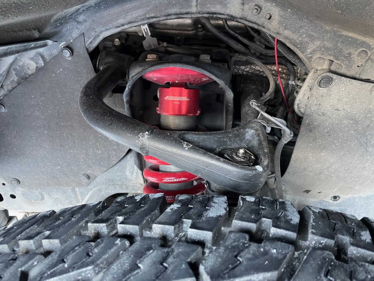

    Question, what are the UCAs that you are using and did you paint those yourself or they came from factory like that? I only ask because it looks like it a textured paint similar to a bed liner or maybe its because they are dirty at the moment or I'm blind. lol

    Those are the SPC's and they come powdercoated.

    Thanks man. Yeah, they are SPCs and come painted that way.

    you have the diff drop installed or no? I'm about to bump my lift to get me to 25.5" as well, but took off my diff drop awhile back, do you know what your CV angles are? I think mine were at like ~10 degrees the last time I checked, which honestly seems like a lot to me
