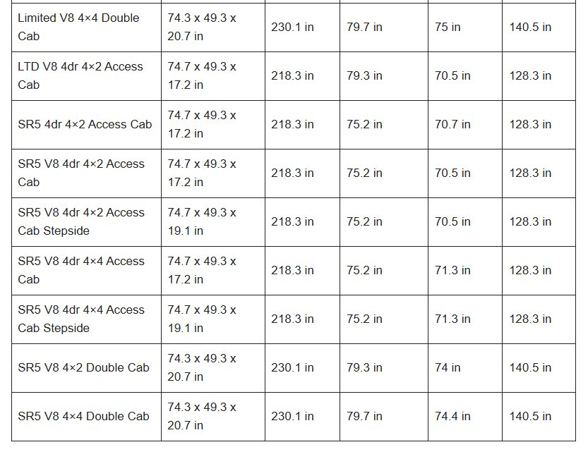

  10. Jan 27, 2025 at 10:16 AM
    Fragman
    Fragman New Member
    Nov 28, 2024
    #126540
    178
    TX
    2006 Tundra DC SR5 2WD V8
    I've seen the figures of 74.7" for the AC and 74.3" for the DC in several places, which is less than a half inch difference.

  13. Jan 27, 2025 at 10:35 AM
    Methodical
    Methodical [OP] New Member
    May 28, 2020
    #47227
    138
    Maryland
    2006 Tundra SR5 DC TRD 4x4
    See my other responses below.

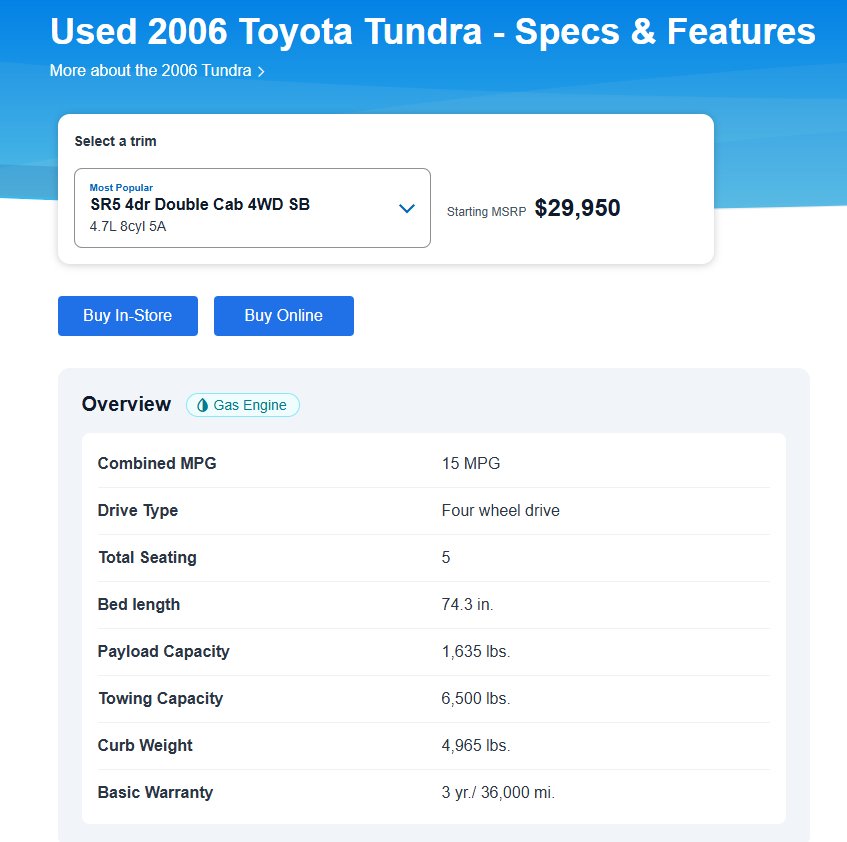

  14. Jan 27, 2025 at 10:36 AM
    1lowlife
    May 4, 2016
    #3296
    10,665
    DADA
    THE GREAT STATE OF TEXAS
    2014 MGM DC SR5
    What I found as well.
    2006 Toyota Tundra Bed Sizes (with Charts)

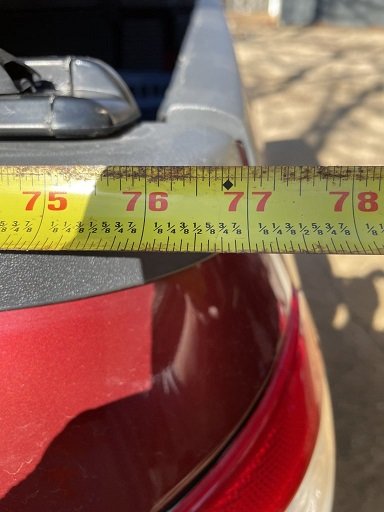

  15. Jan 27, 2025 at 10:44 AM
    BubbaW
    Aug 19, 2019
    #34845
    3,768
    Bubba
    Where Eagles Nest
    04 DC LTD 4X4 4.7 V8
    T150 Lover
    Might wanta try entering again because it’s not in your signature nor your profile.
    Never mind....TBM set me straight :)
    If it helps, my bed length for 04 DC LTD….77” and excepts an ARE topper very well.

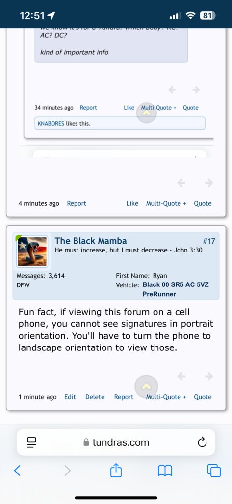

  16. Jan 27, 2025 at 10:50 AM
    The Black Mamba
    The Black Mamba He must increase, but I must decrease - John 3:30
    Sep 6, 2023
    #103472
    4,155
    Ryan
    DFW
    Black 00 SR5 AC 5VZ PreRunner
    Imma keep it stock
    Fun fact, if viewing this forum on a cell phone, you cannot see signatures in portrait orientation. You'll have to turn the phone to landscape orientation to view those.
