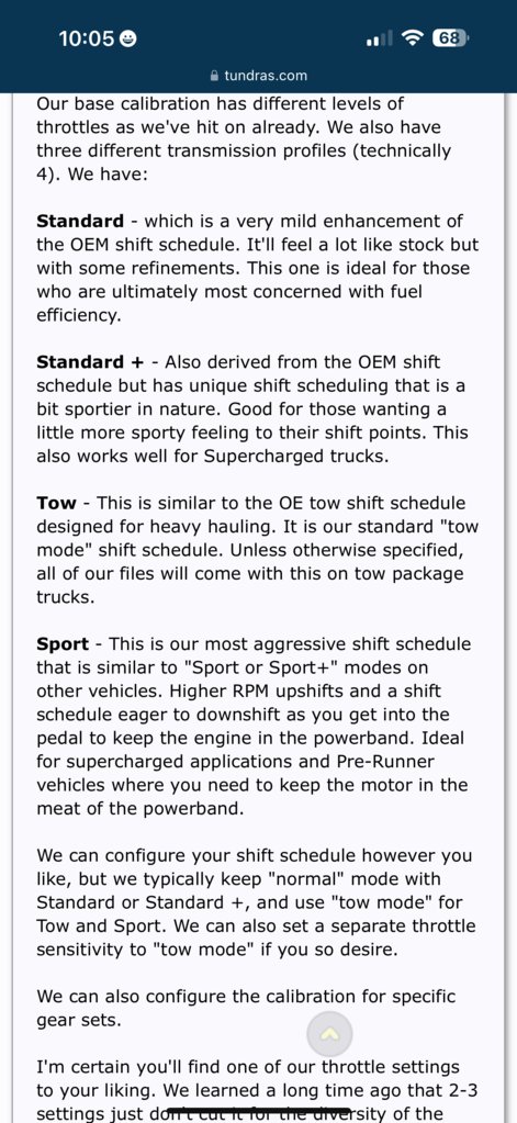

    Adding a screenshot from the thread I read about the transmission setting options and explanation from @JustDSM as well as a pic of Matt doing his thing.

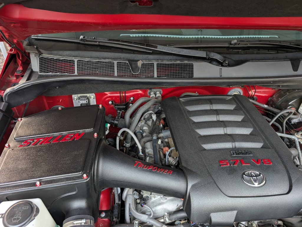

    PXL_20241007_230102407.jpgStillen for the win
