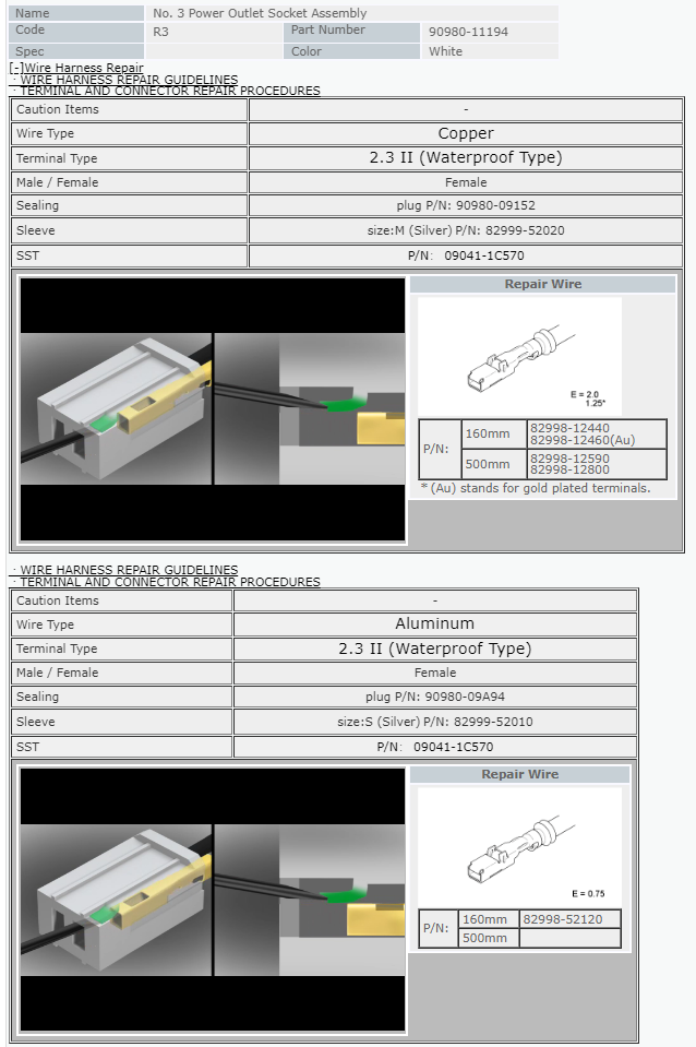

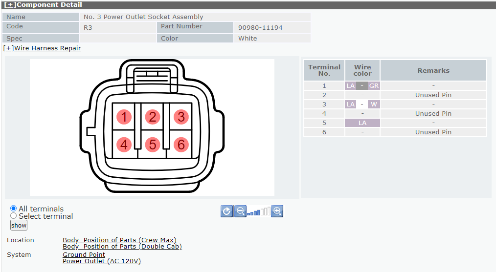

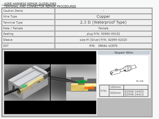

    I am looking to make a pigtail for the back of the 120v power outlet in the bed.
    Can anyone with TIS access look up the socket and repair wire part numbers?

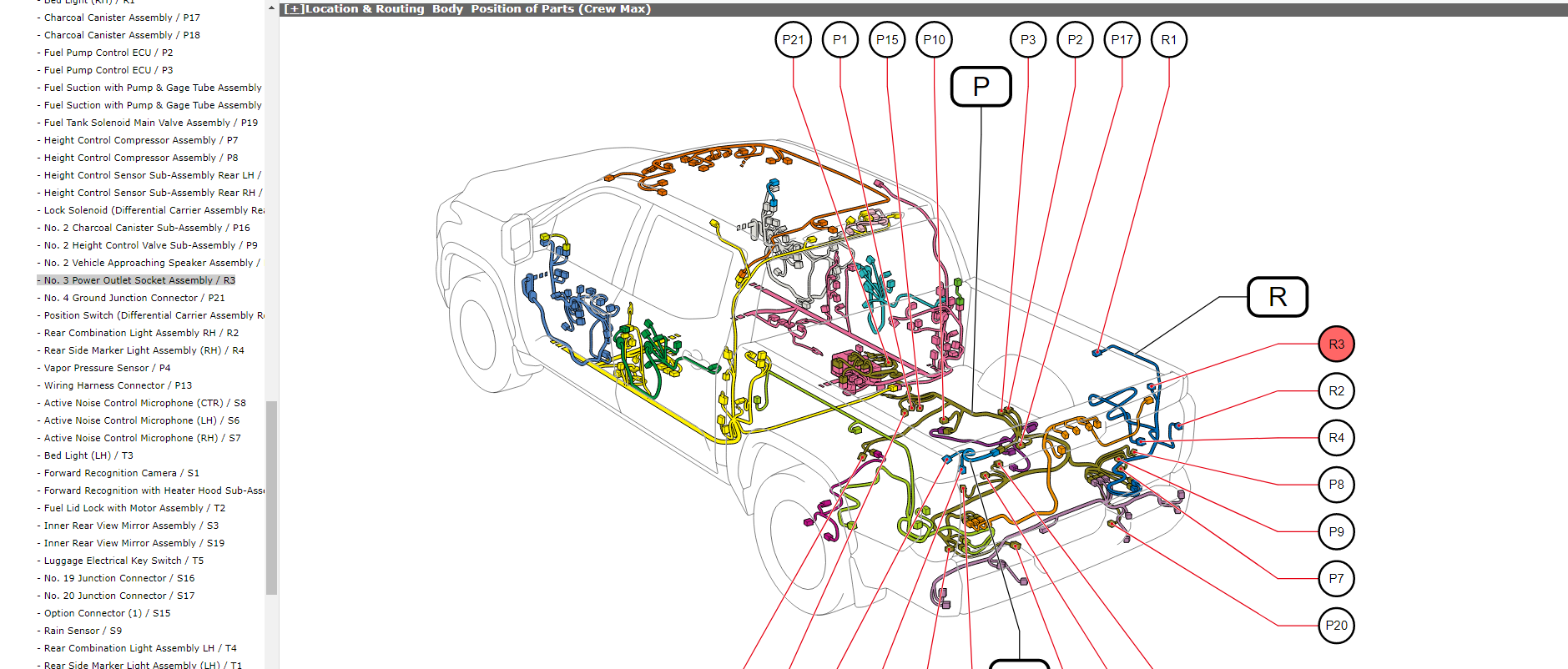

    I think I got the right connector, for the 120V 100W/400W outlet.

    Thank you!
