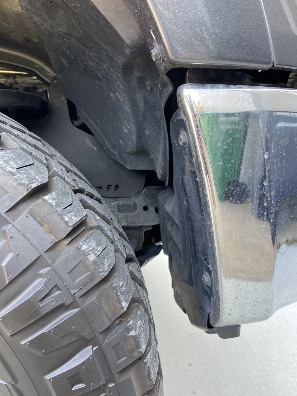

    Not to long ago i had a shop put on Bilstein 5100 at the highest setting and 295/70/18 Nittos on stock rims. Right after i trimmed the skid plate a little bit to avoid any Tire rubbing and thought that was going to be it. If i am pulling into a steep driveway and turning at most likely full lock it’s still catching on to something. I’ve looked through the forums and searching and I’m seeing wheel spacers and also replacing the UCAs. Please advise. My steering wheel while driving 60 plus also has a little shake to it. Please see pictures thanks

    Iv been closer and had zero issues for thousands of miles.
    Front plastic or cab mount are my guesses for your rubbing issue.

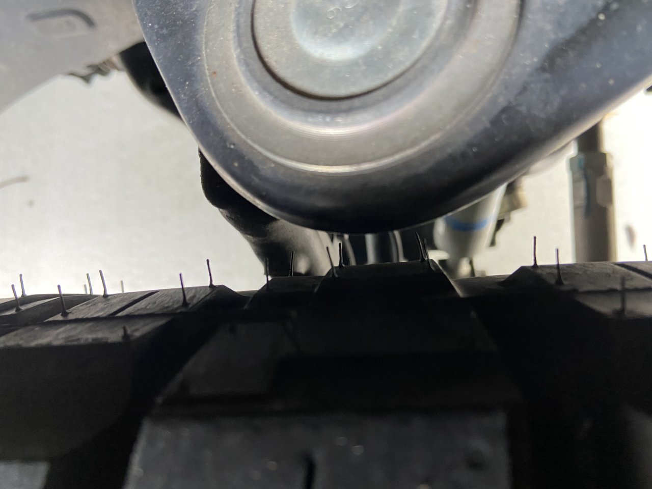

    It might just be my skid plate then I’ve thought about replacing it or trimming it more

    Turn the wheel full lock, get out and look. Keep in mind though, suspension will shift slightly when under load.

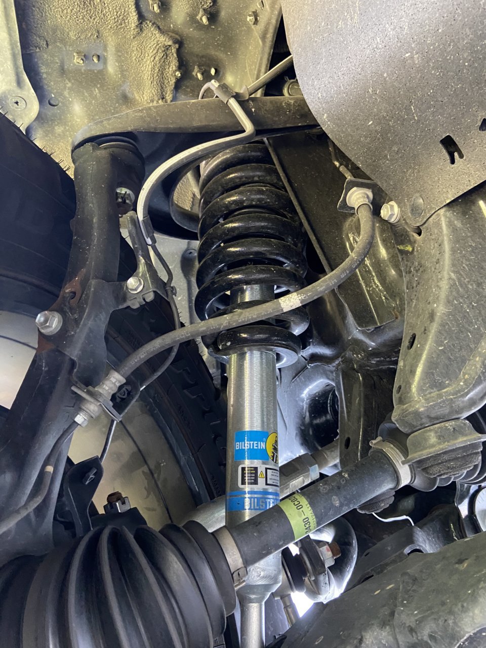

    Also, FYI, install the bump stop shims Bilstein provided you with. Without them your coilover is the bump stop due to coil block height.

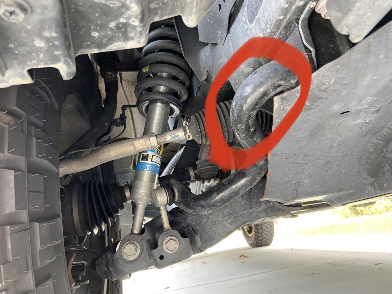

    It looks like the tires might be (or may have) rubbed on the Swaybar (in the circled area from your picture).

    Newbie here not sure if that was installed

    It wasnt, which I why I made the comment.

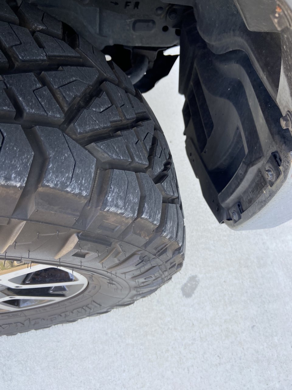

    Just showing where the tire sits on top of cab maybe i thought it was something different my apologies there

    For reference in regards to what I am asking for

    Thanks...but I am asking for cab side, cab mount. I am wanting to see if you are contacting the cab mount. Other end of the wheel well.
    ideally, cab mount side, pictures with both the wheel halfway to lock and at full lock.
