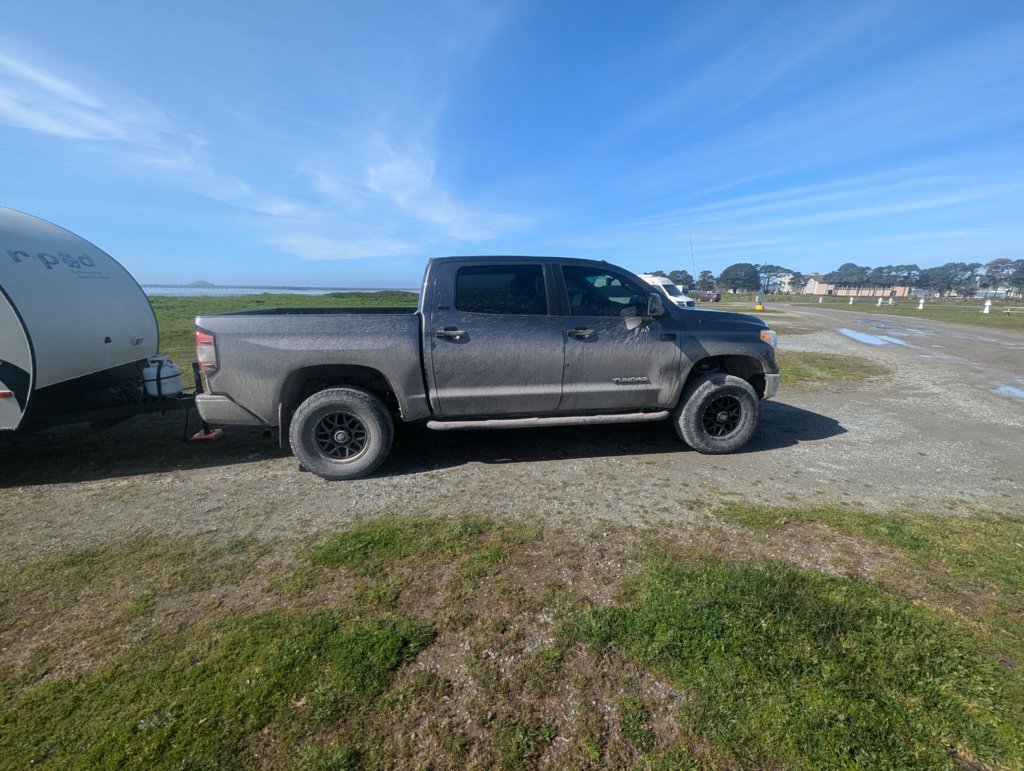

    3 inch lift 33 inch tires
    Hi everyone,
    You folks were very helpful a couple years ago when I was picking out a truck. Finally got a 2014 tundra 2 years ago and I love it.

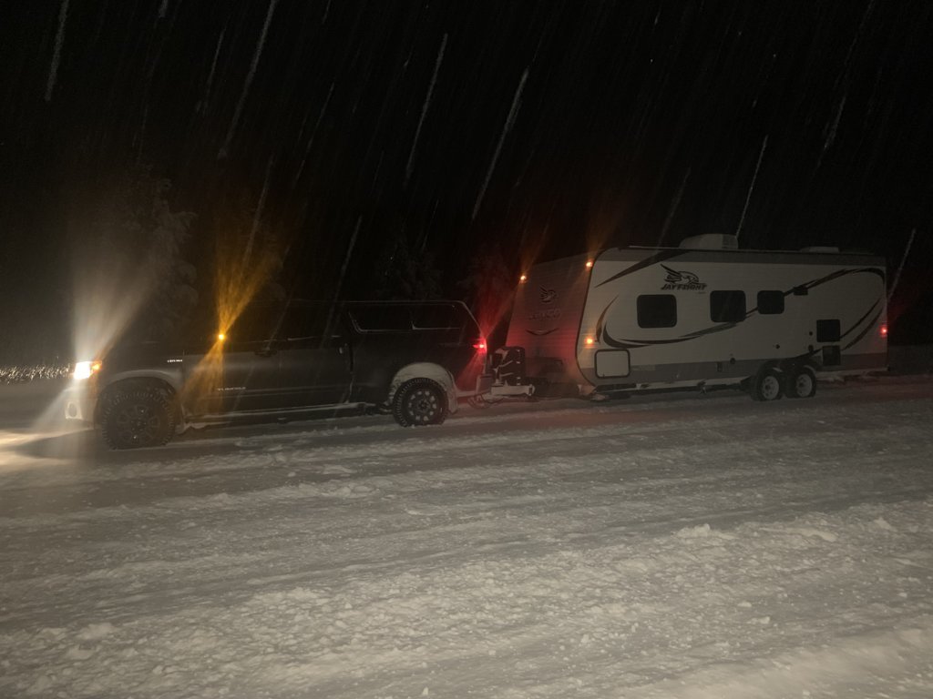

    I am looking at picking out new tires. Since I have a three inch lift I do like to have bigger tires. My current set is 10 ply 295 70 R 18 bridgestone duelers. I like them, got them at a discount used last summer and I need them. My first set were Cooper 285 75 17R. They looked bigger but I like both. I was wondering what would be best for both towing and snow. I spend a lot of time working up a mountain in the winter but tow in the summer. I was thinking on getting the duelers again but I am open to anything.
    Also, side question, what's the best way to maintain your suspension. I'll attach a picture but I feel like mine is looking a little rough.
    Thanks everyone. Sorry for the novel.

    Sounds like you need 2 sets.
    1.Snow/ winter tires
    2. Tow/ summer tires
    The characteristics that make 1 great at what it does are a huge compromise for doing the other.

    I like the KO2s, they've been good in the Canadian snow for me, just as good as the Falken At3w's I also tow with them very often.
    I do rotate them every oil change and I'm very vigilant on tire pressure when towing, I noticed with Tundras tire rotation is key to keep them wear even.
    As good as the Ko2s are in the snow, it still wont' beat a good set of snow tires, hopefully Nokian will introduce the LT3s in 37s (they do have them in 35s).
