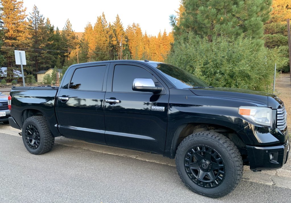

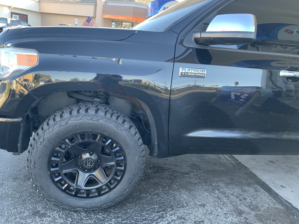

    I just put 275/60/20 Mickey Thompson Baja Boss A/T on my truck. Slight rub when full turn. Which will be easy to fix. I couldn’t be any happier with my choice.
