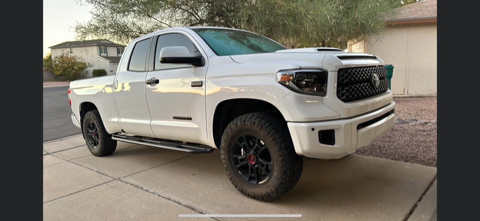

  20. Jan 7, 2024 at 6:53 AM
    29,556
  21. Feb 13, 2024 at 3:36 PM

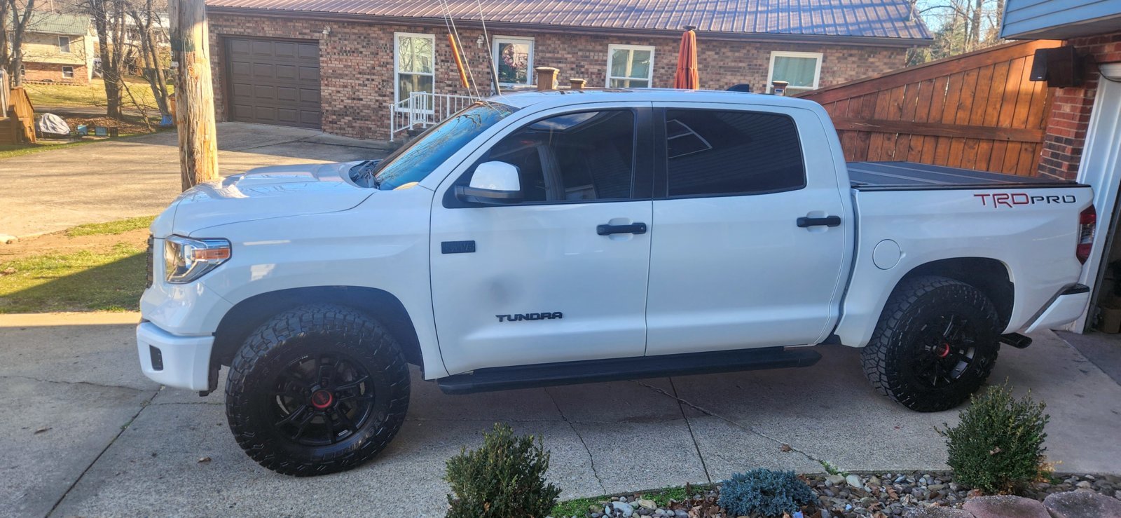

    SolarEclipse
    SolarEclipse [OP] New Member
    Jan 6, 2024
    #109764
    34
    20 TRD Pro
    Stock

  24. Feb 13, 2024 at 10:13 PM
    #24
    Flavier
    Flavier New Member
    Feb 5, 2024
    #111523
    2
    2020 Tundra TRD Pro
    Any rubbing?
  25. Feb 27, 2024 at 11:34 PM
    #25
    BillyB
    BillyB New Member
    Sep 26, 2021
    #68556
    1,166
    Billy
    AZ
    2021 SR5 TRD Sport 4x4
    Looks great!
  26. Feb 29, 2024 at 2:42 PM
    #26
    SolarEclipse
    Jan 6, 2024
    #109764
    34
    20 TRD Pro
    Stock
    No rubbing whatsoever

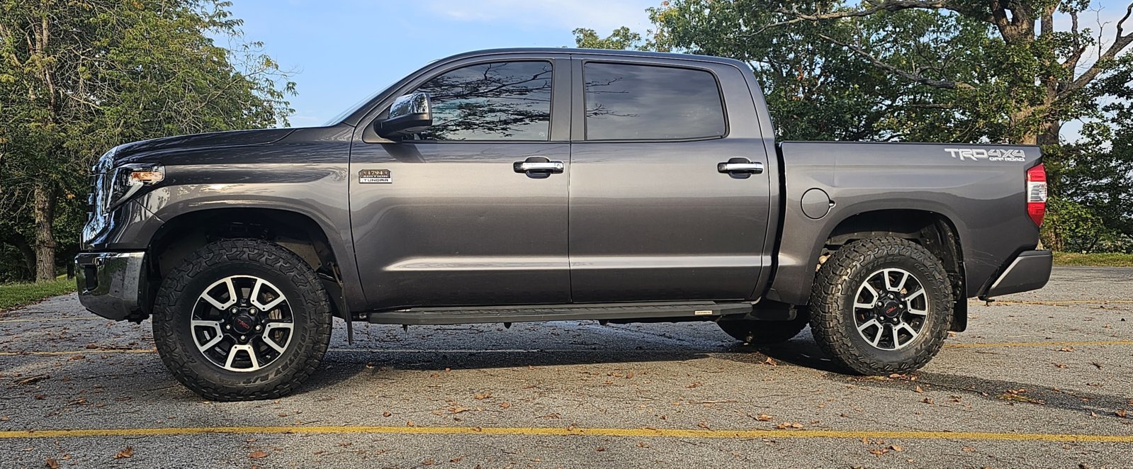

    Rngr188
    Rngr188 Ranked the best new member of all time
    Feb 9, 2017
    #6285
    1,534
    Chad
    Harrison AR
    2020 1794 MGM TRD OR
    I did the 295/70r18 Toyo Trail and I am not happy with the wet road traction. I ran two sets of Nitto Trail Grappler before these and they were surprisingly great on wet roads but I really have no use for a mud terrain tire. My previous Tundra ran Ridge Grapplers, right after they came out, that almost killed me on a wet mountain road so I was reluctant to try a hybrid tire again but looks like my apprehension was correct judging by the 3k miles I have on the R/T Trail ls. Pic for attention.
