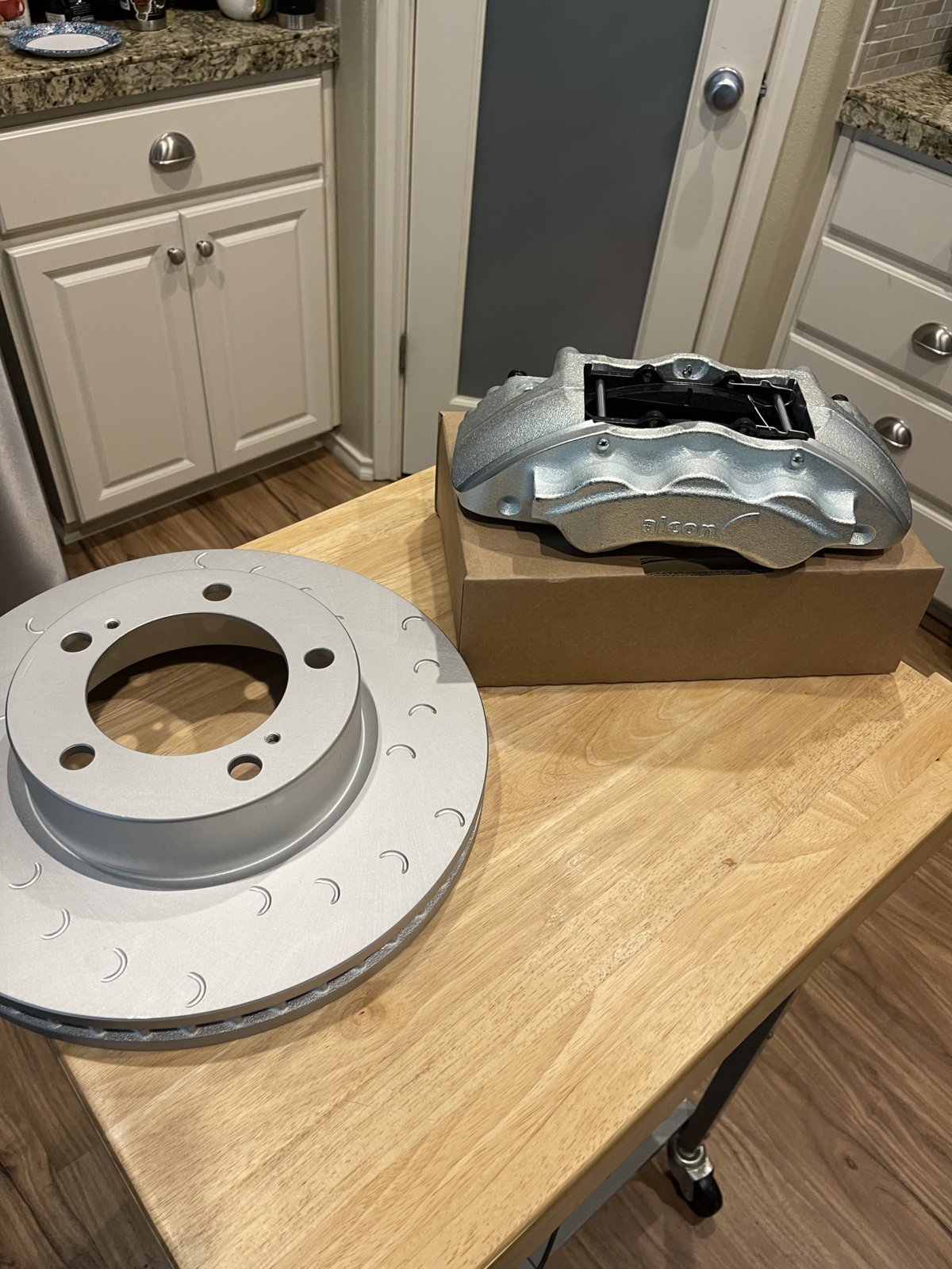

    And if you’re still having problems you should move to a better kit like this .
