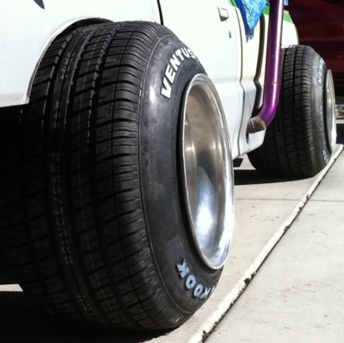

    Probably not between those two width rims. Maybe a little with a 10" or 12" wide rim. Would look ridiculous on either of those though. Like this:

    It won't
