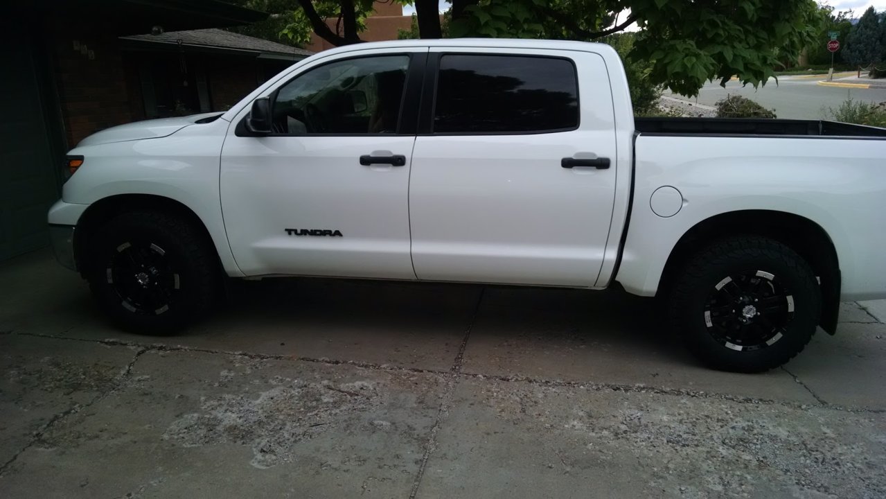

    I currently have 275/70/18 BFG K02s on my truck with a 3.25"/1" lift. But, I had those same tires on my truck before it was lifted. The key was different rims - mine have a +30 offset.

    No rubbing at all before the lift?
  5. Aug 27, 2018 at 8:13 AM
    Atomic City Tundra
    Mar 12, 2018
    #13508
    1,749
    Devin
    New Mexico
    2013 Tundra 5.7FFV CM 4X4
    None.
    Here it was before the lift:
    pizzabud[QUOTED] likes this.
