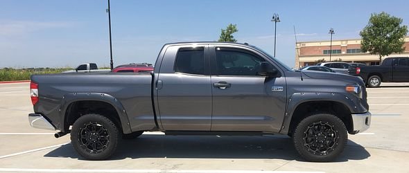

    I had 285/55/20s stock on my 2014.
    The dealer was then selling spacer-lifted 2015s with 305/55/20 tires.
    There was like a 1/4 of space between the tire and the UCA, a little too close for me..
    @Bham TRD when I installed 6112/5160s with the 6112s set on the second to the lowest setting, I ended up with 2.5" of front lift.
    It pretty much leveled the truck, but it started to set the nannies off on tight turns, thinking the truck was tipping over.:eek2:
    Looks nose high, but it measured level.
    I ended up putting Toytec shackles on the 1" setting on the rear to get a little bit of rake back.

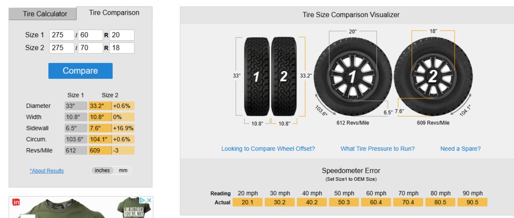

    Do y’all think a 275/70r18 would be an issue?

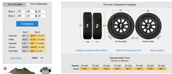

    A 275/70/18 would be about the same size as my 275/60/20.
    I have no problems with rubbing, although I ditched the front mudflaps.
    The truck rides and steers better with the thinner tire than the 285/55/20s it came with.
    Use this site for tire size and wheel offset comparing..
