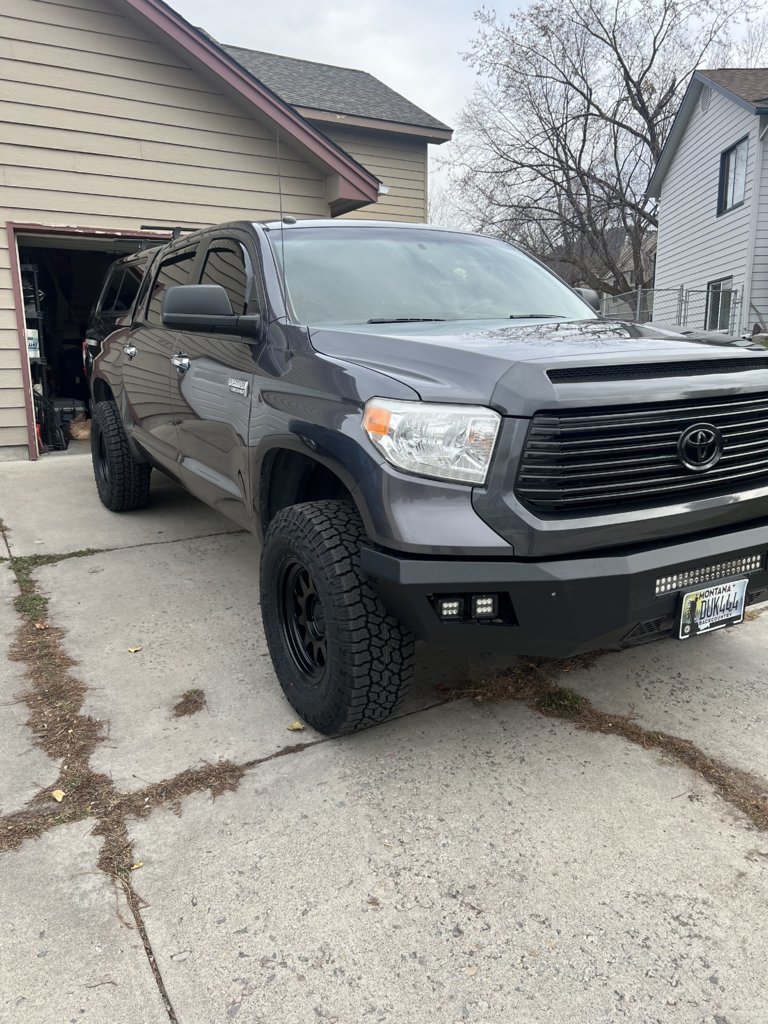

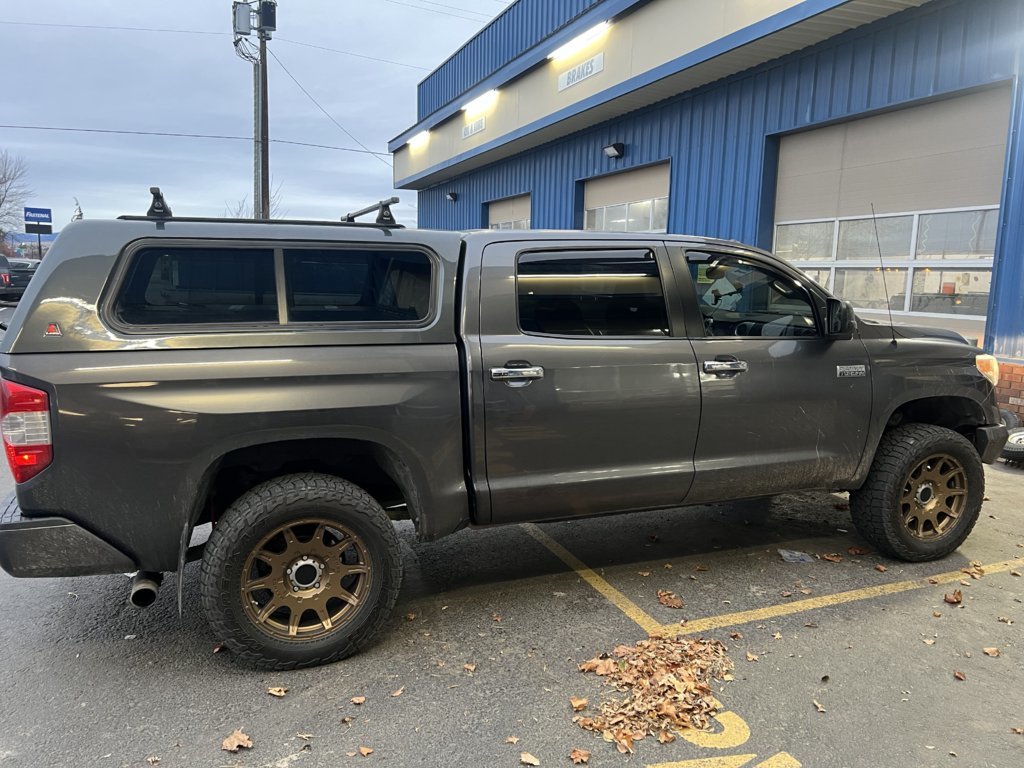

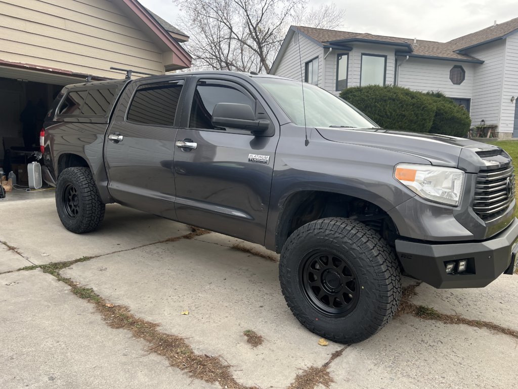

    Here’s before and after. Love them!

    Looks nice! Do they rub with that tire size and 0 offset? Did you have to mod/cut? BMC?

    No rubbing. I used to have 35’s on a couple tire sets ago so I’ve already removed the wheel liner but that’s about it. I have a 3” front a 2” rear lift/level kit.
