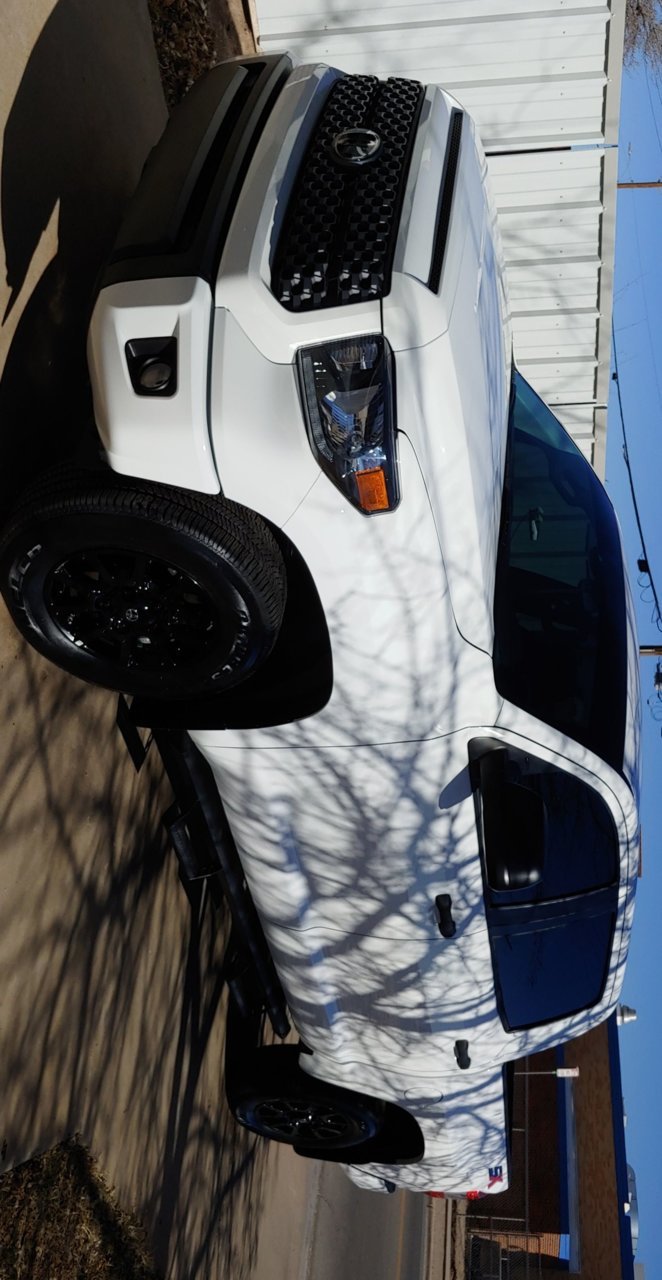

    I have a stock 2021 SX, I'm wanting to do a level and do some bigger tires. its has 18's on it, not sure to just go with 20's or if the 18's are good with just upgraded tires. Any thoughts?
    has any one done a level the SX? If so, what level size/tires/rims size did you use?

    The SX is no different than the rest of the trim levels in regards to leveling, lifting, etc.

    Keep the 18s. I wish I had 18s but the only way I could get BFGs on a new Tundra was with 20s.

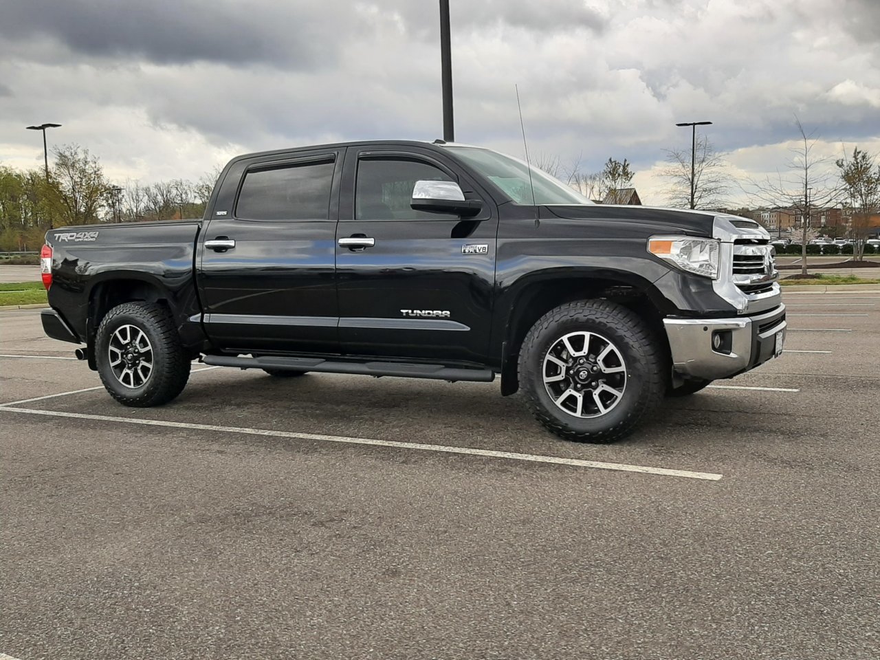

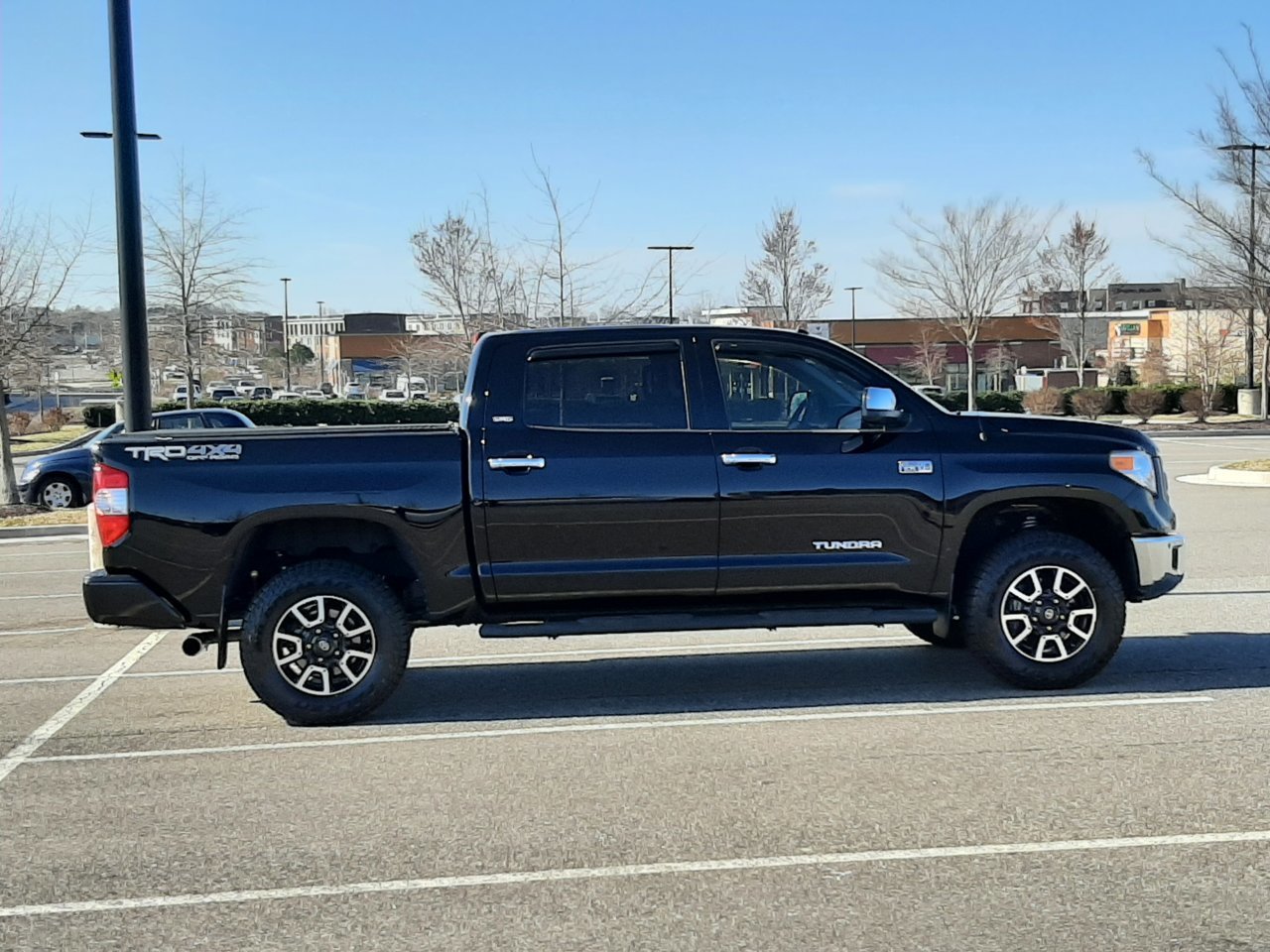

    Sure, first is 275/70, stock and 2nd is same tires but with 2/1 lift- about the same stance as a TRDPRO.

    how did it ride with 275/70?

    E load, as are most tires if you want something larger than stock on a Tundra. E load is overkill for a half ton, C load would be perfect. They are firmer, cornering is better. I think it drives and handles better, but not as cushy ride as the stock SL tires. You feel road imperfections more. Getting tire air pressure right based on your truck setup, load, weight helps greatly. Tundra's seem sensitive to air pressure, even a couple pounds adjustment difference makes a big difference in ride comfort, tire wear, etc. I am happy with the mods, good driving and a bit of a sporty ride.
