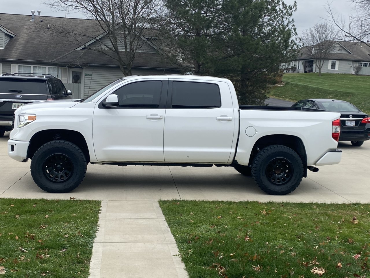

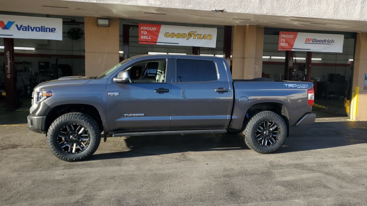

    I've lifted my truck with the rough country 3" lift kit..Installed yokohama 295/65/20
    at full turn the tire touches the chassis..any suggestions on what can be done.

    is it touching the body mount? If so, you can have the body mount chop done. It’s probably a couple hundred bucks.

    Where is it hitting...at the bottom of the wheel well right behind the tire? If so you would need a body mount chop.
