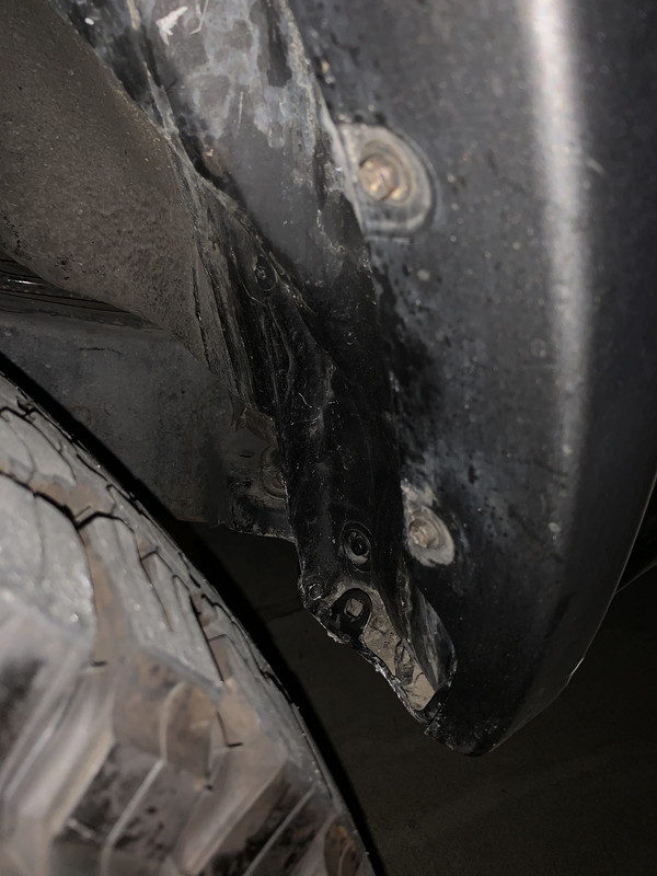

    Have slight rub at full turn (either direction, both sides, same place on the inner fender wells).
    I cut the plastic and trimmed down the vertical body metal where it rubs. Often referred to as the "pinch weld" but mine has a bolt there. I was too shy with the grinder and still rubbing.
    Can I go ahead and cut beyond that bolt without causing trouble? I recall seeing threads that discuss this but it's a hard one to dig up on the search feature. Planning to address this again today.
    [​IMG]2021-06-14_08-26-52 by GhostCreekMine, on Flickr

    Paint it black and it will rub too fast for you to notice.
    I cut mine fairly aggressively many years ago. If I could go back I would have beat it inwards with a mini sledge. You can beat it just about flat and that will give you clearance without sacrificing much structure.
    Curious, what is the width and backspace of your wheels? The further out you push the wheels to avoid frame, the deeper into the pinch weld your tires will go.

    So, you suggest... leave the bolt in there and maybe getting an inward bend started with a channel lock or vise grip then hammer time? Cuz that would actually be much easier than the cutoff wheel.

    I cut just around the bolt on mine, it is the spacers causing the rubbing for you. I just took a grinder to mine and cut it without care and added black paint.
    I added spacers also but had them on for about 5min. Had to cut way more to run them. Looks like you are running methods with 0 offset, plus the spacer that -38 offset. ( same as me)
    I just live with the frame rub at full lock to the left.
    You also have to worry about compressed left and right turns, those will make you fell like the fenders falling off.
    are you running aftermarket UCA?

    Yeah if you can get the bend started with pliers of some kind then hammer it home that would work. I would use a 3 or 4 pound hammer and swing gently to keep control of the bend, let the hammer do the work. Swing too hard and bad mangler stuff might happen.
    Leave the bolt in, it shouldn't hurt anything. When I cut mine out I cut beyond the bolts and put new bolts in place on what was left. I wish I had seen the hammer method at the time, I would have done that.

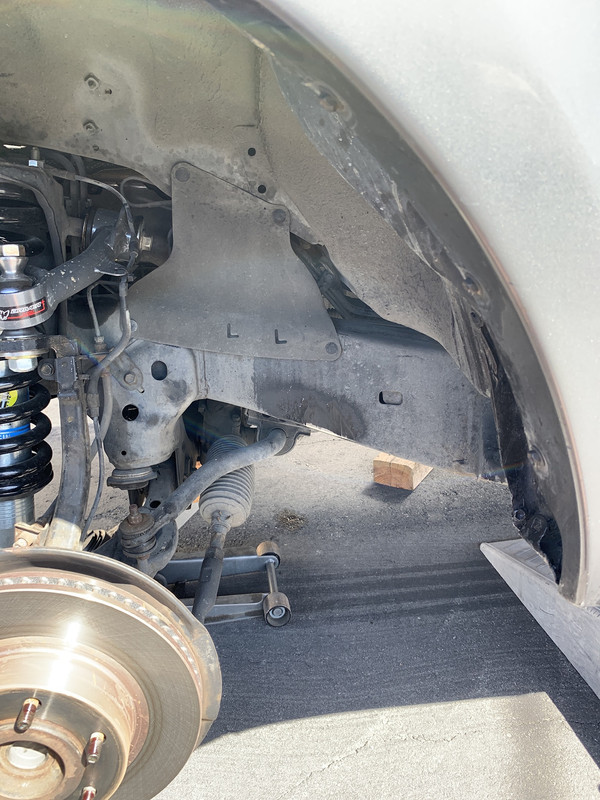

    I did the same thing as you, thought it would help. But I ignored all the threads about it not working and just told myself I would cut more off.
    turns out the more off is more than I can do.
    I talked to a guy that owns an off-road shop and he said they can trim it back and weld it to make it safe. Then they throw seam sealer on it to make it pretty. I might just do it because it would solve my frame issue.
    Added a photo and you can see the rub mark and cut, [​IMG]

    Jerry, from your pics it looks like you're getting some tire rub on the frame rail (chassis) too?

    yeah, frame rub at full lock to the left only. That’s what made me buy the spacers to push the wheel out. But ran into the same issue with pinch weld rubbing.
    I just live with the frame rubbing. It’s been 6 months

    Almost, I’m on methods 17 inch, with 0 offset, 285 ko2. With 2.5 lift and camburg uca
