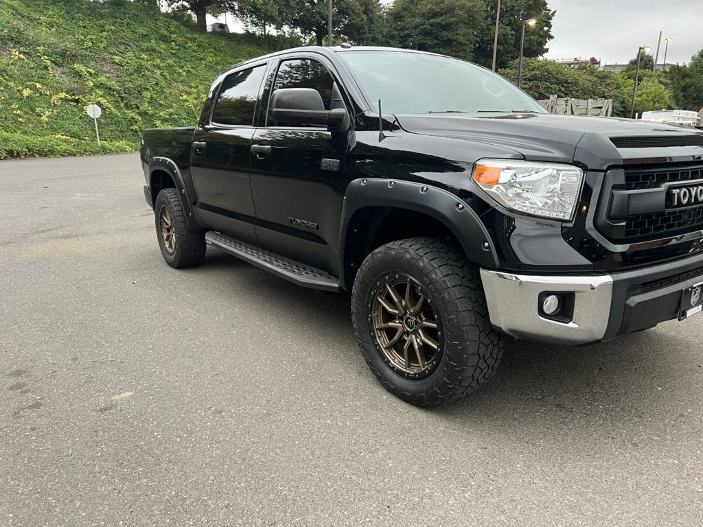

    So when I bought my tundra it has 295 60/r20’s on it…
    in the market for some new tires but have come to realize, that size is more expensive the others.
    what tire size would yall recommend to go with a 20” fuel wheel.
    pic so you know what I’m working with.

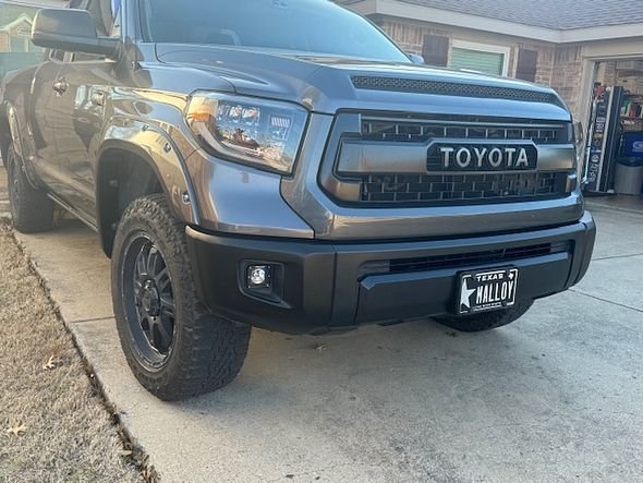

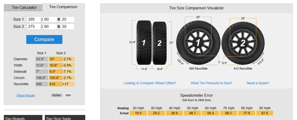

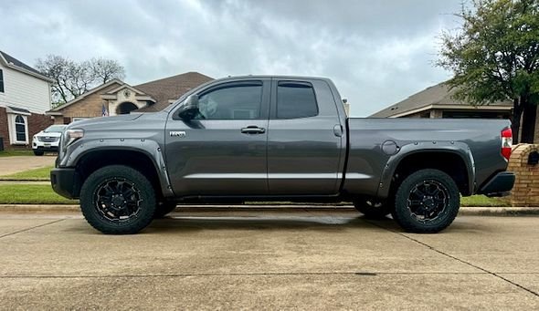

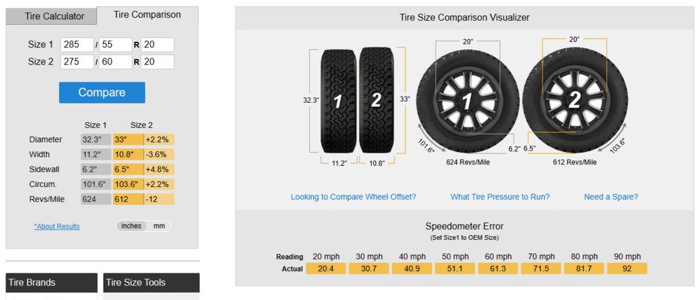

    I'm running 275/60/20 although I have a 2.5 lift in front and 1" lift in the rear.
    6f0c043c-68bf-4e63-98b5-b3e0a55ba8e9_5986f810e2a2edcb6ccc91b573c3823161314287.jpg 3610459d-11cb-4fff-b51b-bacf1599a13a_195938f3e058b6a33a564aa32cdfdc838525680f.jpg
    Be an inch shorter and .8 narrower than what you have.
    My stock tires where 285/55/20 and I do like the narrower tire.

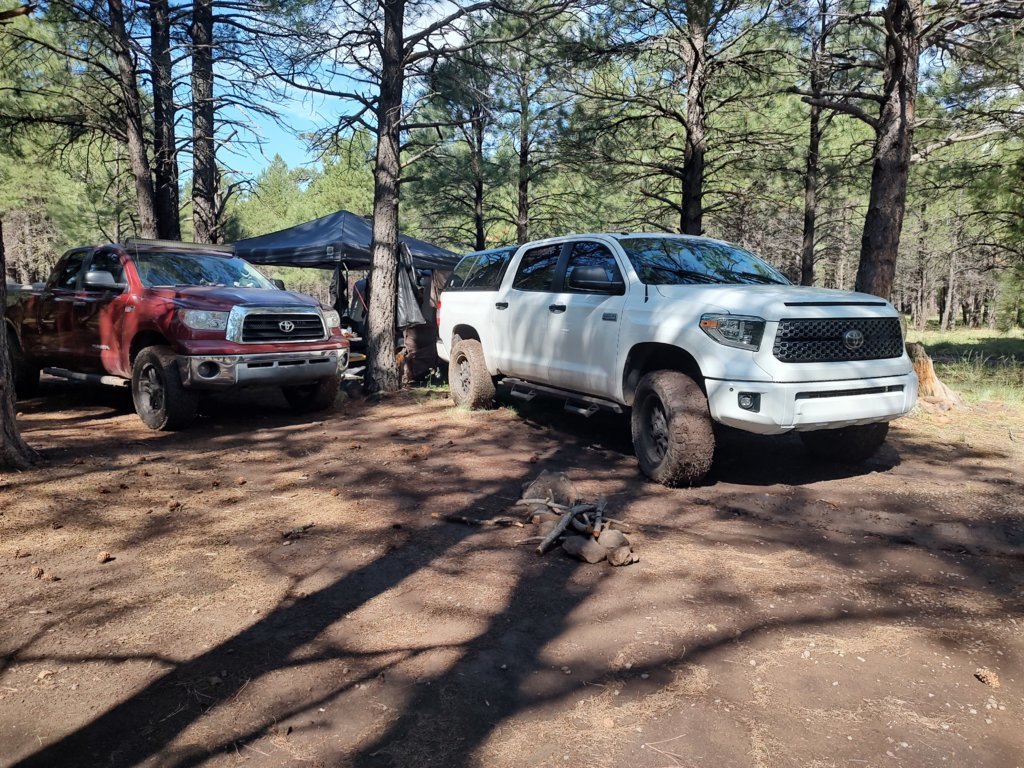

    35x12.5x20 (both trucks in the pic have that size, mine is the white one). Any lesser size looks too small for that much rim if you ask me.

    I'm embarrassed to admit this but the truck has one of those lousy 3/1 spacer lifts (3" spacer up front, 1" block in the back).
    I bought the truck that way, and it will be getting swapped out for a proper lift (coilovers + AAL), but I'm buying a new house so that'll be at least 6 months down the road.
    The 2008 in the pic has the same size tires with only a 1" spacer up front and no rear lift (and has no rub).
