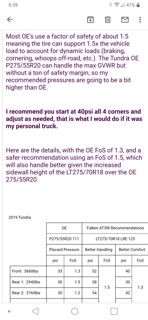

    Take this for what it is worth. Here is a breakdown for e-rated falkens vs factory 20" bridgestones, direct from Falken. Makes sense, but chalk test and get the best contact patch you can - tread wear and tire life will thank you. That said, I've never heard about FoS before but it makes sense
    Screenshot_20210730-065935.jpg Rear axle 1 was was unloaded and rear axle 2 was with raw tongue weight of a trailer.
