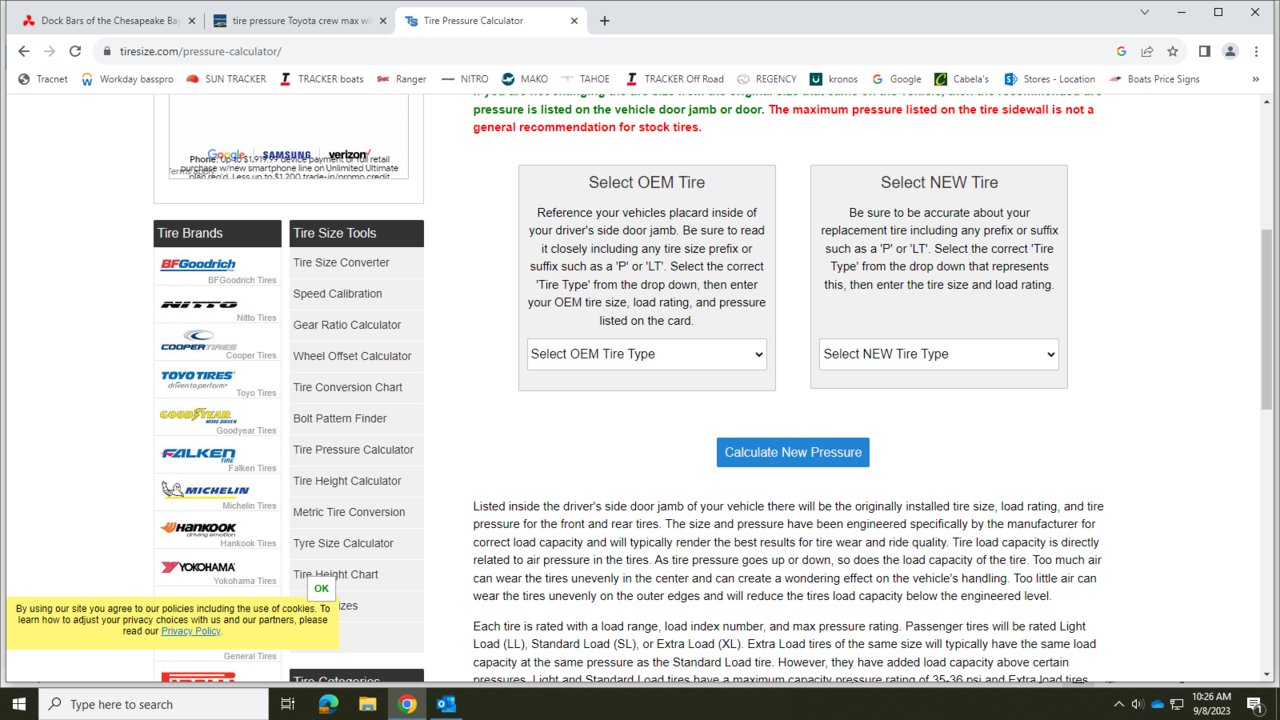

    use this tool, select your oem tire size, pressure, etc. It is listed on driver door jam.
    Then input your current tire info and it will give you pressure for the new setup. That should get you in the ballpark of correct pressure. If you want to go further, do a chalk test. Google chalk test on youtube and you will get lots of vids on how to perform it.

    on your driver door jam there is a sticker that will list the original tire size that came on the truck and the air pressure. Input that data into the OEM tire size box. See below
    Then in the new tire box, input the data for the 22 inch tires you are running. Hit the calculate pressure button at the bottom and you will have the pressure for the 22inch tires. Should be super easy
