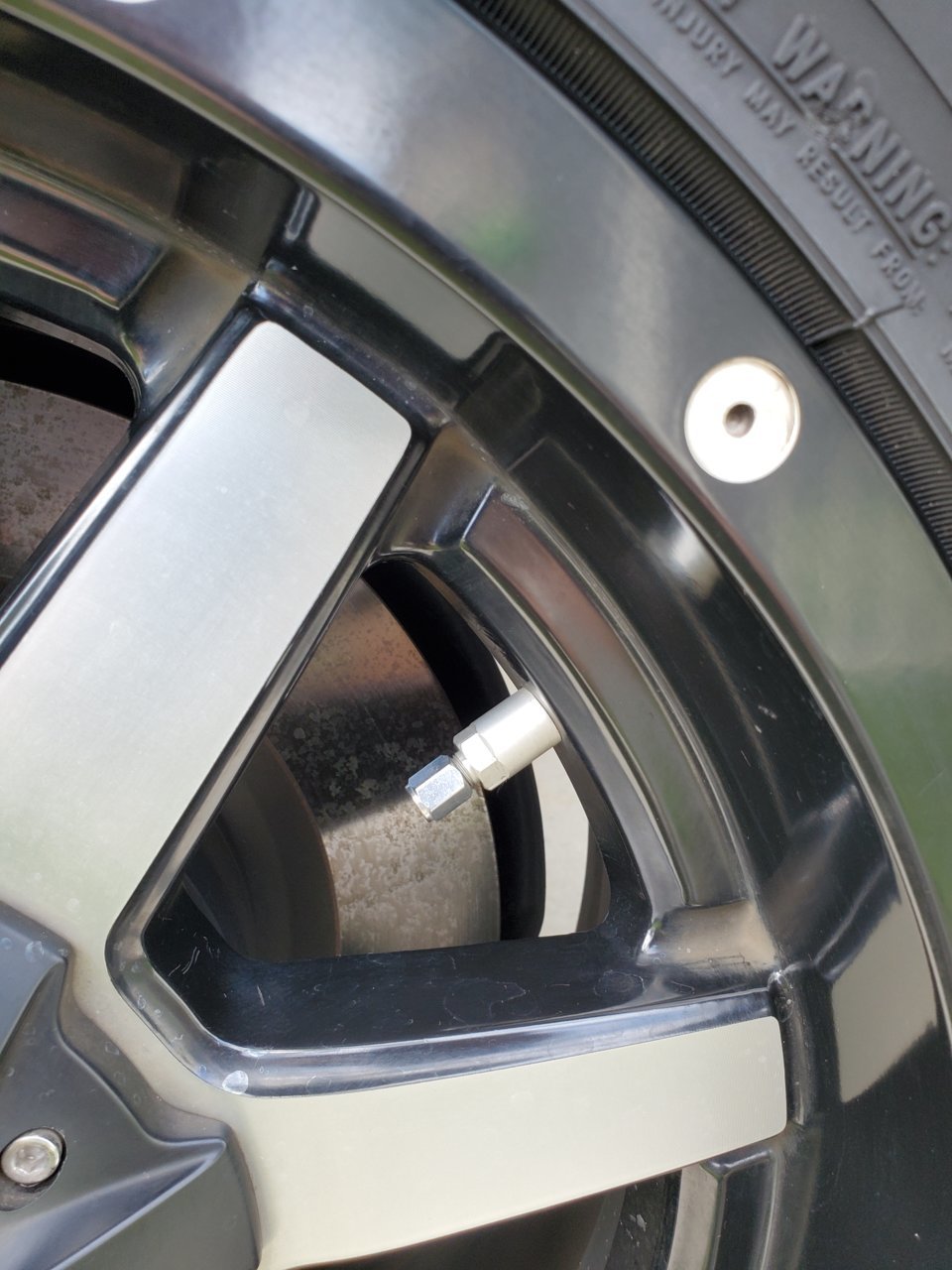

    If you have sensors, they will look like this. My stock tires are about 6 feet away from mine. I think once yours are registered then it won't see the old ones.

    Mine look like normal rubber valve stems. They must be high pressure ones.

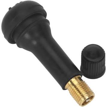

    If they look like this then there are no sensors installed.

    I didn’t get a receipt for the free installation of new tires. I specifically asked NOT to have them installed because their aftermarket versions can deal with high psi tires, so I was told. Thanks
    I don’t think I have them. I think my truck is still detecting the tires I have that are stacked in m garage.
