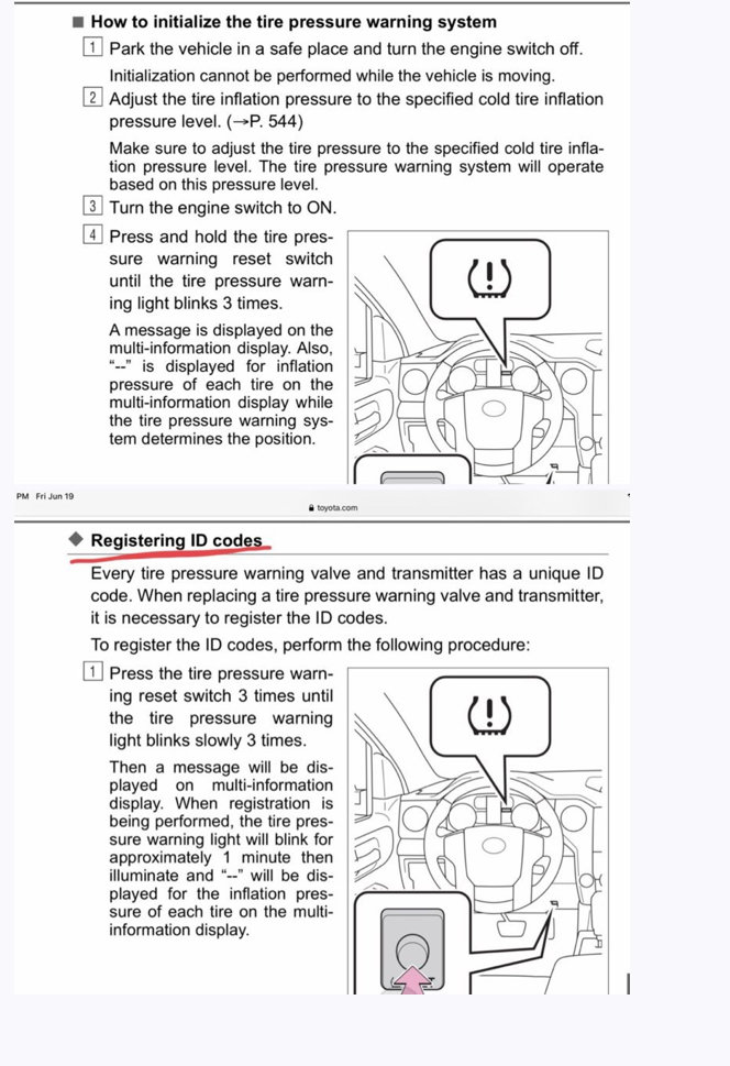

    Info on how to do this?

    should be able to use the first option
    Not the one with the red line
