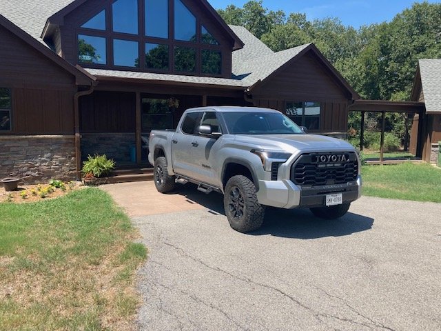

    This is 3" Toyota Lift with 295/65r20 tires, they measure 1/4-1/2" taller than typical 35's . I was also running 1" wheel BORA wheel spacers.

    I had rubbing before and after the spacers. I cut off the frame horns and trimmed some plastic. You still rub the Sway Bar.
