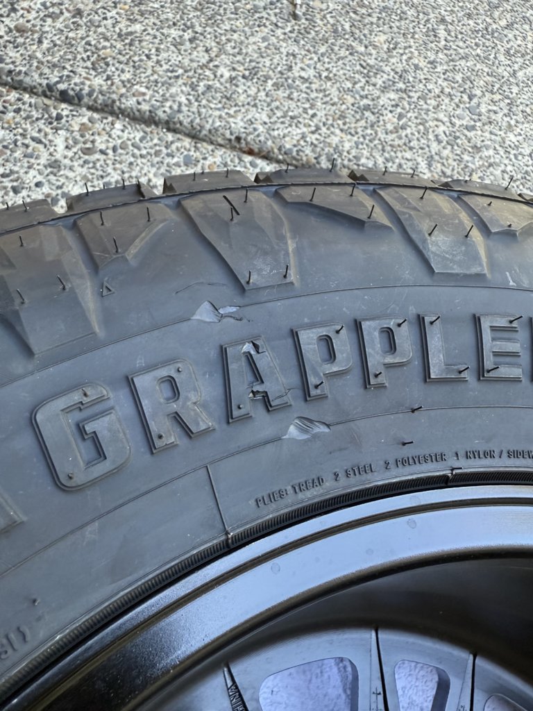

    Wife Hit a curb/drove over something and noted this on my sidewall. Could have been a pot hole. She is not sure.
    I think it’s slowly leaking air, but very very slowly; maybe 1 psi every 2 days. Difficult to tell with our weather changes daily of how hot it gets in the day and cold at night.
    thoughts?

    That’s the inside of the tire, no?

    If the sidewall is damaged to the point of leaking air I would consider the tire compromised and get rid of it.

    Yes

    Definitely gonna get it looked at soon

    Get a spray bottle of soapy water and spray it and see if it bubbles.

    I wouldn’t drive on it.

    Agreed.
    It appears to be cosmetic/superficial, but the only way to know for certain is to dunk it or spray soapy water and look for bubbles.
    Also agreed. If it turns out to be leaking from those gashes on the sidewall then it is best to replace the tire immediately.

    Just so ya know, a blowout can tear up a fender and paint a little bit or even quite a bit in some cases.

    Wait, I'm confused. (Not unusual, just ask my wife)
    How does one damage the inside of a tire from hitting a curb?
    Looks superficial from the pic, but??? If air's coming out from there, no bueno.

    Negative! Replace ASAP!

    lol, ask my wife, she did it. Having it looked at Monday.

    From what I can see in the picture, I think that tire is OK. But I can’t see enough from the picture to say either way, so your plan for a professional assessment is spot on.
