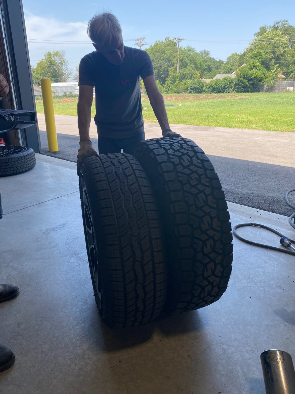

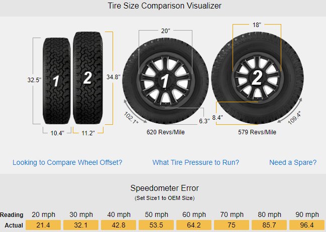

    The day I bought my truck, I switched from the factory 20" TRD Off road wheels with 265/60R20 tires(for sale here) to a set of TRD Pro wheels and 285/75R18 tires.
    According to an online calculator, I'm off 5 mph at 70, which I'm fine with. It's also going to show that I get slightly less mpg on the dash, which I am also fine with.
    This morning, I drove by one of the police radar signs. My speedometer read 40 mph and the sign said I was going 41.
    Either the speedometer was off (on the low side)with the factory tires, or the radar sign was(which I doubt). Either way, I'm close enough that I don't care to update it.

    At 40 it will be fairly close. The higher speeds not so much.
