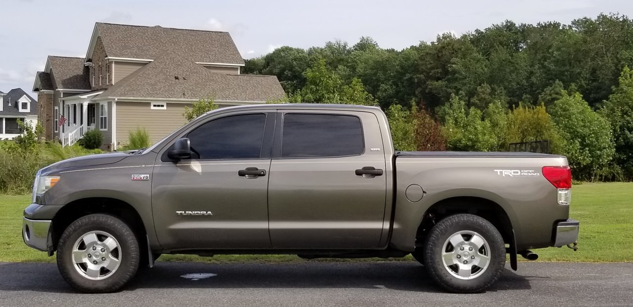

    New on here, have a 2011 sr5 with rancho quicklift on front end and 9000 on rear on a 275/70/18 toyo all terrains on stock 18s. Looking to get new 33x12.5x18 crosswind mud terrain/ all terrains, on the description of tire it says it's a 33x13.00 but call it a 12.50. Will I need spacers or is this to mich for a stock 18? Any info would be appreciated
    Also looking for new rotors and brakes any info on those as well

    according to the wheels and tires sticky, the biggest tires you can run on stock 18s with a level are 33x11.5

    Looks good with the Rancho Quicklift! How is the ride? Any issues with vibration?
    I’m looking into the lift myself and want to maintain a softish ride, I’m curious how the adjustable damper has worked for you.
