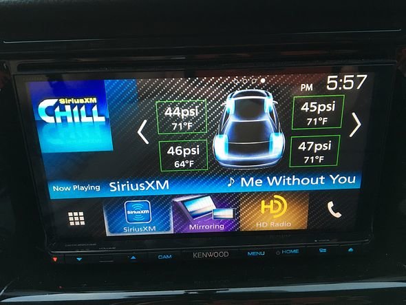

    I have a Kenwood HU in my 2014 and it shows tire pressure.
    It's actually my 4th HU, but all 3 aftermarket HUs showed it..
    Good luck.
