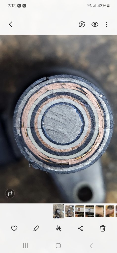

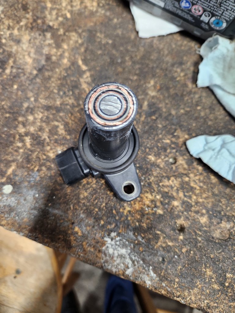

  20. Nov 26, 2024 at 1:37 PM
    EngMech
    EngMech New Member
    Nov 26, 2024
    #126448
    2
    2000 Tundra Ext Cab 4x4 4.7L
    Those tiny cracks (and even large cracks) in the outer sheath mean absolutely nothing. There are multiple layers of insulators and windings to get through before the ignition spark could even reach that crack and then jump the air gap to the spark plug tube. Don't waste your money on new coils or even bother with JB Weld or anything else to seal the cracks if your engine is running fine and you aren't getting any codes. See pictures and notice that the one I cut through has a cracked sheath as well, but it was just fine.

    At 300k, I legitimately think you've gotten your fair value/use out of the factory coils, we've seen some members lose coils on their trucks in the 150k-250k range. Anything over 250k miles, you'll likely notice a significant difference replacing coils and injectors.
    Only buy Denso brand from a legit source. The OEM coil packs fire hotter than aftermarket.

    Yes, everything eventually breaks down. But unlike spark plugs that lose bits of metal and ceramic over time I believe, outside of terminal connection failures or any electronics components, the insulation on the coil windings just degrades and can fall apart over time causing coils to short and fail to produce the voltage uplift they were designed to provide. I believe this occurs by heat cycles and vibrations over time rather than directly by the current that passes through them. At 300K miles and I'm sure a couple of decades of use, those failures might start to show up. However if you do a resistance test on the coils designating pin 1 as the pin closest to where the bolt holds the coil to the head. Resistance from Pin 1 to Pin 2 should be in the neighborhood of 350 ohms and pin 1 to pin 4 should be around 22,000 ohms. If the coils are near these values the spark produced by them should not be compromised and thus you would not likely see any improvement in performance by replacing the coils but you would gain confidence in their reliability for another couple of decades. I would hang on to some if not all of the old coils if you do change them to use for troubleshooting or quick replacement stock in the future since you know they were performing fine when you pulled them out.
    As Shifty has stated the fuel injectors could be well worn to the point they are not producing the fine spray that they should and instead are spitting droplets into the cylinders. I have seen SIGNIFICANT performance increases by replacing worn injectors but I've never seen any increase in performance or economy by replacing a coil that hasn't failed and tests good.
