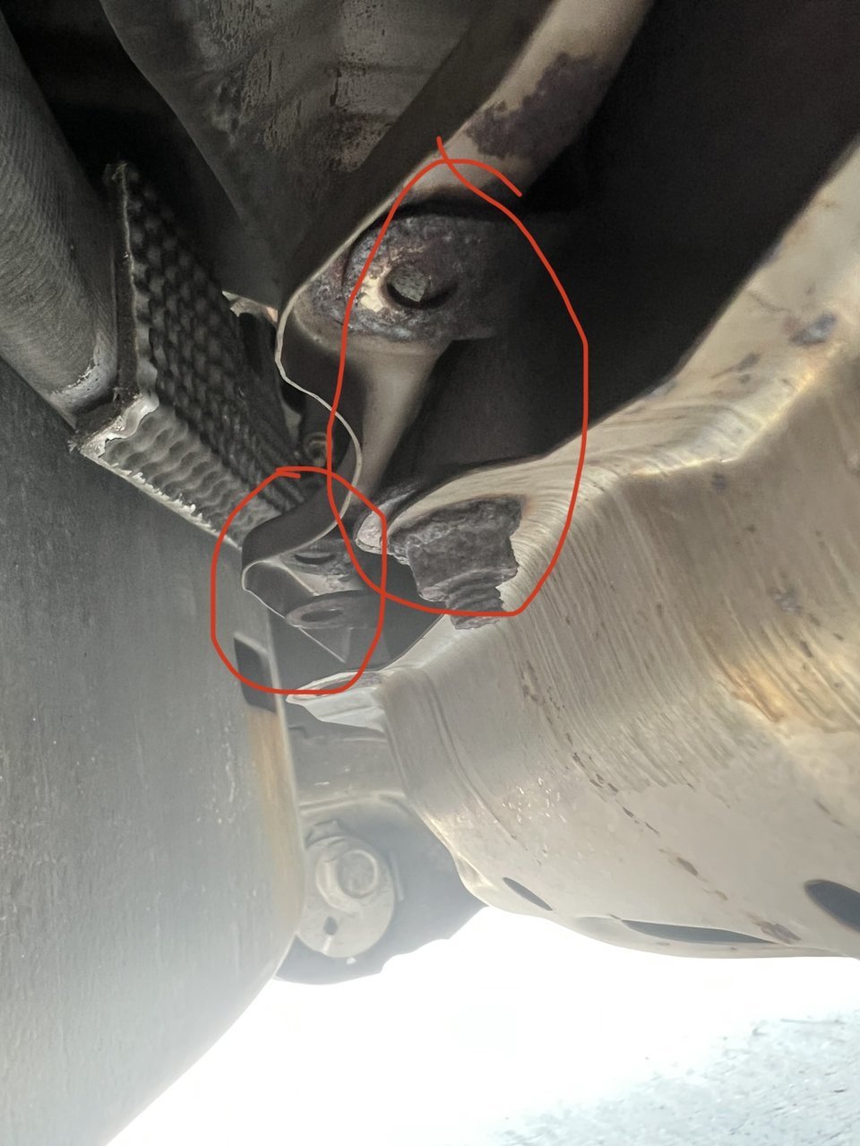

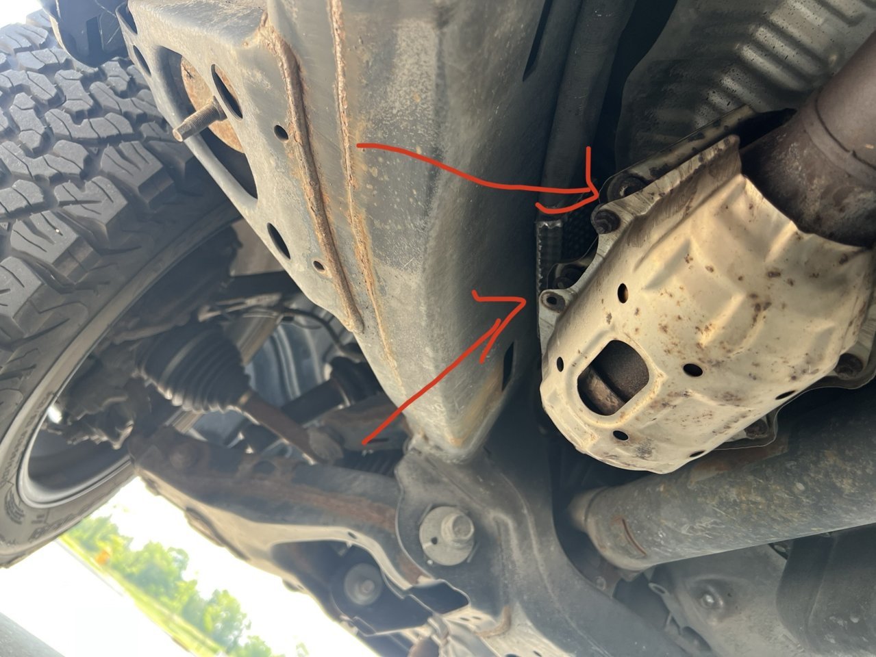

    I just fixed this same problem yesterday. I had 2 bolts fall out that fasten the heat shield around the cat under the drivers side. Easy fix. Was annoying to figure out and took me a while to find.

    @RockWarriorLover
    Sure. Here’s some photos. Mine is right behind the drivers side wheel. Heat shield bolts. Check all your cats, not just this one.

    Thanks so much man, i knocked on the rear driver one and its making the sound, will try to tackle it later sometime today.

    Fixed it after looking under and further inspection, I saw I was missing a bolt and the clamp was just sitting and causing the chirping. Thanks for the guidance, I just found a good bolt and matching washer and nut to put on it, make sure its stainless steel so it doesnt rust.
