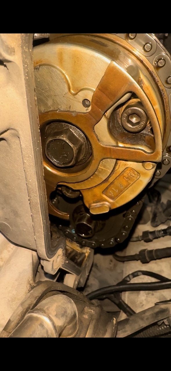

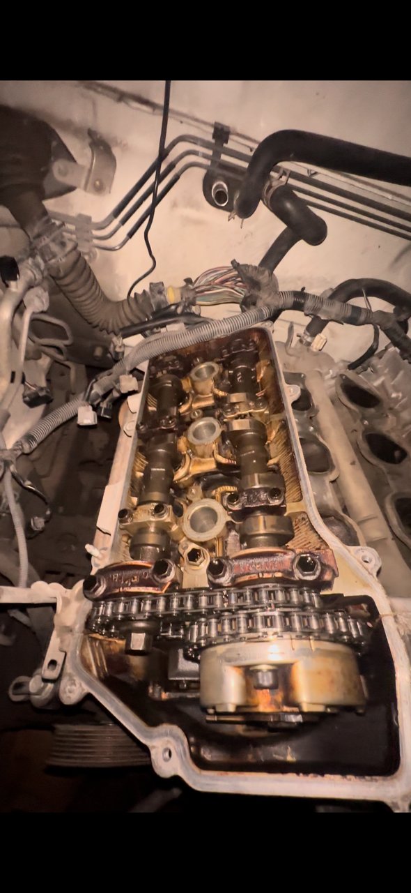

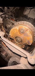

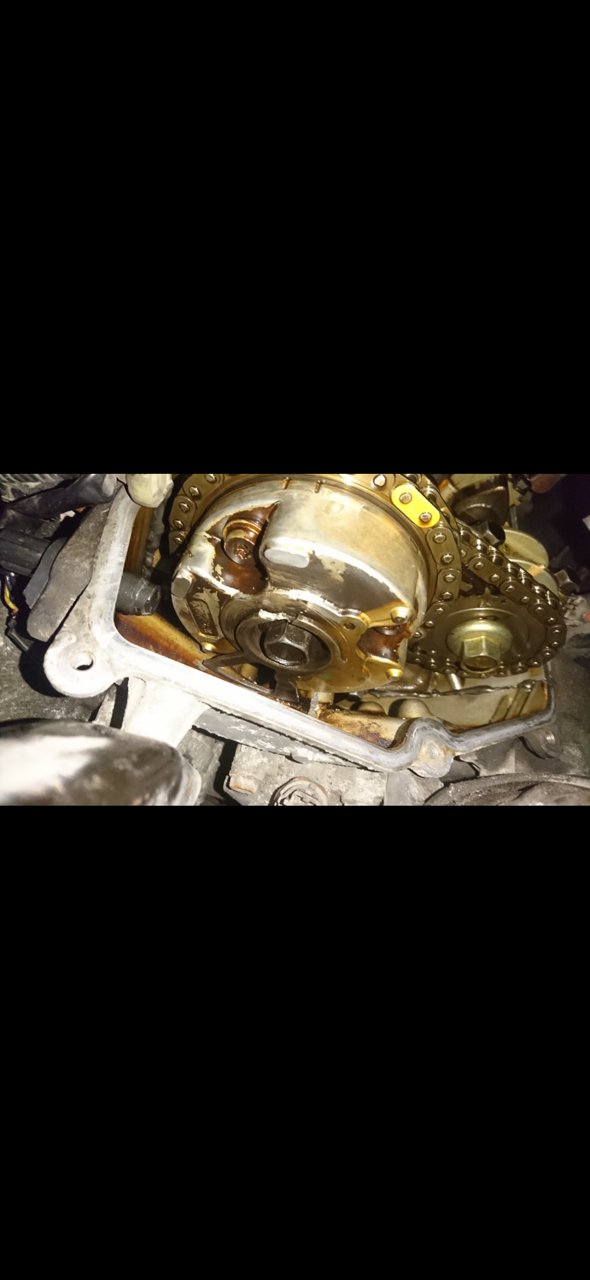

    I opened up my exaust cover and found that my passenger side camshaft sprocket propeller was broken. How screwed am I ?

    Need some bigger pictures. And, what are you referring to a the "sprocket propeller"?

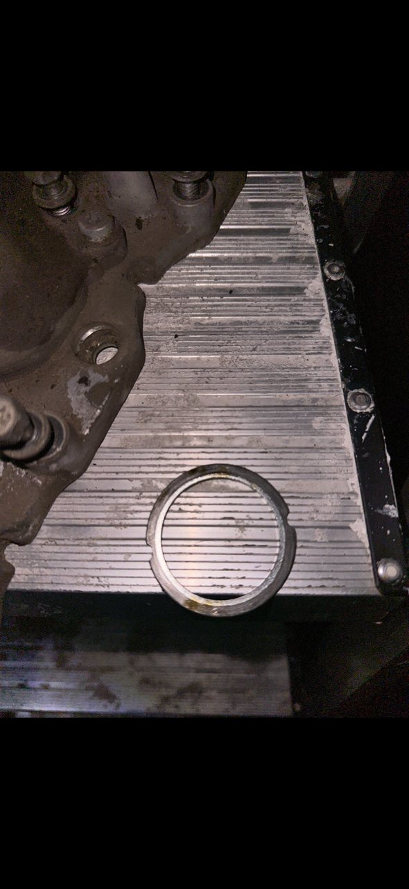

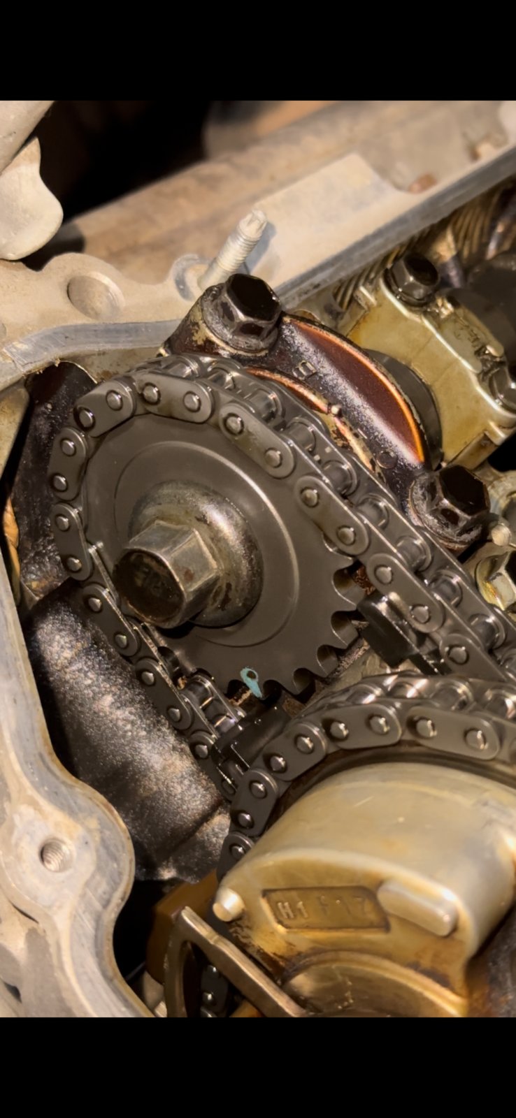

    Yes the propeller I also found a loose bolt in one of the valve holes as well as this ring thing.

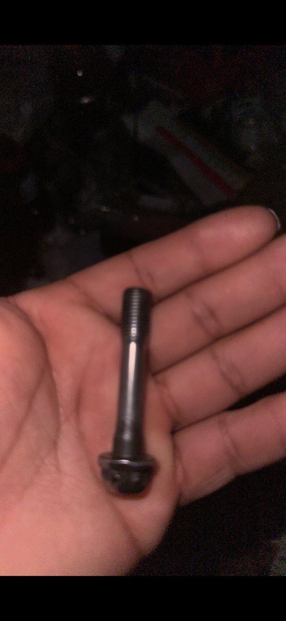

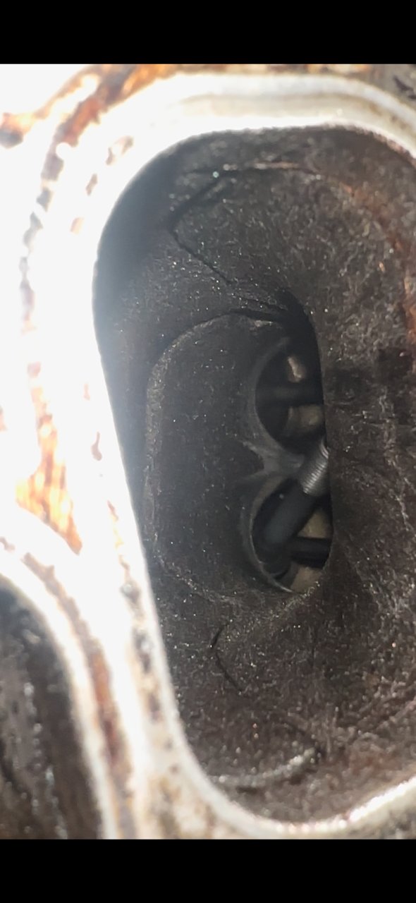

    One of your photos appears to be a bolt lying against a valve. This could bend the valve and destroy the piston. Also metal pieces from the cam phaser could be circulating through the engine.

    2006 toyota tundra sr5 access cab v6 4.0 automatic

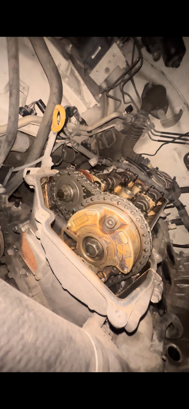

    Would that be a head bolt ? They all seem to be there doe. Could that possibly be the reason why my engine randomly turned off with the battery light on and doesnt crank only click ? The engine turned thoe when i bypassed the starter relay so kind of lost. Also what is that metal ring it was loose with another bearing type thing i havent gotten it out just yet. Also is it me or is the timing chain marking’s completely off ? Would I need to rebuild the whole engine ? How can i check for damaged pistons/valves ? Or can i possibly replace only the phaser/sprocket?
