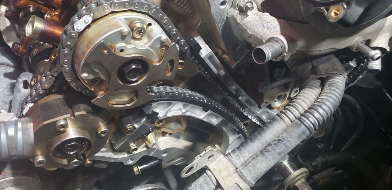

    Twintowers11
    Twintowers11 [OP] New Member
    Dec 22, 2020
    #56526
    29
    Phil
    2011 red tundra 5.7
  11. Dec 23, 2020 at 8:37 AM
    Twintowers11
    Dec 22, 2020
    #56526
    29
    Phil
    2011 red tundra 5.7
    Is there only one instance where all the timing marks and plates line up?

    Yes, when #1 is at TDC the camshaft chain timing link and crank pulley mark should align with the block / cylinder head marks, it will take several rotations to get them to align again. Does it sound like it's sputtering, or just cranking with no attempt at starting? Double-check your plugs and vacuum / fuel lines, there's a lot to remove to do this job and easy to overlook something during reassembly. Sounds like you verified fuel, to test spark, try pulling a plug, connect it to the plugged-in coil boot and see if it sparks against the valve cover. Do you have a compression test kit, or can you rent one? If the timing is off, your cylinder compression probably won't hold.

    ok...so that rules out that I got the timing wrong. Is there a way that I can verify that the cam position sensors are working?
