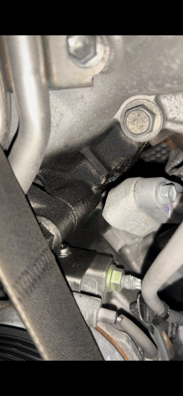

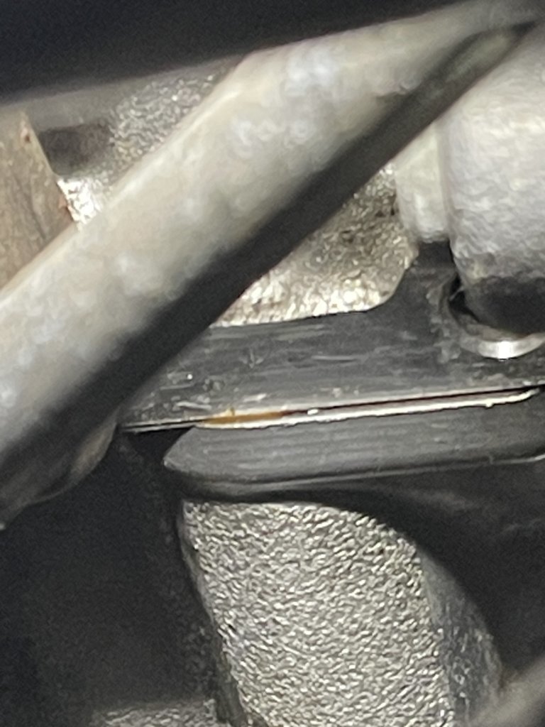

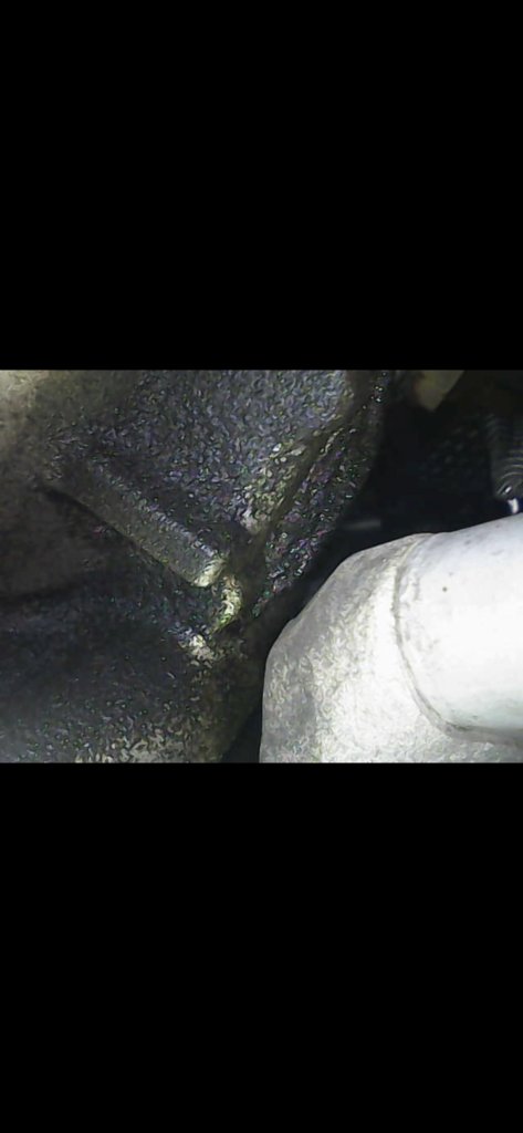

    2021 with 34k miles. Owned from new. I just recently saw some oil from the driver side area at what looks to be the timing chain cover. Is it worth trying to get a warranty fix or am I looking at more problems by them tearing into it and putting it back together than I would be leaving it alone. Since my first oil change where they overtightened the drain plug and leaked a quart of oil in my driveway with 8k miles on the truck I get nervous getting it wrenched on at the dealer.

    Tough call. That’s not a lot of oil on 34k. I’d Gunk it and wash off. Maybe snug the bolts? And see how fast it comes back.

    I hate the dealer as much as anyone - I’d take it in if you aren’t going to do it yourself.

    Are you using 5w-30 oil? If not, change oil, clean and watch. You might get lucky.

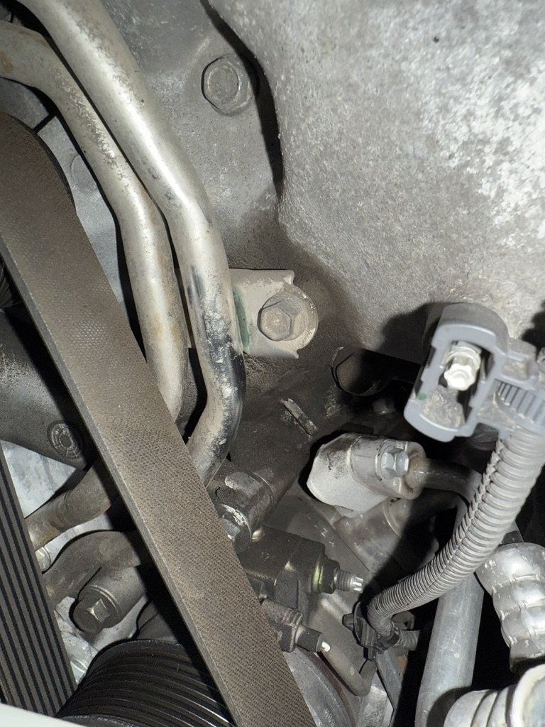

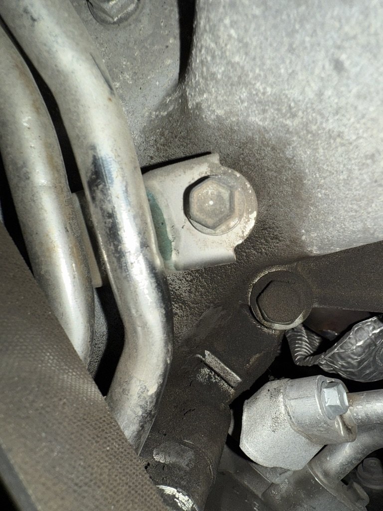

    Mine was leaking here and my dealer took care of it under warranty. No question asked. Try a different dealer. They maybe more willing to help. They confirmed it was a timing cover leak.

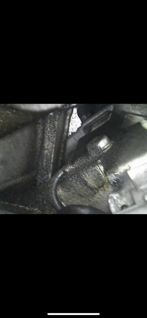

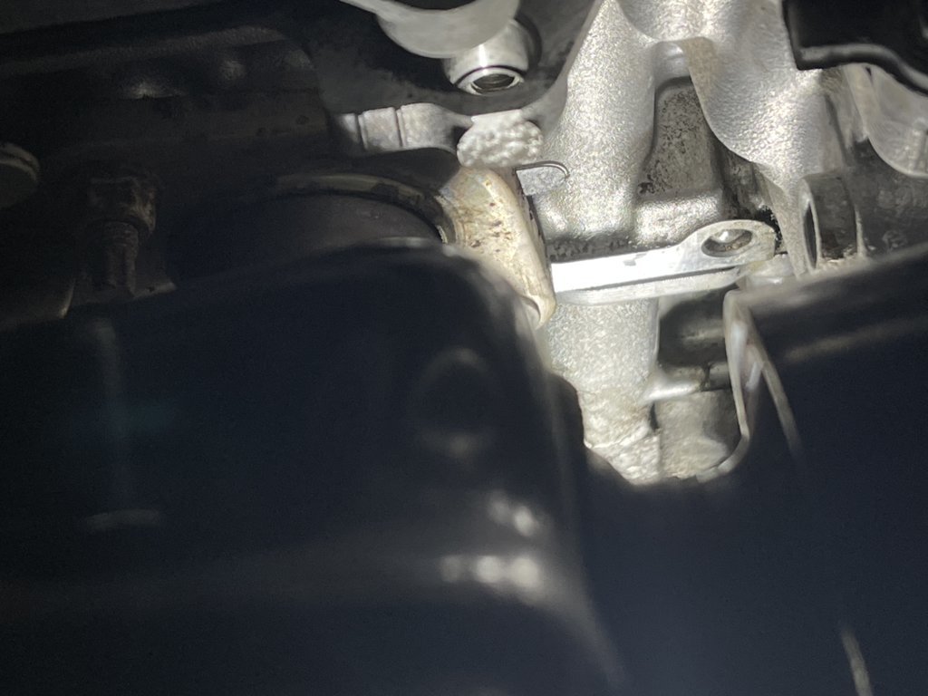

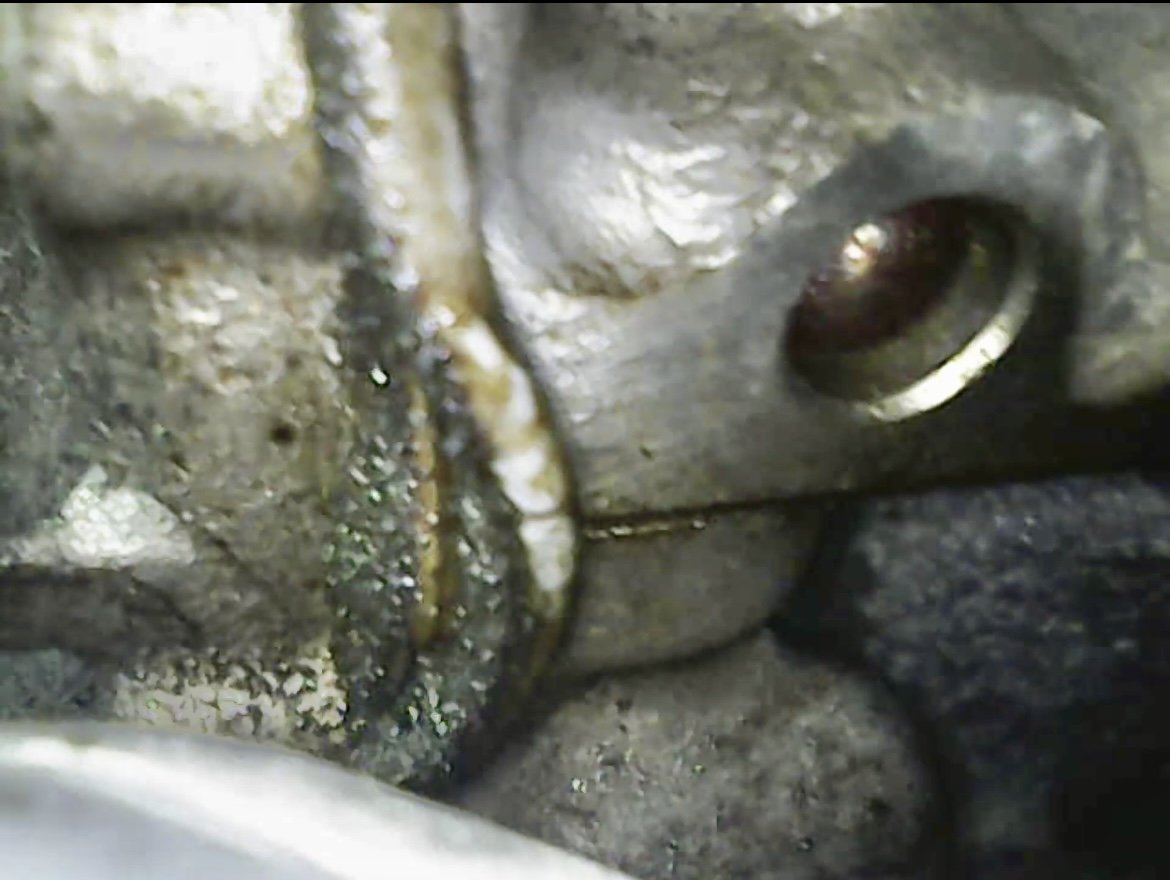

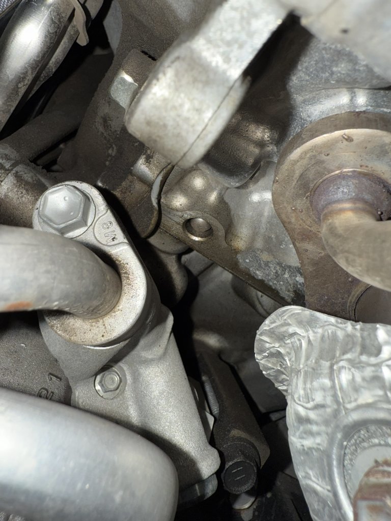

    I have the timing cover leak also according to the dealer. 2021 SR5 with 21.5k miles (I'm first owner). Took it to the dealer, and they said they submitted pictures to Toyota who denied fixing it under warranty because it was "normal seepage". They won't cover it unless it's got visible liquid buildup. My powertrain warranty is up in November, so that's extra convenient for Toyota. The dealer said to take it back to them at the end of the summer and they'll see if it's to the point where Toyota will cover it. They told me it's a $3500-$4000 job if I'm out of warranty (seems like a rip off - I won't be using the dealer after warranty). I'm going to contact Toyota and see what they tell me.
    It looks to me like the "gasket" is oozing out of the engine significantly in the last picture below. You can also see that the gunk goes all the way up the engine along the belt path. That seems a bit odd to me that it would work its way all the way up there without dripping at the source. So maybe the dealer is BS'ing me and just doesn't want to do the job. I took the last picture after the dealer visit. They didn't clean it and recommended that I don't so that it can continue to build up before I bring it back in there. I think that cleaning it could allow me to see liquid forming better. I may try another dealer.
    I won't fix it for a while if it won't be covered under warranty, but I plan to keep this truck for a long time so I'm sure I'll have to fix it eventually once it's bad enough to drip oil on the ground.
    My 2004 Tundra had 3 rear main seals replaced under warranty, and then the leak came back at about 100k and kept getting worse. My Toyota luck is bad I guess, so this will be my last.

    Below is what my service slip says. Seepage is "normal" - I can't say that I agree.
    INSPECTED AND FOUND NORMAL SEEPAGE FROM FRONT OF ENGINE ON DRIVERS SIDE. NO REPAIR RECOMMENDED AT THIS TIME.
