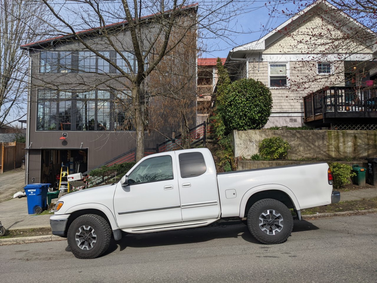

    Heh. Our trucks are twins from another year, and close to same mileage, and definitely about the same paint condition.
    Check the link in my signature for what you can do with a little time and the right tools. Paint is single stage, just needs a good polish to cut that oxidation off the top.

    And yes, once the weather gets nice there's a fair bit of polishing and waxing in my future! The paint is in solid shape, just very oxidized. Should look great with a bit of work.
