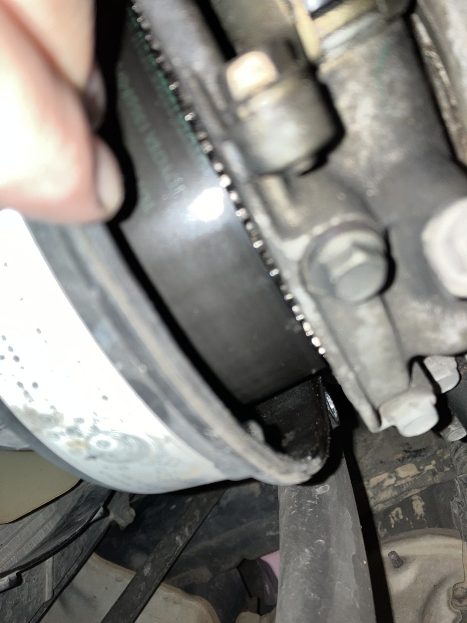

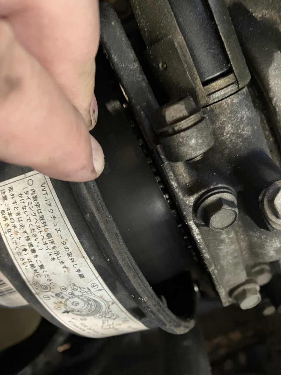

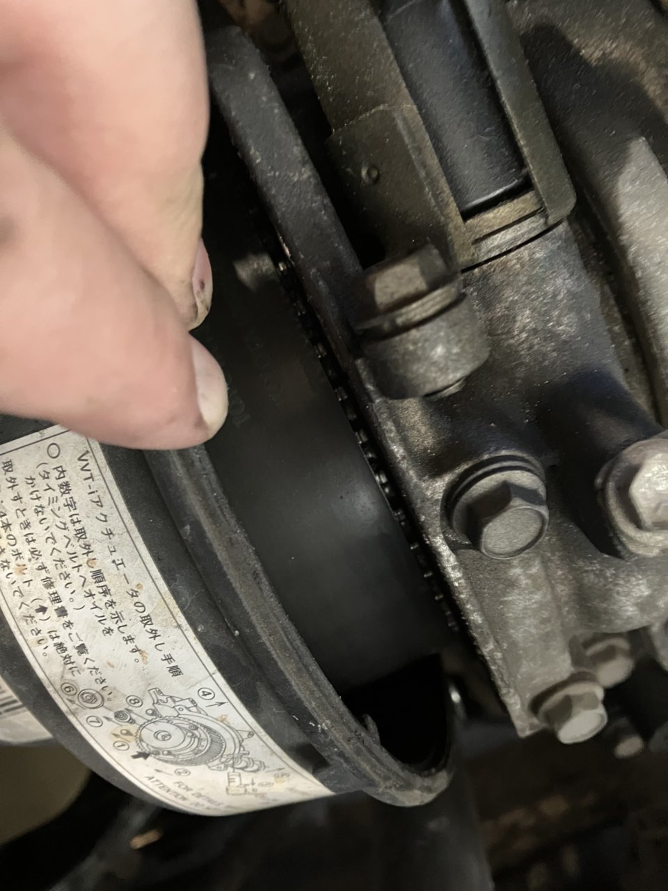

    I just bought a very nice 232000 mile 2006 doublecab. No service history. Looked at the timing belt today and I think it looks fairly recent. Can any of you guys take a look and tell me if you agree?8C846D25-70B1-41B5-9281-66D0AF2BAFD6.jpgB29B6071-301D-4AA4-9E3E-F61337E31109.jpgEA449EF3-239F-462B-AC0F-CB500FC3A79C.jpg

    I really don't think you'll be able to tell if it needs replacement from just looking at the outside of the belt, you need to see the cog side to check for wear and cracks. If you have no history it might be a good idea to just replace it for peace of mind. Good luck.

    It's hard to tell on my phone, but it appears the belt is starting to show tiger striping, and the words on the belt appear illegible.
    I'd say you've got another 20K in that belt before it absolutely needs to be changed. It's not as bad as my belt was at 280k.
    Personally, I'd plan on changing it sooner rather than later just to be cautious, but it's your truck so do you

    First, there's no way that's the original belt. So it's obviously been changed at some point.
    Second, that belt visually doesn't look like it's more than 4-5 years old, but it's purely speculation. If it was my truck, I'd feel pretty confident driving on that but I'd make checking it yearly a point.
    When you say 'No service history', did you also sign up for the Toyota Owners website, plug in your VIN to assign your truck to your account, and look at the dealer service records? Toyota keeps a record of all dealership-based maintenance visits.

    And the reason I tell you to look for dealership records at Toyota's site, I clearly see "TOYOTA" on the belt in one of those pics. And it's in the standard Toyota font, so I have my suspicions the timing belt may've been changed at the dealer, because most shops aren't going out of their way to buy belts from a dealership.
    It's Japanese writing.

    I wouldn't change that unless I needed to work on something else in that area. If it would make you feel better to inspect the lug side of the belt, you can get a cheap endoscope on Amazon and take another look.
    Agreed. I see "TOYOTA" most clearly on the first picture with the flash, in green just above the glare:

    The fact it says “Toyota” on it only makes me think it could still be the original. If my sleuthing could not definitively uncover the last timing belt change, it would be on my immediate to do list. When I bought my daughters SUV from the dealership that originally sold and serviced the car, it was sold with a “131 point inspection”. It was one owner with 113k miles on it. During my initial shakedown of the vehicle and its maintenance needs I discovered the air filter was in fact the original from the factory. Date stamped the same as the vehicle build date. Assume nothing.

    That's pretty nuts right there. But yeah, if there's no record of timing belt service at the Owners website, and it's still rocking a Toyota belt, I'd be suspicious af. And that would be the nicest looking 17yo, 230k mile belt I've ever seen. We've had others post their 200k+ mile original belts on their truck and they were cracked to hell.

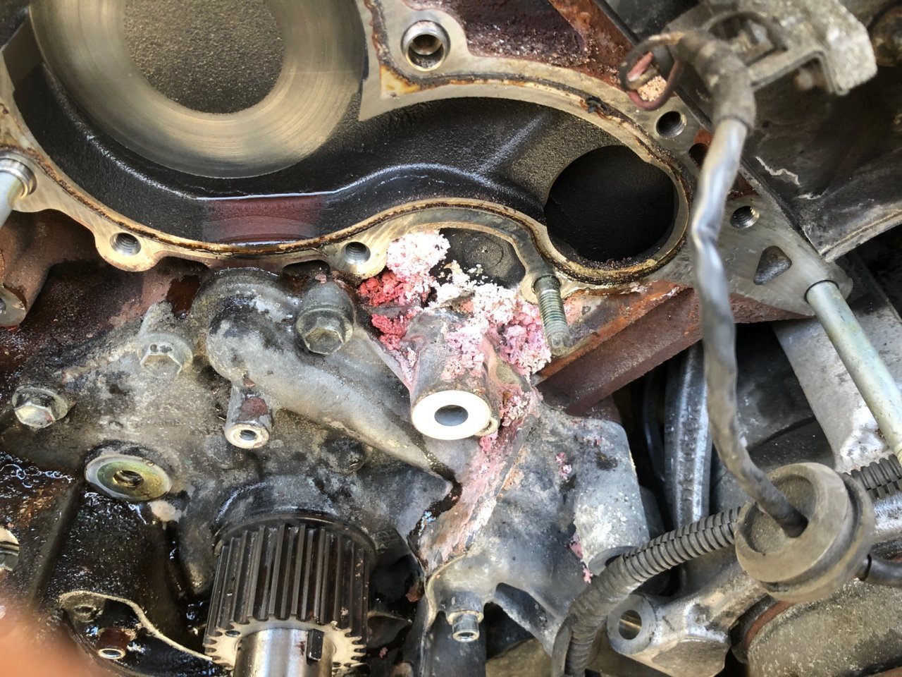

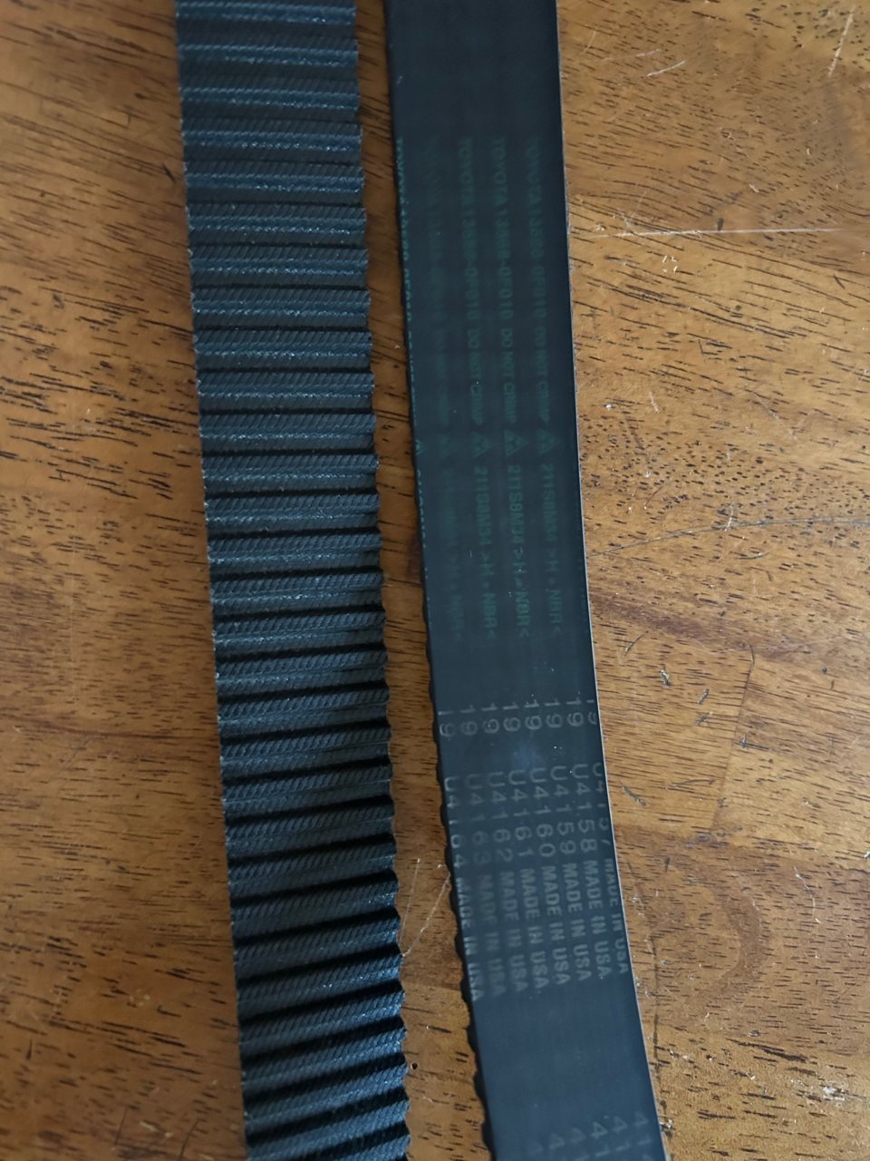

    I was in the same boat when I got my truck at 228,000 mi. No record or evidence of any timing belt service. Out of an abundance of caution I changed it. This is what I took off. I'm 99.99% sure this is the original belt.
    If I hadn't done so, I never would have noticed the water pump leak(s).
