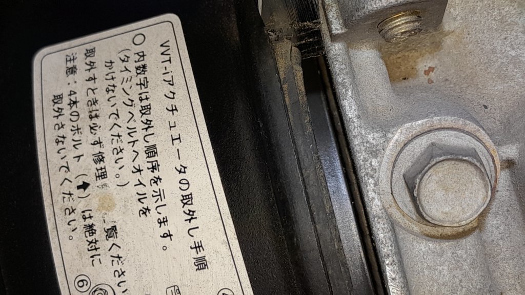

    My timing belt was changed 12 years ago, but only has 10k miles on it (yes, needs to drive more lol!). The interval is 9 years for time so it's overdue, but obviously way short on mileage. I inspected the belt by opening the driver side cover slightly, and it looks like new from what I can tell. What would you do?
    I got a quote from my local dealer of $2600 for the belt, water pump, idler, pullies (radiator was another $1k, WTF !). Which seems crazy to me so I'm not exactly eager to change if not necessary. It seems to me that it's not so much the actual belt breaking that gets people to do that job, but more the water pump, idlers etc start acting up. I wonder if those parts actually get affected by the age (over mileage), or if it's only the belt that's prone to time wear?
    To those that changed their belts early due to age, did you see any cracking/wear etc on the belt at that time? Has anyone's belt ever actually snapped (or even had water pump, idler issues) on time alone? And what mileage did you have on the belt at that time? Seems like if the belt was getting old and risking breakage due to age, it would actually have some sort of evidence of that by cracking etc? I realize it can have internal/unseen stress but I would think the belt would show some sort of fraying/cracks etc first? And if the damage can be unseen/internal, what's the point of even inspecting the belt through the cover? I know this is ultimately my decision to make, just checking what the consensus is from everyone since it's SO low of miles.

    Specialty shop that only does Toyotas but isn't a stealership will probably cost you $1k less than the stealership is quoting, possibly more. Even the most expensive specialty shop near me (LexTechs) only wanted $2,200 (or maybe 2.3k, I forget) to do the same work.
    I can't see enough of the belt to comment. You can loosen the cover enough to expose the whole belt, at at least 2/3 of it. What I'm seeing isn't enough. But given that's the one thing that will brick your engine, and things leaking (coolant/oil) onto the belt behind the covers will kill a belt in no time flat, and under-driven vehicles tend to have gaskets and rubber dry up and cause leaks ... I'm not sure I would personally chance it. But I'm sure it also looks like I'm often trying to spend other people's money on here... :rofl:

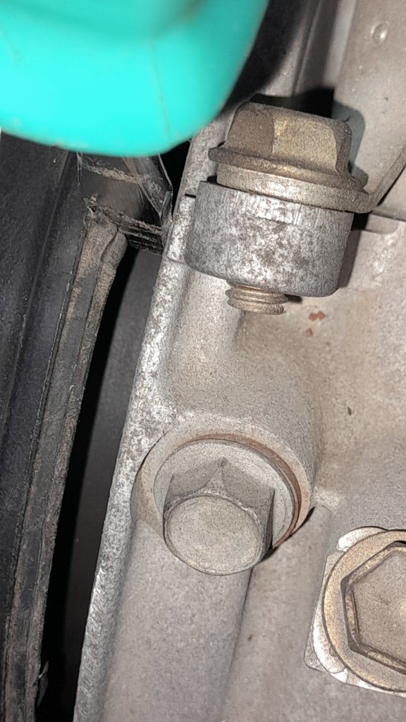

    Thanks all for the replies. I wasn't sure how far to try and separate the cover with the bottom bolt in still, seemed like it didn't want to go much more.
    I do live in a hot dry area so I'll factor that in even more. Plus there was a period were it was only getting driven once a month or so, I guess that's even worse if the belt was flexed over a pulley etc and in that position in the heat for weeks on end.
    I'm glad to see the resounding "change it" so at least I'm not tempted to be on the fence about it. My local Toyota only independent place is actually a step up in price from the stealership! Other indy toyota shop was $1600 all in but I didn't get a good vibe. I think I'll keep shopping around, but get ready for that bill anyways.

    I was planning to do the belt, but what I saw of it, seemed like in great condition. I realize that even if I get another year from it, I'll still be getting it done either way (just more risk). I think I'm just going to call it par for the course with an interference engine and do it soon. Now to get a realistic price for the job. Thanks all!
