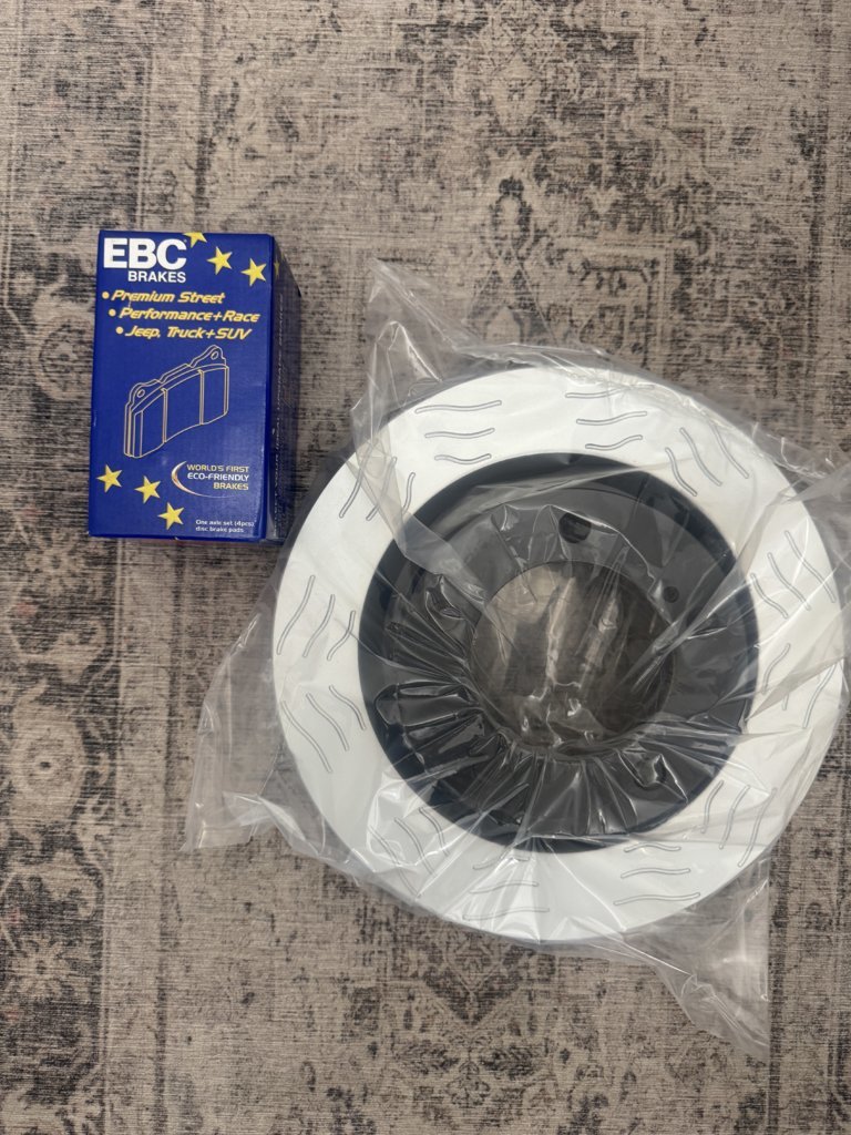

    I just ordered NAPA performance rotors and EBC extra duty truck pads… I’ll keep you updated.
