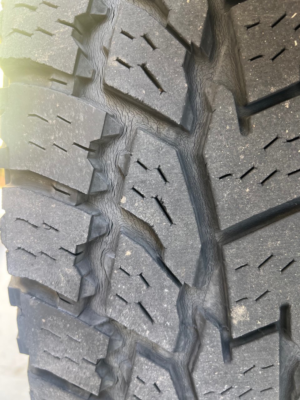

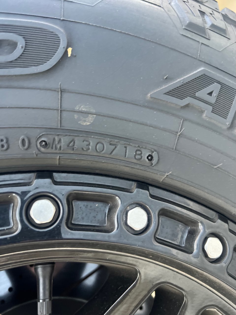

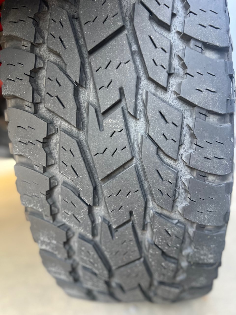

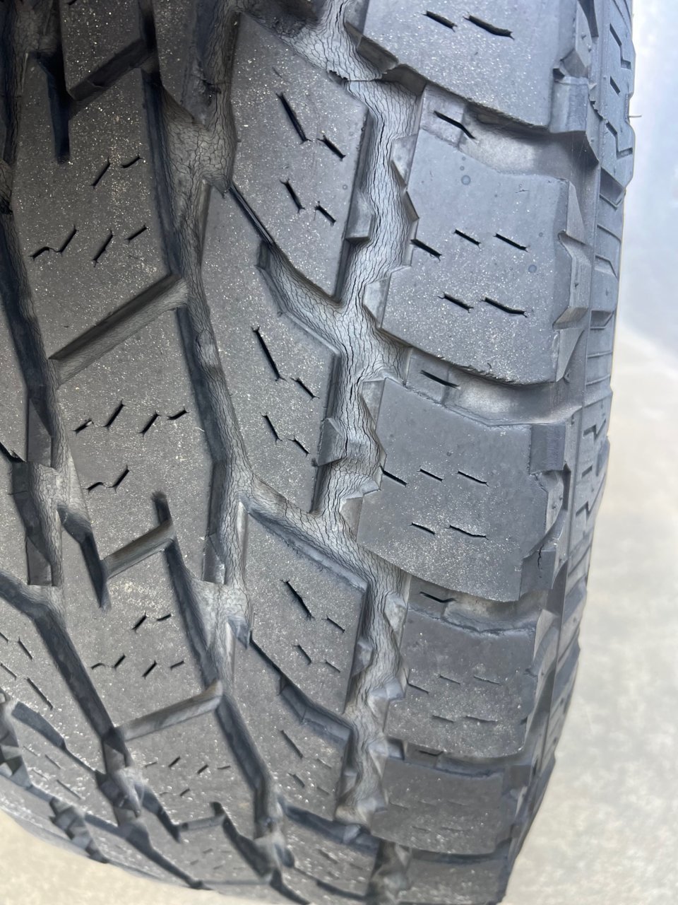

    These Toyo Open Country AT II are about 5 years old. I've noticed cracking in between the treads on all 4 tires. The Google box says it's dangerous but two local tire shops say they still have some life left.
    I'm considering replacing them because I have a family now and I drive my Tundra on the Highway, I'm concerned about a blow out.
    Should I replace them ASAP or do I have a little time left?

    Should be ok. Slow down during wet roads and keep them balance. Wobbly steering will wear down all your bushing fast. Only you know how the truck handles.

    That isn’t the DOT date unless Toyo does it differently than everyone else. It should say DOT and a 4 digit code. I would say it depends on how you use the truck if they should be replaced or not. Towing, heavy loads, Daily driven or used for trips, I’d replace them. If it’s a weekend ride for trash runs I’d keep them for a while longer.

    The sidewalls look okay, being of the frugal persuasion, I'd run them but keep the speed down, I do that anyway, it makes the drive less stressful on SoCal roads for me.

    Tough call but I agree that's not the date.
    The date code is typically a 4 digit format. My tires have 3318 stamped on them so they were made in the 33rd week of 2018.
    That cracking is getting pretty bad but you probably have some time left before you have anything severe happen. Around town I would think they are perfectly safe. I probably wouldn't drive 80 with the kids in the vehicle.

    Toyo's Date Code https://www.toyotires.com/tires-101/reading-a-sidewall
    Scroll toward the bottom. I'll look for the warranty on their website but it looks like I'm 2 months past the 5 year mark (0718).

    I stand corrected :hattip:.

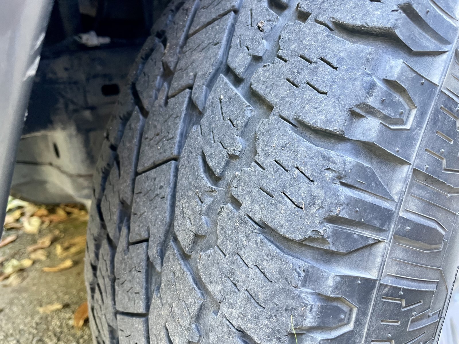

    Well first and foremost I am not a tire expert but in 40+ years of dealing with tires on my personal vehicles, I have seen what you are showing with your tires and I personally don’t view that as cracks or should I say dangerous cracks. If it makes you sleep better at night when thinking about your family, by all means get new ones ASAP. Sleepless nights and family safety is priceless.
    This is my Toyo’s after 2 yrs/~10K miles….

    I've driven on tires of an age more than I care to admit. My 2 cents dry rot starts leaking air long before a blowout.

    My 3 year old Toyo AT3s look just like the OP’s tread. I wasn’t concerned about it at all until these responses.

    I went to Allen Tire Co today and asked them. The guy said that it's normal for a 5 year old time. He said to replace them at the 7 year mark.

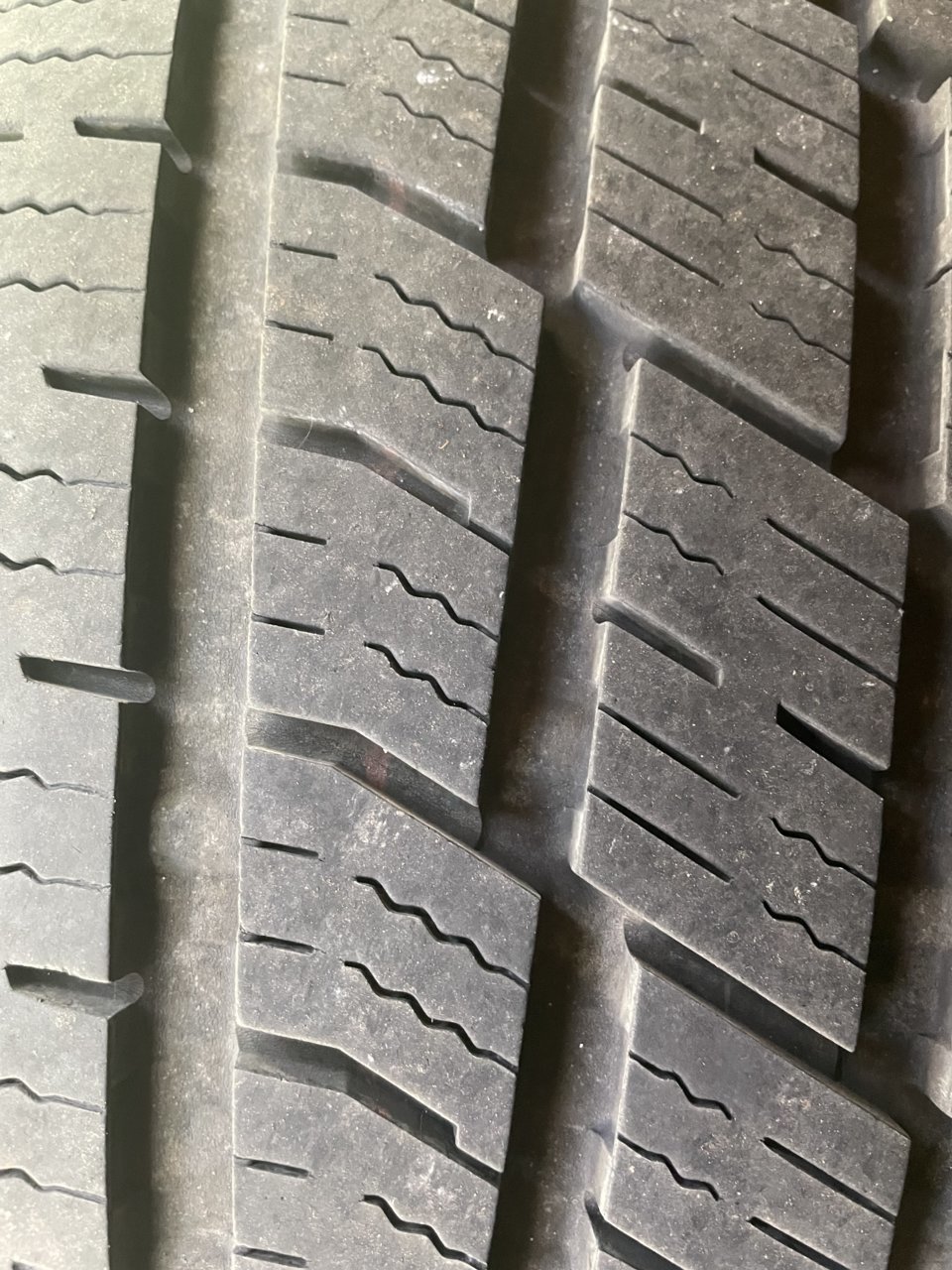

    Are you guys silly, I’m at 113,600 on my AT II’s.
    This is at 108k.
    285/70r17 E
