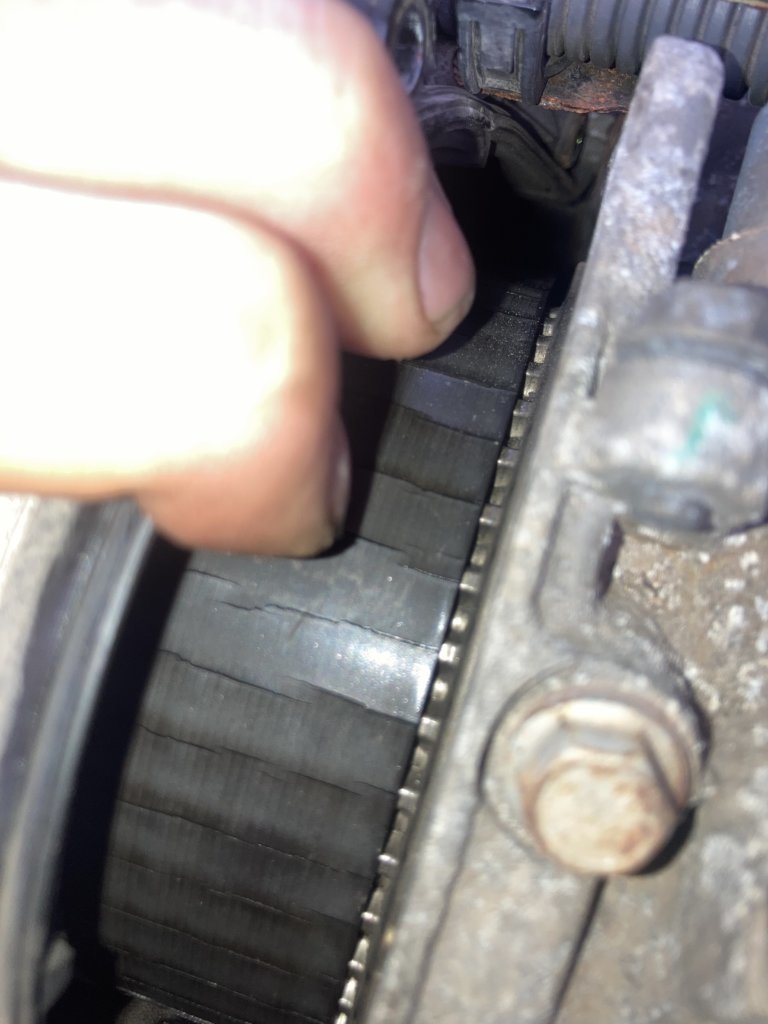

    Timing belt on my new to me 2006 tundra double cab 4.7 pictured below, I bought the truck knowing that it would probably need it and was going to schedule it for a month out or so but I’m guessing this is probably a don’t drive unless you have to scenario?
    Truck has 195k and I think this might be the original.

    Your instincts are probably correct, that's pretty bad. Not worth the risk driving it if you don't have to IMO.

    I would try not to even start it if you can avoid it.

    One crank away from a new engine lol.

    Hey, if you like playing dice with death, go ahead, start it up. Holy shit man. That's one of the worst I've seen.

    That is pretty worn. You should replace that as soon as possible.
    I've seen some pictures of bad ones, that might be the worst.

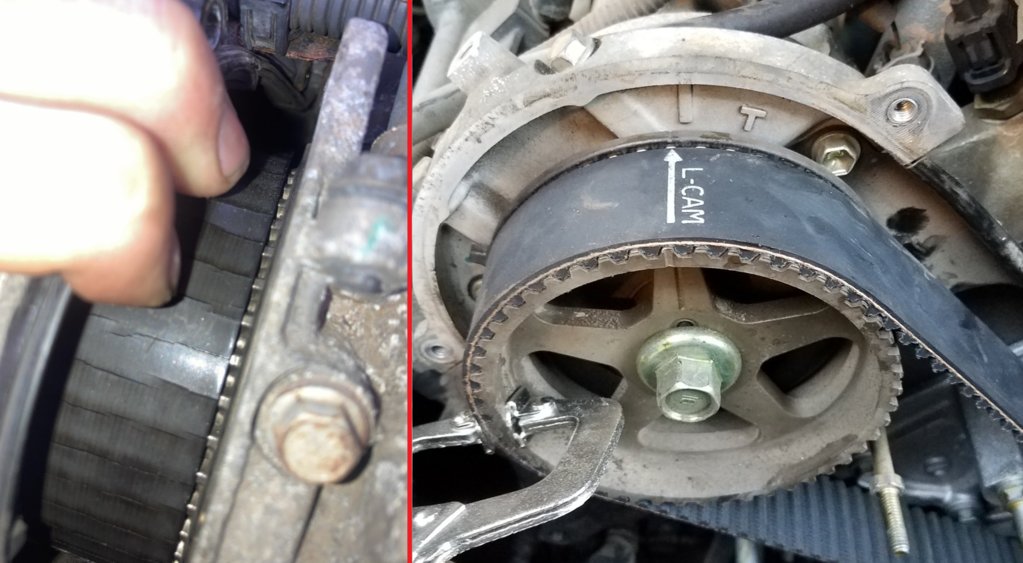

    How do you assess the condition of a timing belt? You say it's the worse you've seen, what's a good one look like and what are the differences? To my untrained eye it looks like...a belt

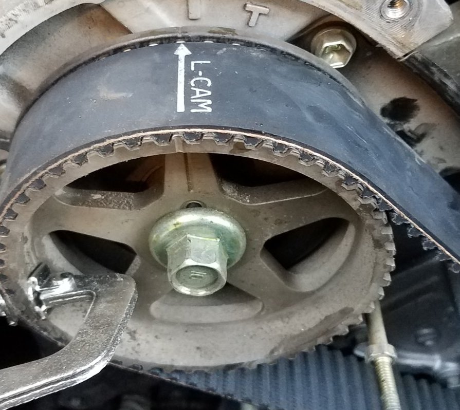

    Belt should be smooth and crack-free/wrinkle-free, but not overly shiny. It should have writing intact on it at various points on the belt for Left/Right/cam, and the text should be reasonably legible. If either is untrue, or the belt is frayed at the edges, replace the belt with genuine Aisin brand kit, but don't buy it off fleabay/scAmazon or any other store that can't legitimately validate its supply chain and/or won't be held accountable if you buy a counterfeit part.
    Bad on left. Those cracks are not normal, neither is the sheen. Fresh new belt on right.

    Forum has been changed recently to reduce picture quality pretty significantly (or I hit a limit, not sure which), so here's a closer pic of good belt.

    When I was a Tech many moons ago, the rule of thumb was to change them when they started to crack on the inside between the cogs. Seeing cracks on the outside should be a flashing neon sign that its way overdue.
