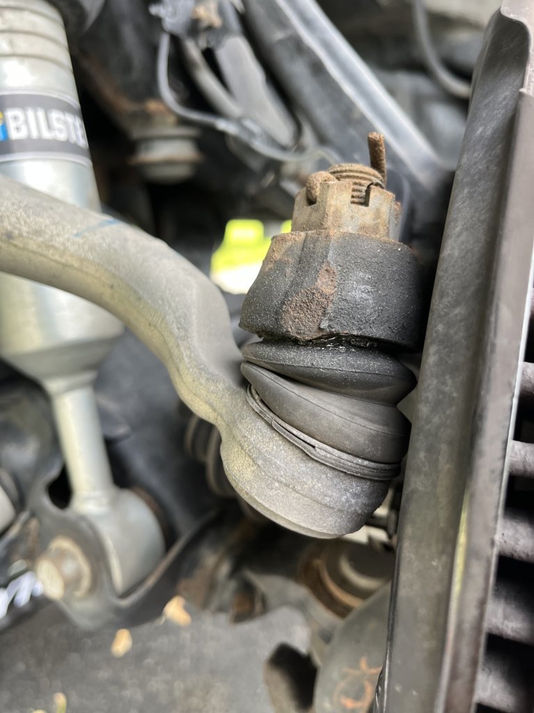

    My driver wheel has back and forth movement (3 & 6 o’clock) hand position. Can’t figure out what it is. Lower ball joint boot has a bit of grease coming out the bottom. No tears. Zero up and down movement. I think it’s fine. I attached a video of the movement. The clunking sound is the steering column moving and hitting its “limit” (when the truck is off). I checked all the suspension bolts. Also attached a photo of the tie-rod. Very tiny bit of grease seeping from that joint. No clue if that would make that movement. It all seems tight. 48k on the truck. 3” bilstein lift. Any input is greatly appreciated. Drives fine, no sounds at all.

    from the video, it looks like wheel bearing, but with that much movement it should be obvious; the lower ball joint appears sloppy too
    lower ball joint looks ok, just translating movement from the knuckle. Looks like outer tie rod end is moving a little less than the knuckle. That’s probably the problem

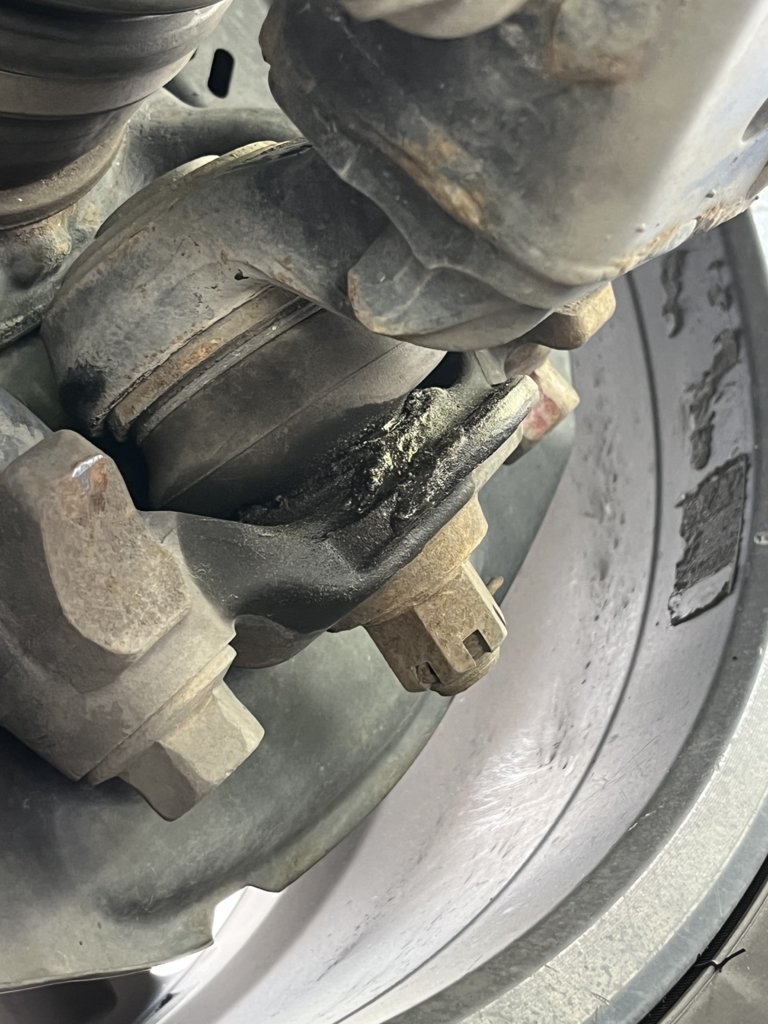

    Yea I’m hoping it is just the tie-rod. Lower ball joint looks like this. Wiped the grease away and found no rips. But zero up and down movement or noise. Steering feels fine. No clunks or noises.
